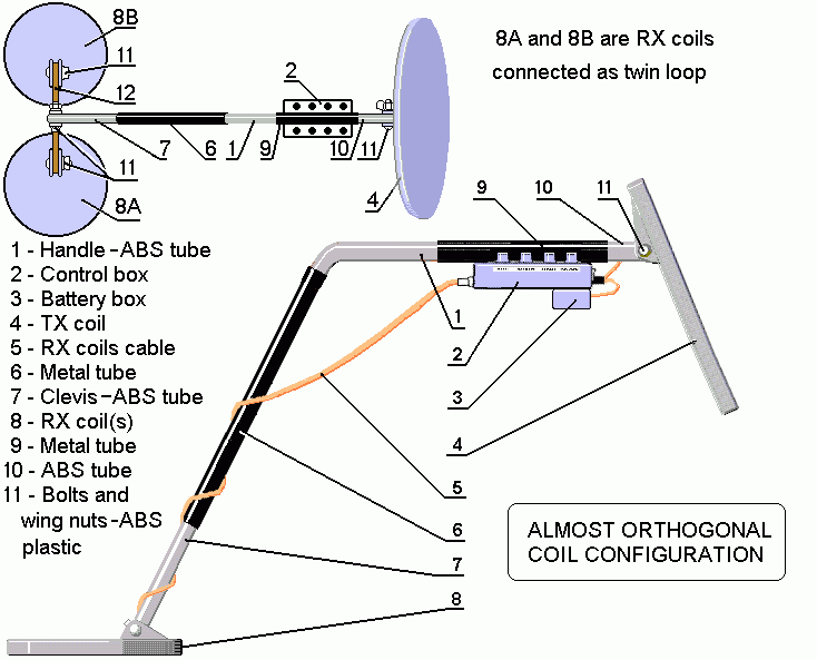

                    The following explanation is written for Mr Jim Peterson, who believes that a coil configuration 2BOX can locate meteorite crash site at a depth of 1.5 meters.
                    A metal detector for meteorites should be very sensitive to two types of target:
                    1. "Hot rocks" because most meteorites are ferromagnetic.
                    2. Caves because there are meteorites that do not generate a signal at air test. When driven into the soil, they generate a signal as from the cavity, because they lack conductivity and cause local changes of GND signal. Jewelers buy these meteorites a very high price, so it pays to develop a metal detector, which creates a strong GND signal.
                    I tried searching for meteorites with Tesoro - Lobo because it works on two - three times higher TX frequency than conventional metal detectors and better and can suppress the third harmonic of mains frequency. However experiments showed that TX frequency must be higher than 20kHz to create more powerful GND signal from dry soil. Further, the soil acts as a core for TX coil, causing parasitic modulation of TX. To avoid this, I placed TX coil away from the earth as shown in the attached drawing.
                    As for the PI, to create a strong GND signal is needed fast TX circuit placed inside search head. Superscan was not suitable for this.
                    In general, larger meteorites have hammered deeper in the dust if they have fallen long ago. Little meteorites have driven shallow. Often, a recently fallen meteorite is not covered with earth and is visible in the bottom of his crater.
                    Since 2BOX can not detect small meteorites, and it is difficult pinpointing, I made TWIN LOOP RX coil as shown below. This configuration proved to be very sensitive at air test. I could not do field test with sowed twin loop RX coil because my friends were quick to take the Tesoro - Lobo and Suprscan in Ukraine and Russia to search for gold nuggets. From there I was informed that they have realized our idea to improve RX of Lobo:
                    a) its input to act as a low noise narrow band preamp and
                    b) to use the carrier recovery block instead wire connection with TX.
                    I managed to master TX circuit suppressing amplitude modulation to enable the TX coil to move close to the ground as in the original design of the CEIA. I hope they have seen my TX circuits in this forum and they have improved TX of Lobo.
                    [I will post the drawing later because I can not find it]

                          Here is the drawing for "almost orthogonal" coil configuration.
                            Thanks mikebg.
                            How your "twin loop" RX coil are connected: in parallel or serial, in-phase or in anti-phase?
