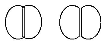

field experts, which DD design is better
  • field experts, which DD design is better
    and why there isnt some kind of EM-shortcut
    if the coils crosses each other?

      The one on the right side won't induction balance.
        Hi as Carl says the coils have to cross to get induction balance it is by varying the distance apart of the crossed loop that you achieve induction balance.
        Regards, Ian.
          Sorry Funfinder, I thought it was a trick question, but here are my 2 cents. Each coil has magnetic field inside going one way, say +, and outside field is going the other way, say -. While inside field is nicely concentrated, the outside field is dispersed. Encompassing the inside field is easy, while encompassing the outer field requires looooots of space. A balance is achieved when a larger portion of a Rx loop that is outside the Tx loop encompasses the same amount of field as the portion inside. In practice it is ~10% area.
          Because coils are electrically insulated, and the magnetic portion is in antiseries, there is no EM shortcut but a nice balance.
            A simple way to understand the DD arrangement is to make one and play with it. Just slap together a pair of 6cm diameter circular coils, about 100 turns each. Feed 5KHz into one of them from a sig-gen, look at the output from the other on a scope, and move them around relative to each other.
