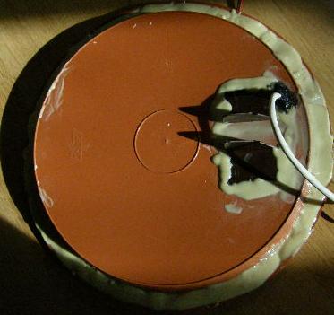

        There are different way how to finishing coil.
        Here one example. As for PI coil prototype I use often as coil basis very cheap flower pot saucers. I put windings in a saucer flap and potted with epoxy. Ears can be made from L plastic profile and glued with epoxy on coil too. Finally you can use desired non-metallic colour spray on it.:

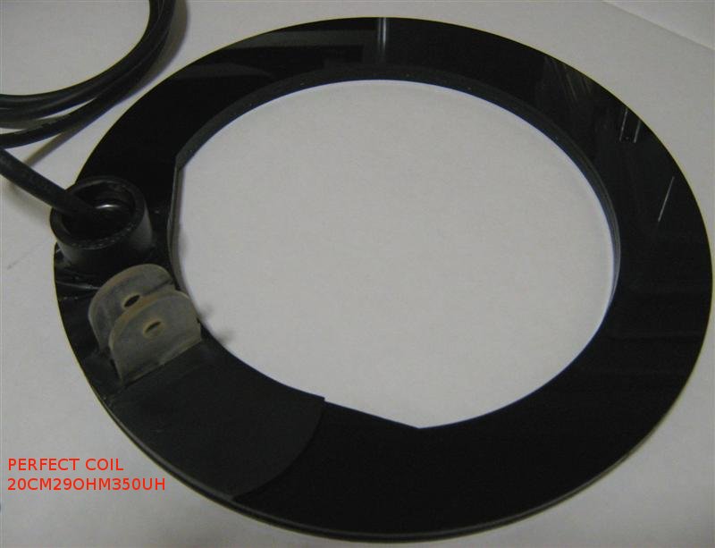

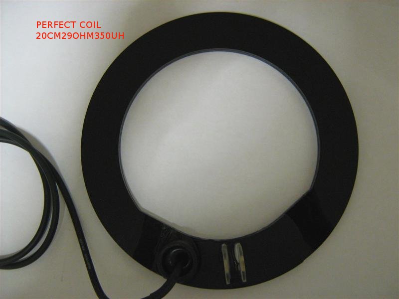

                      This is my latest design.
                      Layered acrylic, epoxy and polycarbonate.
                      It will work with your PI.
                      And very well, if I do say so myself.
                      Has shielding, the wire is dual core shielded.
                        How much Tec ?
                          To sell ? $59
                          To make,
                          The laser cutter charges tooling cost,
                          Then fairly cheap to cut out the acrylic parts:
                          $9 per complete coil set.
                          Used 'Draft sight' free drawing program to draw up the shapes.

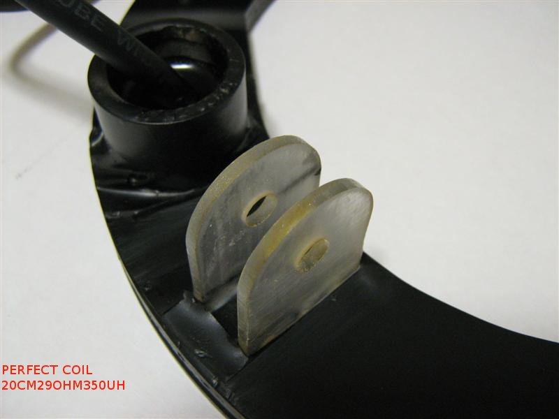

                          The mounts are polycarbonate they are $6 for the pair (too much).
                          Glued with acrylic glue,
                          filled with epoxy.
                          The shielding is slotted foil.
