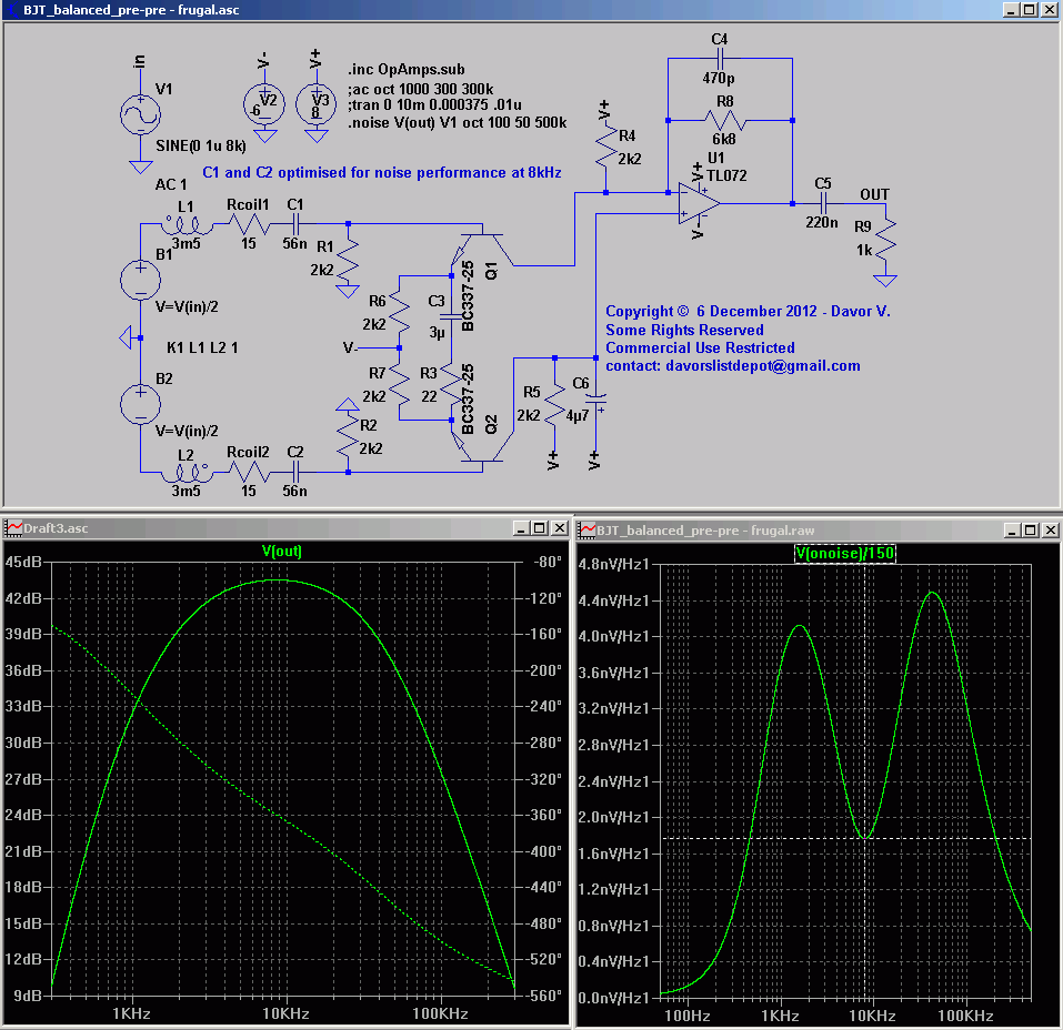

            I have yet another candidate for a balanced preamp, a frugal version. The worst of the parameters is CMMR, and it is ~40dB, but it does not depend upon the resistors accuracy, so I guess it is just fine. Decoupling is not shown. It (ab)uses the fact that the impedance at the inverting input of the op amp is ~0. The gain is determined with R3 and R8 and somewhat with the transistors current. I placed a capacitor in series with R3, mainly because I don't want to pick selected matched pairs of transistors - unmatched transistors same type will be just fine.
            I think I'll go with this one. With real world BC337 (that are modelled with too high Rbb in LTspice) i expect input referenced noise to be ~1.5nV/sqrt(Hz). Not bad for 2 euro of material. I think this will go into my IGSL. I like frugal builds.
              Good job Davor. I like it.
              I think, it's becoming a very nice Nikolaus gift.
              Cheers,
              Aziz
              PS: Temperature drift could be an issue however.

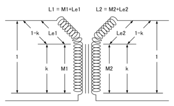

                      Looking at the leaky transformer model at wikipedia, https://en.wikipedia.org/wiki/Leakage_inductance you are faced with a scary picture:
                      It shows leakage inductances as two separate entities and hints a design nightmare. In reality it is not so. A much more likeable model was given by December 2002 issue of Practical Wireless:

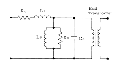

                      It truncates all the nasty bits to one side, and it suddenly looks much better. Adding a search coil to the primary will require something to be done about compensating the leakage inductance L1, but the rest of it should be just fine. A series capacitor should do.
                      Lp is the inductance of the primary and it is very large by definition. In pulse transformers it is usually set to at least 3 times the impedance, but here it is much more.
                      Rp represents the losses in the core, and it is of lesser importance for Rx purposes.
                      Secondary leakage is of no consequence, and losses are truncated to primary, so the model is just fine.
                      The most critical in power transformers design is the lower usable frequency. At any significant powers the core is near saturation. Surprisingly the higher frequencies are not losing in efficiency, but the power transformers are losing some power transfer capacity - the core is not running near saturation. It is of no consequence with Rx or mic impedance matching transformers, as the power transfer is negligible.
                      At much higher frequencies the losses and leakage inductance become problematic. How much so I'll have to find out. I'll let you know.
                      Otherwise, the transformer is an ideal balun, and impedance matching provides for low noise operation at low input impedances.
