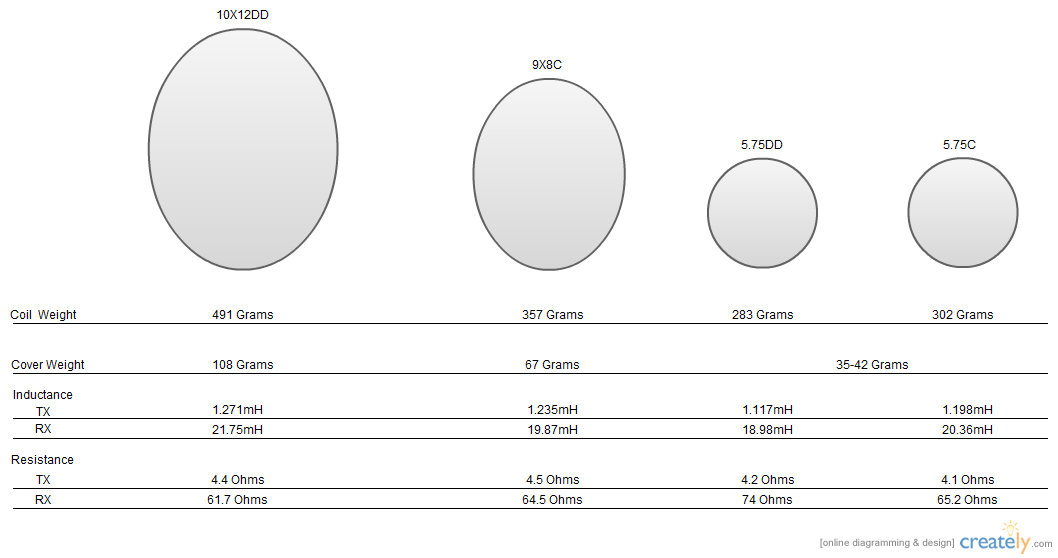

              I found a decent free program to display data. All the ones that I could find with actual data tables cost money.
              I thought that this approach is logical and easy to understand.
              More data coming soon.
              If you have any of these coils, and can add to the data, please do! Ranges are great!

                    Hi Hector this is good stuff.
                    Be mindul that if the Tx cap is in the coil head then you must measure inductance of the L well below resonance. Some fancy bridges let you pick the frequency used in the measurement. 1kHz is a good choice on HP digital bridges for example.
                    S
