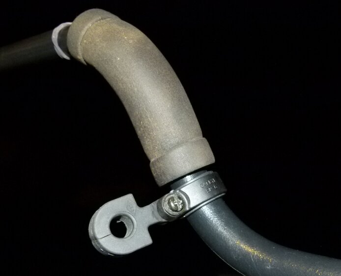

    Depending on the shape of the detectors handle
    or grip a coil cable distancer could be very useful.
    Otherwise the cable could get touched by fingers or
    hand instead of remaining in a notmoving, safe position.

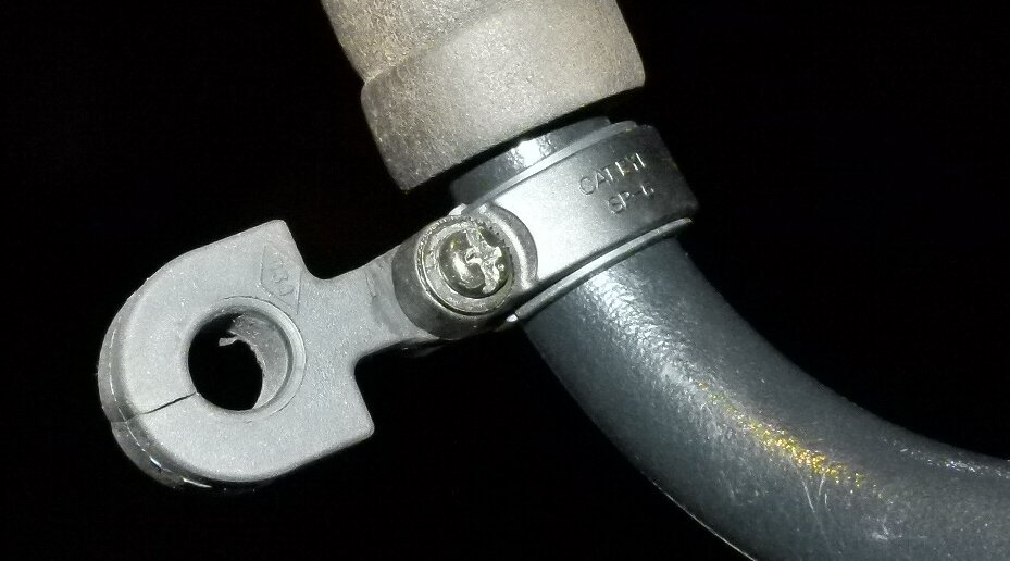

    For the Blisstool I have used one of those bike-lamp-holders
    in combination with a special part fully made out of rubber-gum.
    It contains a small fissure for simple plugin in or removing the cable.

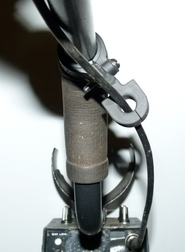

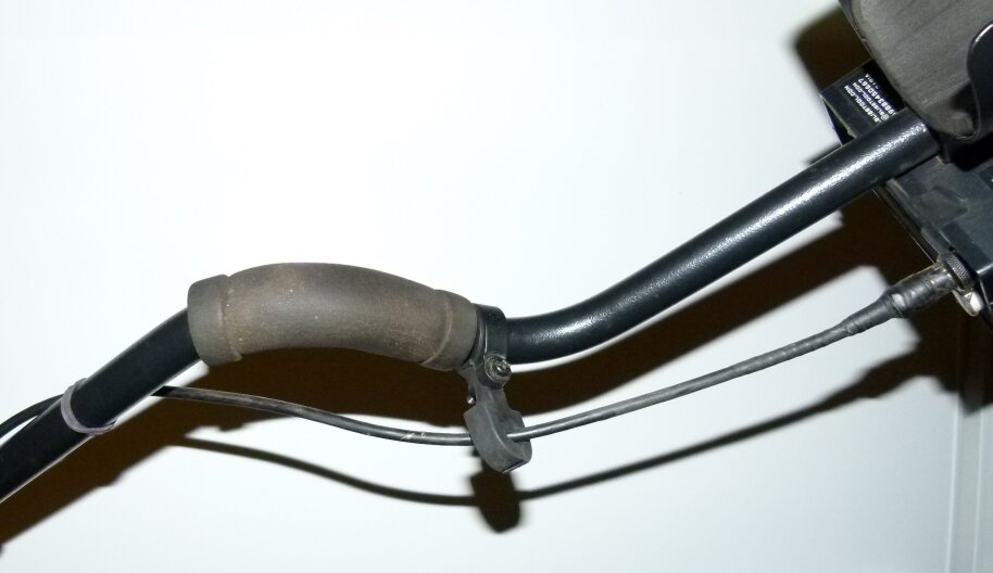

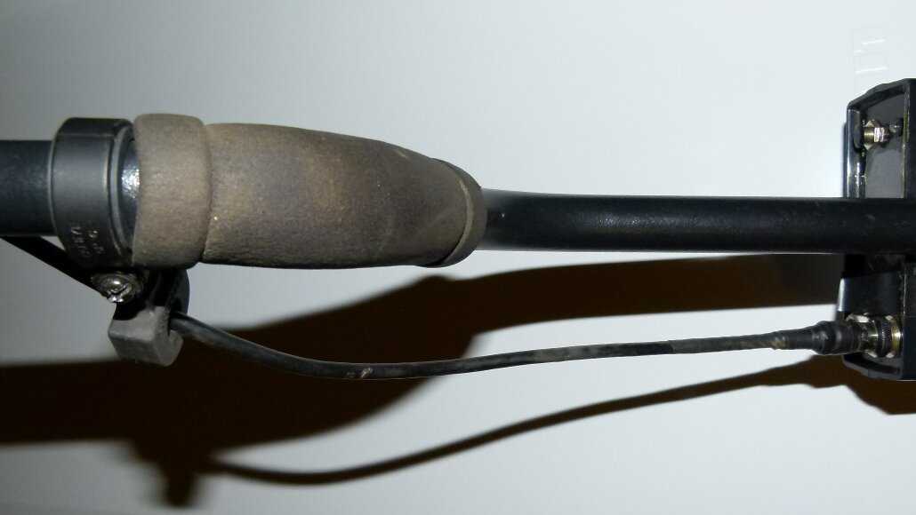

    After some hours of real testing I found out that the position of the distancer
    is improvable. Because this cable has some tension and after a short time it
    starts to touch the upper side of the hand. But not with the new position!
    Important: It's the best to wind the cable from the coil directly beginning
    over the stem (from where the cable is attached at the coil it looks like
    a bridge until it touches the stem on the opposite; This is the better
    method anyway cause the coil cable directly goes better upwards)
    The angle is 45° and the min. distance pole<->cable 3.5cm (1.5'').
