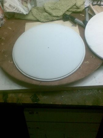

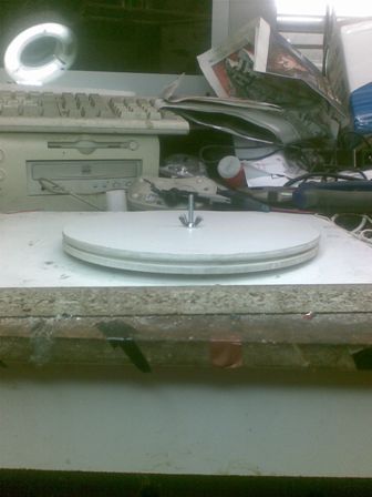

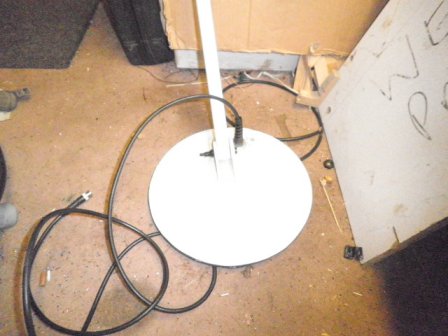

              Hi made this one its all made out of styreen, easy peezy.. light, easy to cut, durable, cheap as soggy chips.
              All you need is compass, fret saw, common sense and a drill.
              This was a copy of the Barracuda.
              Cut the three disks the 1 off small thickness as required in the centre cement glue surfaces clamp till dry, then wind hes your uncle and fanny is your aunt finshed
              3 parts 2 x 8" outers and 7.5" inner and wire as spec required.
              If you really want to get sexy with it to look more moden and a tad lighter cut a nice size hole out the center.
              Just realized the first two were the copy of the original Barracuda, the third picture is 10" which I made earlier this year for the Mini pulse3 which is different parameters which also included a faraday shielding, but still made of all styreen.
              Something ive proven and mentioned before, when using laminated wire ie: transformer wire, dont go over the top on tightness when winding, keep it firm and regular but dont wind like you would when manufacturing a IB coil, because if you do you will screw up performance big time.
              Firstly and most importantly you will greatly increase interwinding capacitance, secondly you will proberly not got the resistance/inductance ratio as required because thum rule= tighter more inductance less resistance.
              Once done just hospital bandage and loads of yaht varnish and you will be well impressed
