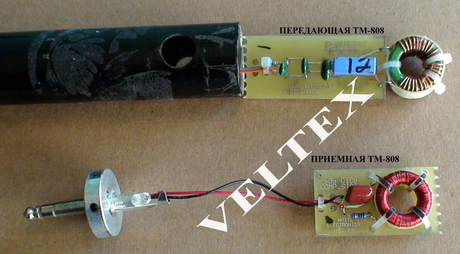

    I need shematic for PCB coils of Discovery TF-900.
    The forum is set for a PCB coils for White`s TM808: http://www.geotech1.com/forums/showt...oil-inductance
    Can someone help me with PCB shematic of Discovery TF-900 coils?
    Forward very much appreciate it!
    Regards!

        I do not know the parameters of the coils of the detector Discovery TF-900: TX & RX inductance and resistance.
        I got one demolished DISCOVERY TF-900.
        There are no PCB from the coils.
        I want to make a PCB for the TX and RX probes with ferrite rings, but I do not know the value of a power components.
        I saw on the forum that you gave the PCB to Whites TM-808: http://www.geotech1.com/forums/showt...oil-inductance
        I hope someone has to divide the PCB for DISCOVERI TF-900.
        Once again - thank you for answered!
        Regards!
        Sneshko

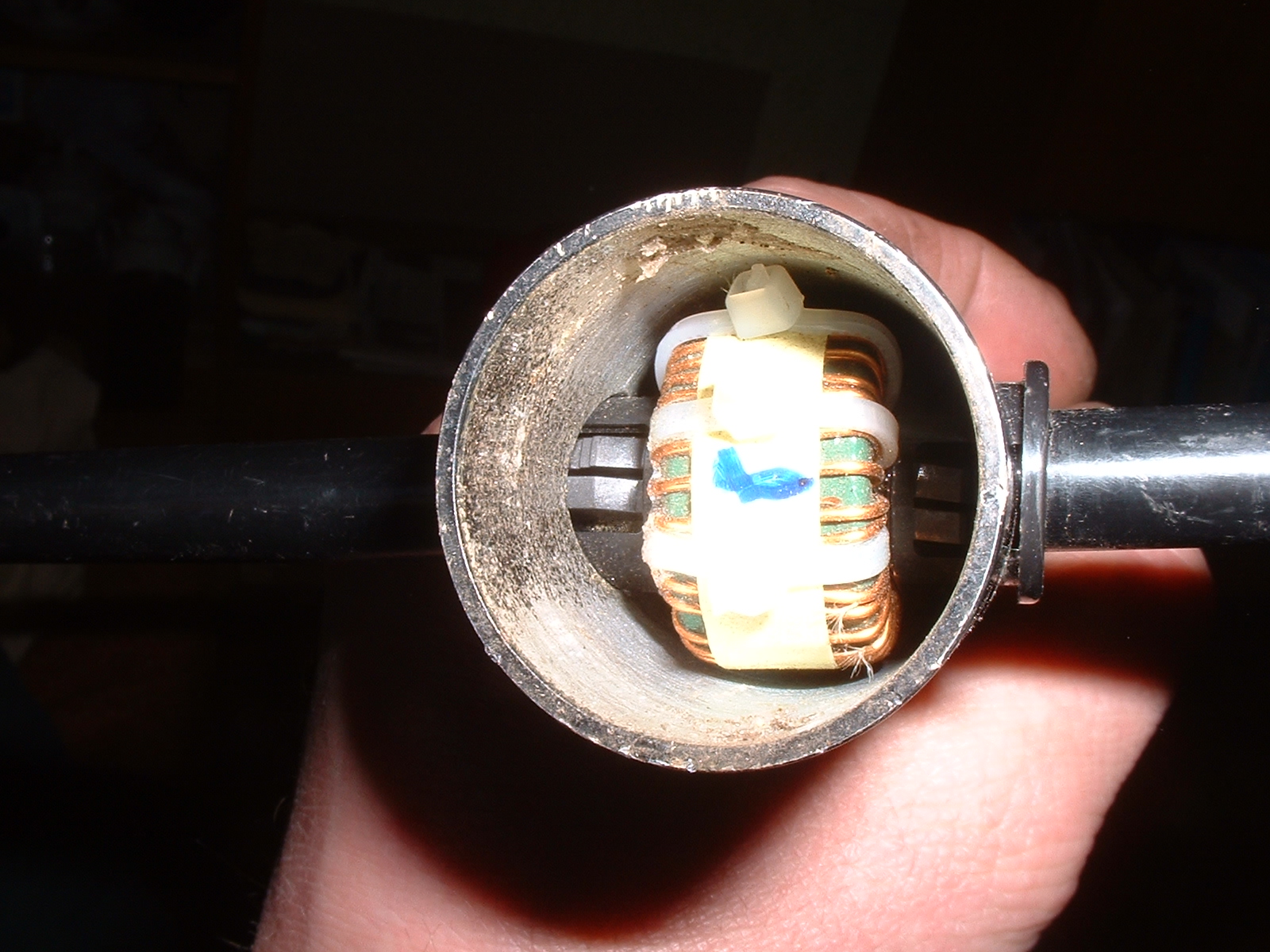

          TX = 645uH - 1,Ohm
          RX = 175mh - 113,Ohm
          TX - Витки посчитаны - 26 витков. Кольцо разбито . Размеры кольца примерно 22х14х13 (D d h).
          Емкость 1,03 uF При частоте Tx=6.6к индуктивность должна быть 570uH, тогда проницаемость такого кольца порядка 600.

                I see that the parameters for TX and RX coil same for Whites TM-808 and for Discovery TF-900.
                I hope I managed to make a PCB coil for Discovery TF-900.

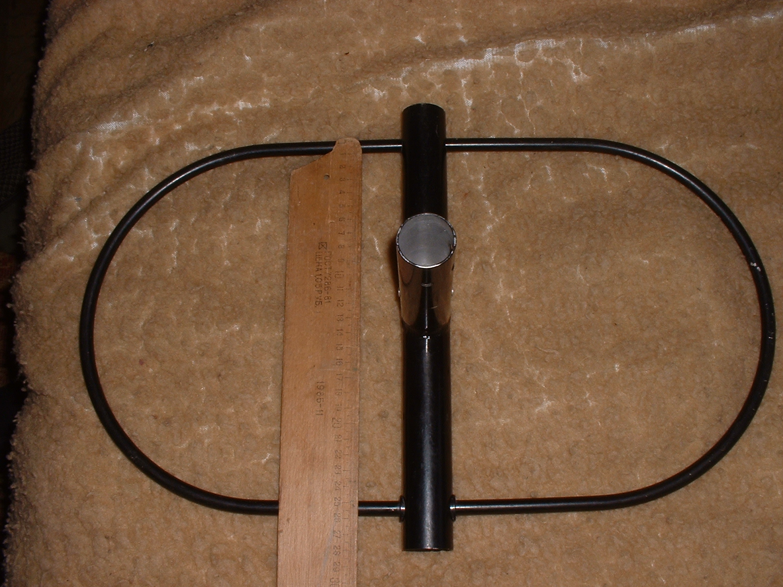

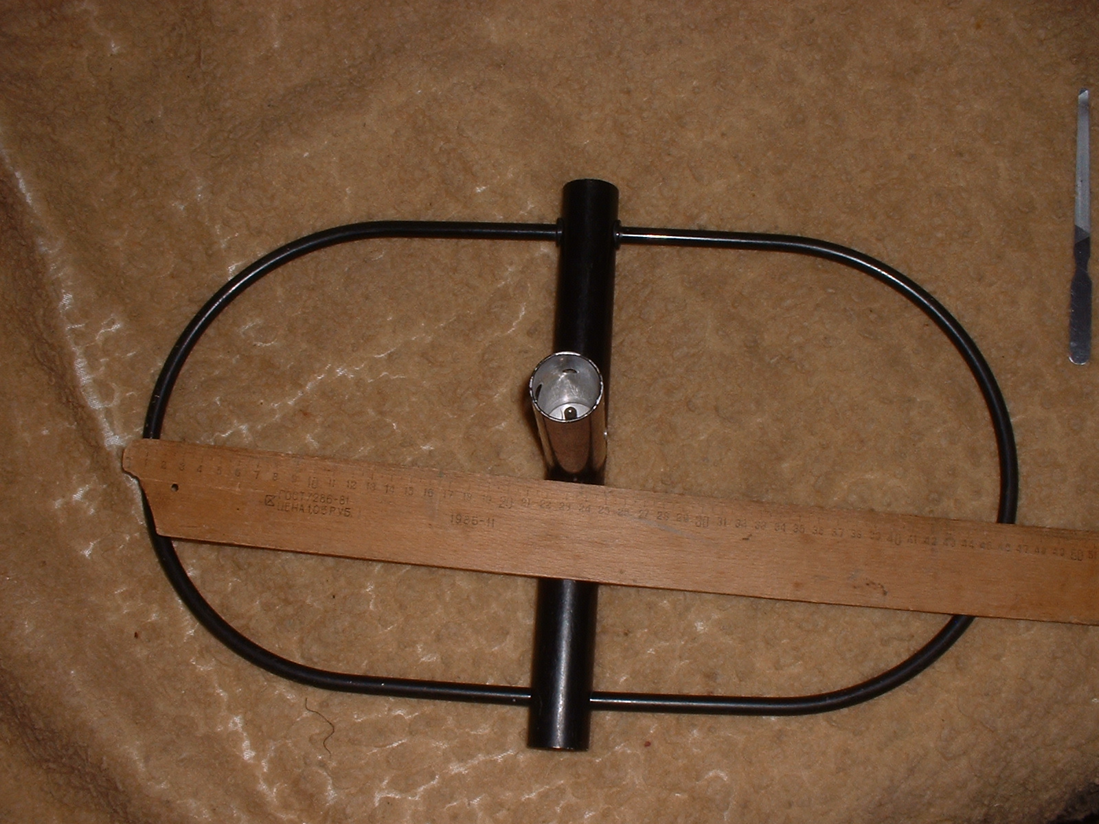

                  i gave for tm-808... but tf900 is same at basic.
                  Мой вариант.rar
