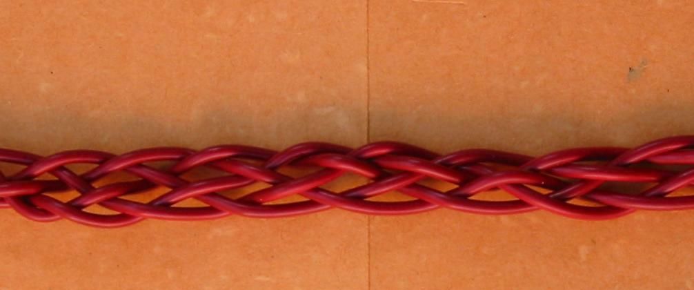

    Anybody know how you weave a coil like this ?
    I am guessing its made with more than one single wire ?, maybe 5 single wires and they are soldered together ?

    It is a Litz braid of 4 wires, and a very same weaving technique is explained here: http://www.chimeralabs.com/diy_braid.html
      Wouldn't that end up about the same as the Basket type coil?
        In case of a single untapped coil it would, but if you are into a bifilar, quadrifilar, or a centre-tapped coil it is a very different story.
          Hi , thanks, yes the link explains how I thought you would make this weave, multiple wires, thanks
