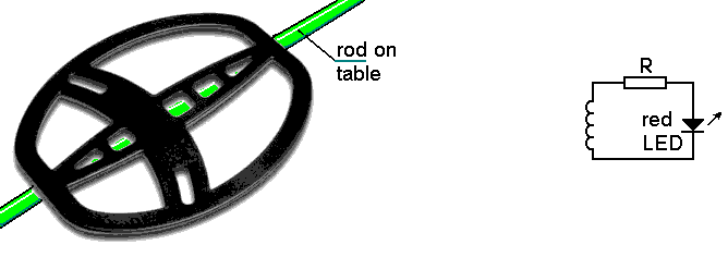

                As to determining where the TX winding is placed, I suggest two ways:
                1. By weight. If the search head is on a stem with axis of symmetry, it will lean towards the heavier part where the TX winding is. Place the rod on a table and then try to balance the search head on it.
                2. By generated TX field when the machine is running. You need a coil which is connected to an AC meter or a red LED. No need of resistor R.
                  Have a look here: http://www.geotech1.com/forums/showt...attery-charger
                  A small relay coil and a high-bright LED (with/without series resistor) will do the trick.
                  - Bernard
