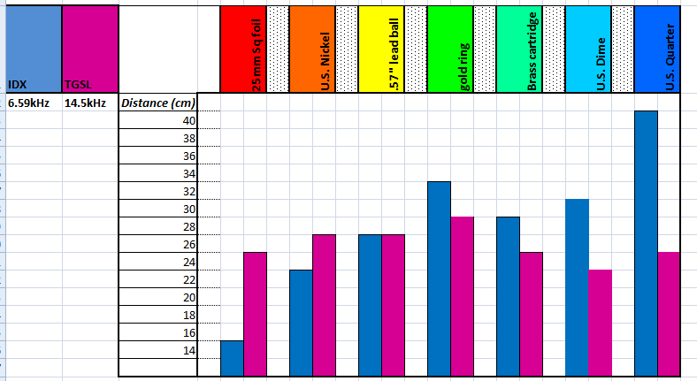

              It's a well known fact that in general, low frequency detectors are best suited for deeper, higher conducting targets while high frequency detectors are better suited for shallower, low conductors.
              Just how much of a difference is there REALLY???
              Since I built 2 concentric coils with identical geometry (one for IDX and one for TGSL), I put them to the test! The question arose in my head as to why some of my air tests with my TGSL coil showed poor results as compared to the IDX while ground test seemed equal.. DOH!! I was using a quarter for air test and a lead ball for ground testing..
              So.. Comparing oranges to oranges (or quarters to quarters) I was astounded by the results. No wonder manufacturers came up with multi frequency machines!!
              I set my GB and DISC setting for my IDX and TGSL to approximately the same place.
              As you can see from the tests, lead has an almost identical response to both detectors.. But look at the results for Aluminum foil and copper..Wow..
              Again, the coils are both 7.5" hand wound concentric coils and.. these are AIR tests.
              Don
                Hi Don
                If you want to find out how the sensitivity to various targets varies with frequency, it might be better to adjust the discrimination in each test until you get the maximum range. Leaving the discrimination at the same setting all the time means that the “gain” of the synchronous detector is varying for each target in an unknown way. Just a thought…
                  Originally posted by Gwil View Post
                  Hi Don
                  Yes.. I believe you are correct. The diagram probably has more to do with how the signals pass through the demodulators than anything. All metal tests produce more of a flat line across the conductivity range. And.. ground penetration was not taken into consideration. BUT at a given disc setting for both detectors this points out the strenghts of both.

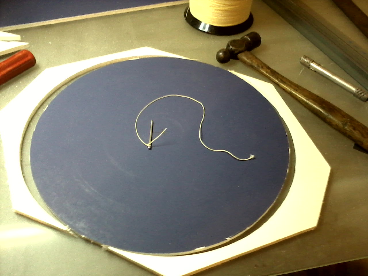

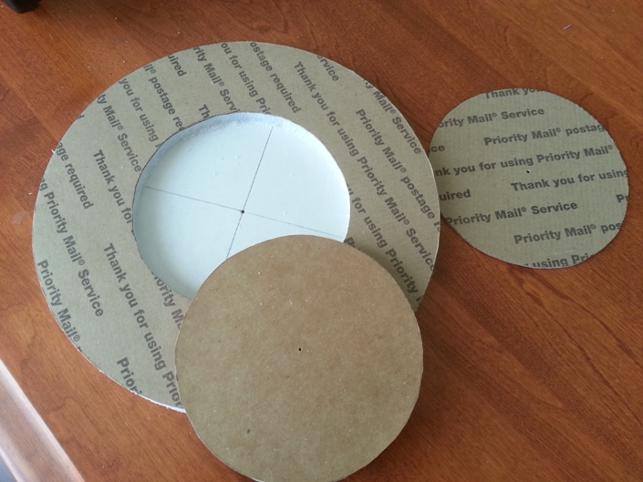

                    Construction methods are identical to the 7.5" coil project posted previously. Building this way does not look impressive, but foam board with cardboard skins glued to the outside results in an extremely stiff and mechanically stable assembly. Also, light as can be!!
                    Tx coil - 127mm radius (5"). It's build on a 130mm radius foam board with a groove cut in the edge with a hot iron. , 11mm thick. 87 turns using .25mm wire - 6.0 mH.
                    Wire is wound counter clockwise.
                    Rx coil - 63mm radius (2.5"). It's built on a 63mm radius foam board, made into a spool . Foam board started at 11mm thickness but sanded a bit so all fits flush when finished. 157 turns using .25mm wire - 6.5mH. Wire is wound counter clockwise.
                    Bucking coil - 23.5 turns (about) on the outside of the Rx coil, again .25mm wire. Wire is wound clockwise.
                    You can refer to the previous post for the coil schematic.. just scale up a bit and substitute the above number of turns.

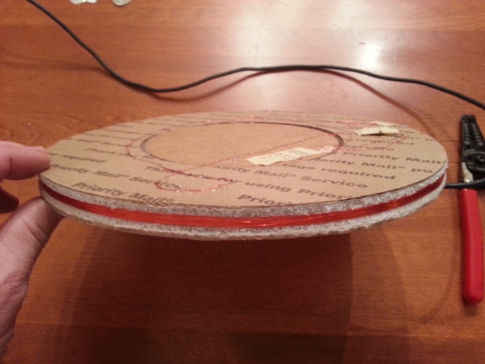

                      It's good that you're doing this, I just started a 10" using some foam cardboard composite stuff.
                      It is 5.25mm thick with 4.5mm foam using .25mm wire so this will hopefully be close to the same.

                          Don, any guess how deep a channel I should cut in the foam with a 4.5mm thickness?, I want to make sure I don't end up with spill over, or a deep recess. Or, what is the cross section diameter of your bundle of wire
                              Thomas,
                              It really doesn't matter how your coil ends up. There are three important things though that you need to pay attention to:
                              1. The mechanical stability of the assembly when you are done - It must be stiff and your wires should be fused together - I use krazy glue, but be careful not melt your foam.
                              2. The final inductances of the Tx and Rx coils - otherwise your phasing will be off and GB and disc will not be within the adjustment range of your pots.
                              3. The final null - Get the deepest null possible. If the residual signal is too high, your first op amp may end up in saturation.
                              Your coil could end up looking really ugly and still work just fine.. If you get it to work, I will send you something in the mail to finish your coil as a reward
