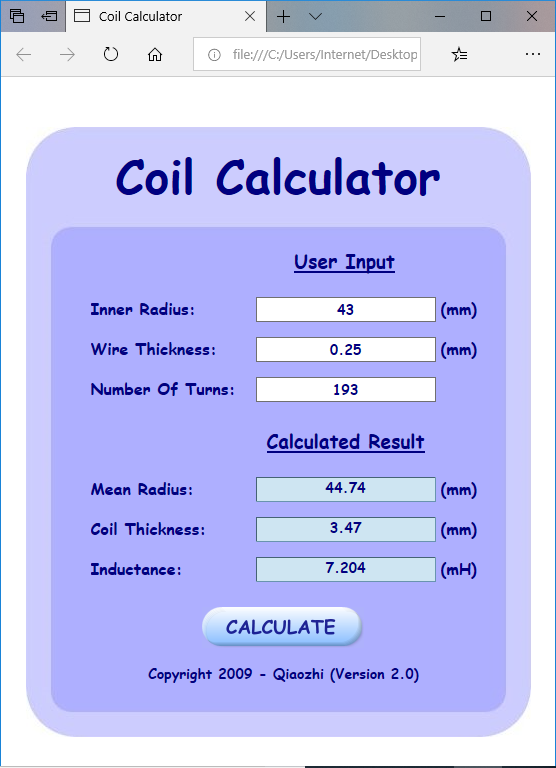

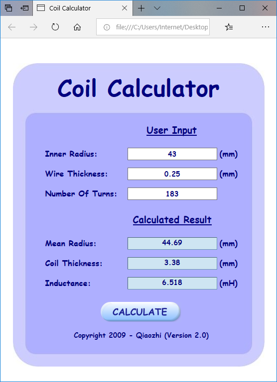

      I have redone the calculations and I believe there is a small mistake.
      The turns for RX should be 183 and not 193.

        How did you arrive at 183 turns? Show us HOW calculation was made. By which method? Formula? Coil calculator software? How exactly? There is a coil calculator at the beginning which everyone uses. Did you use it?
        It is not sufficient to say it is so, just by saying so. Hey, that's reminds me of a song from way back, "say it isn't so"
        • #94

              Originally posted by Maurizio2 View Post
              [ATTACH]46861[/ATTACH] correct
              [ATTACH]46862[/ATTACH] wrong
              Now clearly you have discovered a possible error in the document, which I can accept. That coil calculator is pretty accurate. Since the tx calculation in the document is bang on then it stands to reason that it could be an error but not necessarily. There could be some other reason. Only DB can say for sure.
              Thanks for pointing that out.

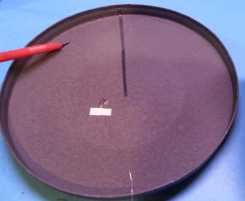

                    Hi Don!
                    The top and the bottom shell are shielded in the same manner.
                    You masked off a small strip of tape that when removed, leaves a small gap in the conductive coating.
                    Therefore the top and the bottom shell must be coupled in the same point where this gap finish, to avoid a short circuit.
                    Is it right?
                    • Originally posted by Maurizio2 View Post
                      [ATTACH]46872[/ATTACH]
                      Hi Don!
                      Is it right?
                      Well, not really because the bottom shell overlaps the outside of my top shell so there is a gap already. Unless you are using a highly conductive spray like nickel I don't think it matters. Graphite is a few kohms per square so it might not be so critical.
                      Anyway, that's my thoughts.

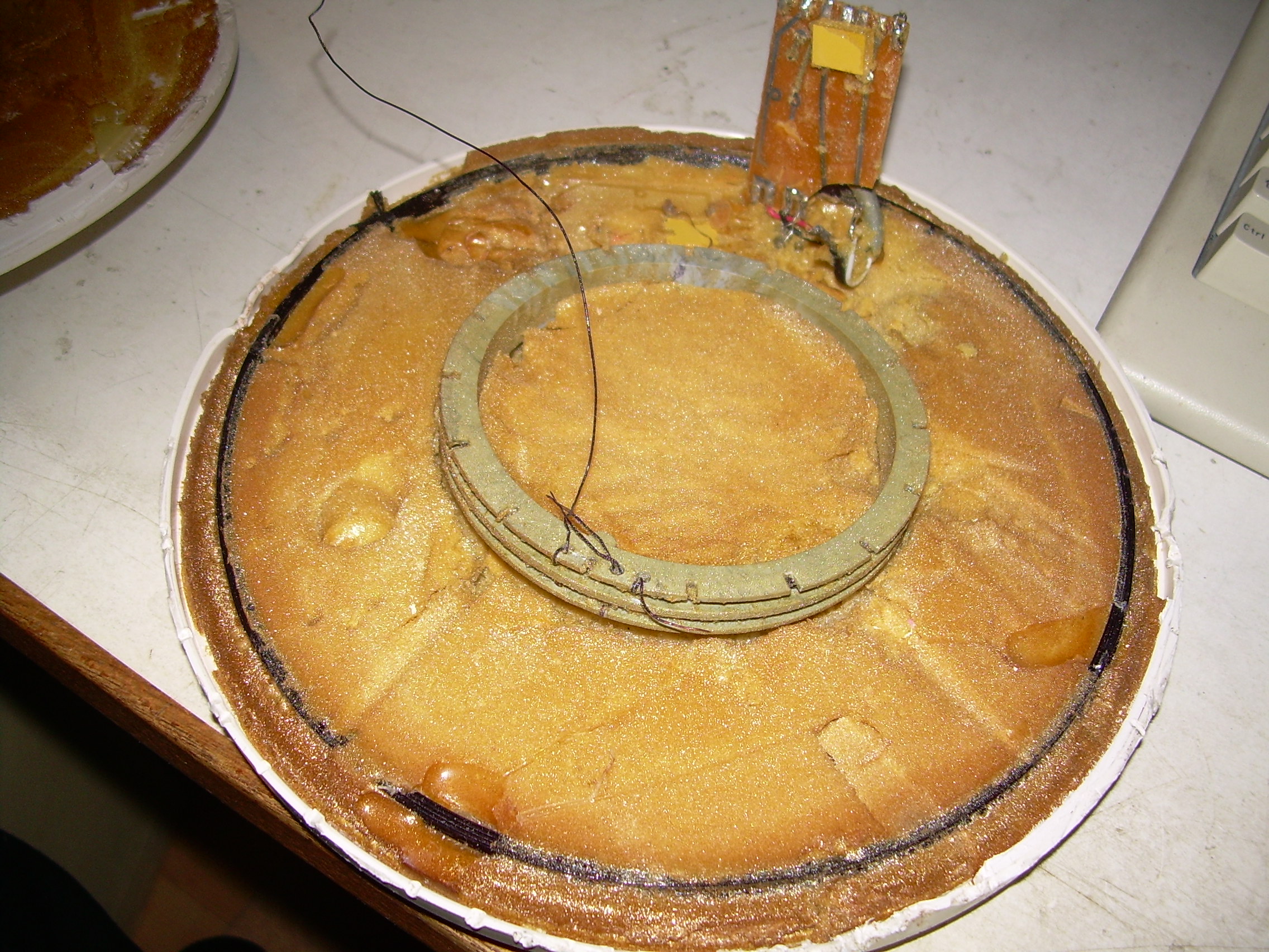

                      • In the construction of concentric coils, I highly recommend the Cscope method, which is to wrap the bucking coil on seperate winder with the same diameter as the RX coil, instead of wrapping the buck coil on top of the RX coil.
                        The RX coil contains a lot of windings such that the bucking coil, if wrapped on top of RX coil, is now slightly larger in diameter which makes balancing a little more tricky.
                        The calculations for number of turns for the bucking coil is made on the basis of the same diameter as the RX coil, which is now thrown slightly off(diameter of the buck coil) when wrapping the bucking coil on top of the finished RX coil.
                        Also, wrapping them on separate winders(spools) makes it possible to remove some turns on RX coil as well if that is deemed necessary.
                        Have a look at some photos of a Cscope concentric elsewhere on forum for some pics.
                        I think this approach makes concentric coil building much easier in terms of getting it to balance within required specs.
                        With this proven method, one can make any size search coil for any detector. Just something to consider.

                              yes Waltr, the little extra wire is moved around, however that assumes that you are pretty close to the null, the little wire is then used to fine tune the final setting.
                              However, just one turn too much or to little on the bucking coil(vlf concentric design) is enough to throw the null out by a wide margin. Just imagine your calculation for the buck requires 20 turns on 10cm diameter, then if you wound the bucking coil on top of the RX coil, the starting diameter is now 10cm plus say 4mm. That extra 4mm is enough to render your calculation of 20 turns too much by one or two turns believe it or not! Now you are left with trying to remove a turn or two, endless tinkering etc.(and so by removing turns on buck coil) it changes the inductance of the TX coil and messes with the TX oscillator frequency! Many headaches!!
                              So by winding the buck and RX separately, one can avoid these issues to some extent. You have a much easier task of getting it close enough to null based on initial calculations so that just the little extra "loop" moving around is sufficient to bring it to a final null.
                              Here is a photo of a Cscope coil. Notice the double spool for RX and buck. Just print a few such forms and perhaps an outer form for the TX(although not necessary), and now life in the world of concentric coil construction is much easier.
