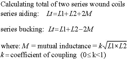

                    Originally posted by mykaitch View Post
                    If L1=L2 then in theory, when out of phase both cancel and osc stops ?
                    It's not that simple. Look at the formulas. (Fortunately, there ARE formulas.) edit: YES that is correct, if both coils are same and perfectly coupled.
                    When your coils have space between them, something that will very likely prevent you from being able to accurately predict how the coils either add or subtract: coefficient of coupling 'k'.
                    If you have a good LCR meter and some skill with algebra you could measure some air core coil combinations and work your way back to k, but that's not my idea of fun!
                    Two identical series aiding coils with perfect coupling, will give you 4x the value of a single coil. That goes along with the fact that doubling the windings in a coil can give you nearly 4x the original value. (The coil must be close wound to obtain 4x.)
                    A good scientific calculator can come in handy, but if you are trying to calculate an IB coil with a buck winding, you have a largely unknown value of k because of the distance between the two windings. The trial and error of adding or subtracting windings to stay on frequency will be inescapable unless you not bother with frequency change. Maybe you should worry about getting a good null and not worry so much about small frequency changes.
                    Of course you have seen the new PDF file on this subject? You'll find it here:
                    Also, look at " Construction of Coplanar Search Coils "
                    and US4293816.
                    edit: I had to remove some material that when evaluated left me baffled. Formula for M was incorrect.
                    Two indentical coils, reverse wound with perfect coupling (k=1), will indeed give you zero L. (I can see that now that I corrected my formula for M.)

                        Whew. I tripped all over that last post because I was originally using k=sqrt (L1+L2), but k=sqrt(L1XL2) is correct. I only realized that after I came up with a negative value when trying to evaluate the case of two reverse wound coils.
                          BTW guys,
                          in a concentric co-planar IB coil, the coefficient of coupling k is negative. The bucking coil is in opposite windinging direction to the transmit coil. For a half diameter bucking coil, use an approximation for k around -0.1 to -0.15.
                          Aziz
                          PS: To avoid confusion:
                          L = L1 + L2 + 2*k*sqrt(L1*L2), since k is negative due to reversed bucking coil winding direction
                          L = L1 + L2 - 2*|k|*sqrt(L1*L2), |k| = absolute value of k ( abs(k) )

                              Hmm. I knew that L1+Ln add to increase inductance. Fine, so I have just done an experiment. I wound my Rx coil and measured the F at 10.6KHz. Then I placed an old buck coil in series, a few inches away. F reduced as I knew it would. Reversed buck coil - no difference.
                              I have just destroyed one of the foundations of electronics - a nobel prize beckons, or I am a twat (is that okay to say ?). Knowing about EMF and coupling and stuff a placed the secons coil on top of the Rx coil. Now it follows the rules, ie F goes up or down depending on L2 phase (easily done by turning the coil over. Damn - No Nobel prize, again.
                              So, I think the point missing in the discussions is simple transformer theory and I should have thought of that!
                              EG; If you take two identical transformers and parallel the secondaries you can double the current - so long as they are in phase. If one is out of phase they don't 'alf get 'ot.
