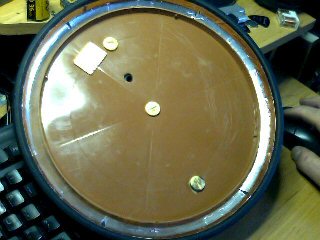

    Here we go then. I made the jig that Dave Emery shows in his excellent PDF, and I calculated my coils as he said (and they worked). The first buck coil didn't because I got cocky and guessed it.

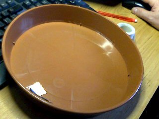

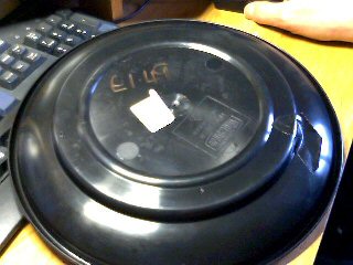

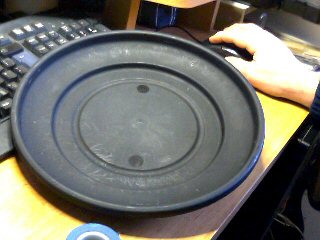

    The Pics. I black 'case' is a plant pot saucer fron a garden centre - cost about 2 bucks (see I speak American now ).
    I got excited, but the matt black inside is not a graphite coating. Doh!
    The brown tray came from the same place - about a buck. It will appear again later.

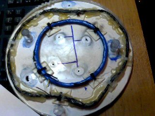

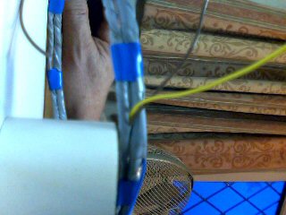

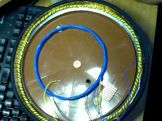

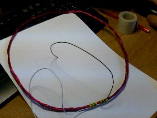

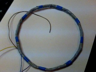

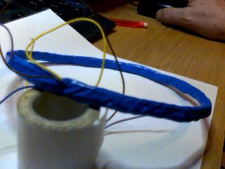

    The blue coil is my Rx coil with the Buck coil on top. I took grat care with the shape and alignment.
    The red one is the Tx coil.
    Number of turns are almost exactly what Dave's article says they would be.
    When I wound them I wound into the right angle of the hook,not onto the base. This let me soak them in varnish and not stick them down. Next day they came off easily and the turns are all nice and close - you can actually mold the coils now to get them perfect and removing turns is easy - I wound all of them well over the turns they should be because I find it easier to remove turns than add!
    Nulling, with a trick I got from another GeoT posting came down to flat line at 1mV on the scope, that's right - zero.

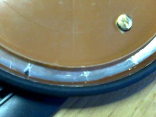

      So excited as I was...I rushed out and finished it - total (as we say over here) crap. Could not get a null below about 2v pp...
      Doh! Took it to bits, ripped out shield (never thought it would work). Perfect!
      Why does my shield screw it up ? Is it because it forms a closed loop around the tx ?

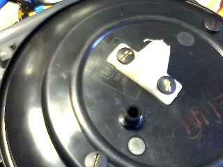

      In these pics, the odd looking coil is the old Mk1 - the null set by adjusting the Tx coil shape - which raises a Q (not to be answered), what on earth is the field shape from that coil ? The silver you can see is a screen that goes all over the black shell inside. There is (was) a copper tape all around the lip to join up all the alu tape(conn to ground). Now removed. The thing to fit the head to a stick is from a boat (used to tie the awning). The plastic screws are those things left over when you fit a new kitchen, and the cupboards fall down.
