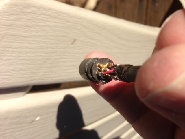

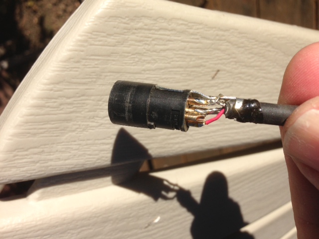

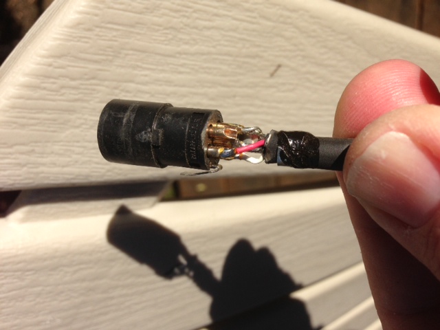

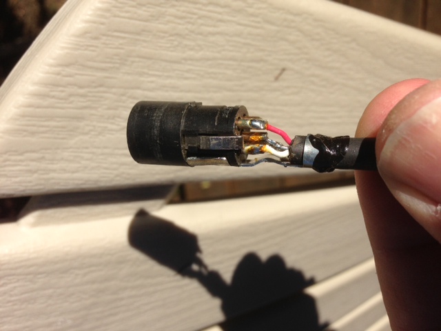

    I need help! The wires got pulled out of my Gold Bug 2 and I need help on where to re solder them. I was surprised that there are only two wires from the coil, Green and Orange with no shield or ground wire. Does anyone have the info. on this? Thanks

      Sorry for my dumb answer - I thought it was simpler than it is. I have a GB2 that supposedly is one of the earlier ones.
      Attached are photos of the plug wiring.
      Referring to numbers embossed on rear of plug:
      1 - n/c
      2 - red
      3 - ground of plug and red's shield
      4
      5
      6 white
      white's shield is center pin (4 or 5?)
