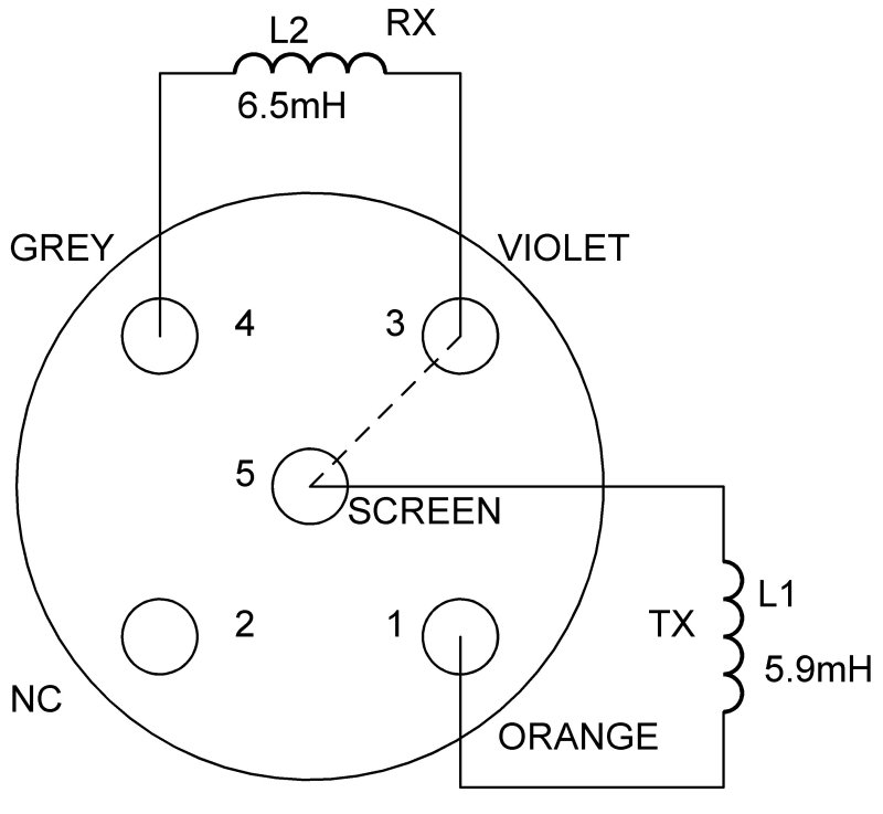

    Hi all, in this coil connector I have broken the blue wire and do not know if others are well placed. Can you tell me which wires are RX and TX and as pin which are connected?
    thanks
Name:	Tesoro Coil Connections - reduced.jpg
      Thanks SIlverdog, and another question, is normal 0,2 ohm. in TX and 21,4 ohm. between violet and screen and open circuit between grey and violet?
