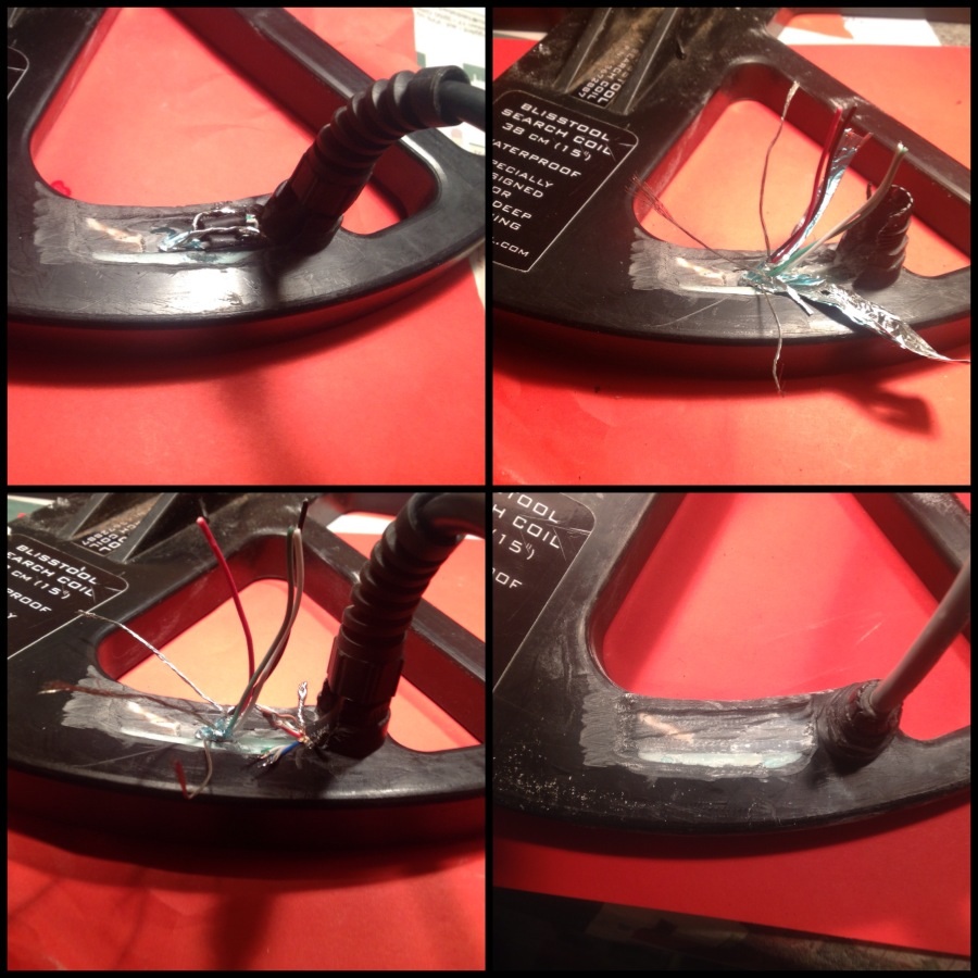

    Hi all.
    I tryed to get help.(other thread).. Now I toke the change to open the Coil. (See picture)
    It seem to Be a succes, so fare.
    The new cable is a soft HDMI cable, where there is 4 pair sealed. They are only 0,2 each, so used them dobble, to get 2 pair and go up to 0,4.
    Never tryed this before, so I can't Wait to go out at do the test...
    All this work, because the Stock cable gave false signals in cold weather... (Cold microphone problems)
    Henrik.
    ****... It didn't work... No Sound at all.... Must Be wrong cable, impedance to low !!!
    I got tears in my eyes.
      Now Henrik is happy. It is working know, even tryed it out in the cold..
      HDMI Cable can Be used, you just have to use 2 pair and do not mix the pairs, like I did in first try.
      My detektor is more calm know, and the deept seem to be Good, Maybee increased.
      Thanks fore reading.
