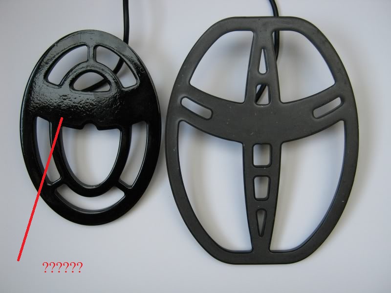

    I want to fix a coil with a resin or .... as we fix those at Garrett. that I could use. Who can help meClick image for larger version
    I believe it is epoxy resin
      Are you wanting to repair an epoxy-filled coil? Or build one?
        softened by boiling water. then disassembled. rewindable.
          Are you sure it is not ABS? I use ABS for sluices and make ABS putty for filling holes that I goofed on. Putty is ABS dissolved in MEK (methyl ethyl ketone). Do not breathe fumes - MEK is very bad for your lungs. The putty is pretty much the same stuff as ABS pipe cement available at hardware/plumbing stores. Just much cheaper.
          eric
            Most solid coils are filled with epoxy that is lightened with microballoons (small glass spheres). My experience is that you will tear a coil all to pieces trying to get the epoxy out (I use a heat gun), and spend hours doing it. Basically, it's not worth the effort.

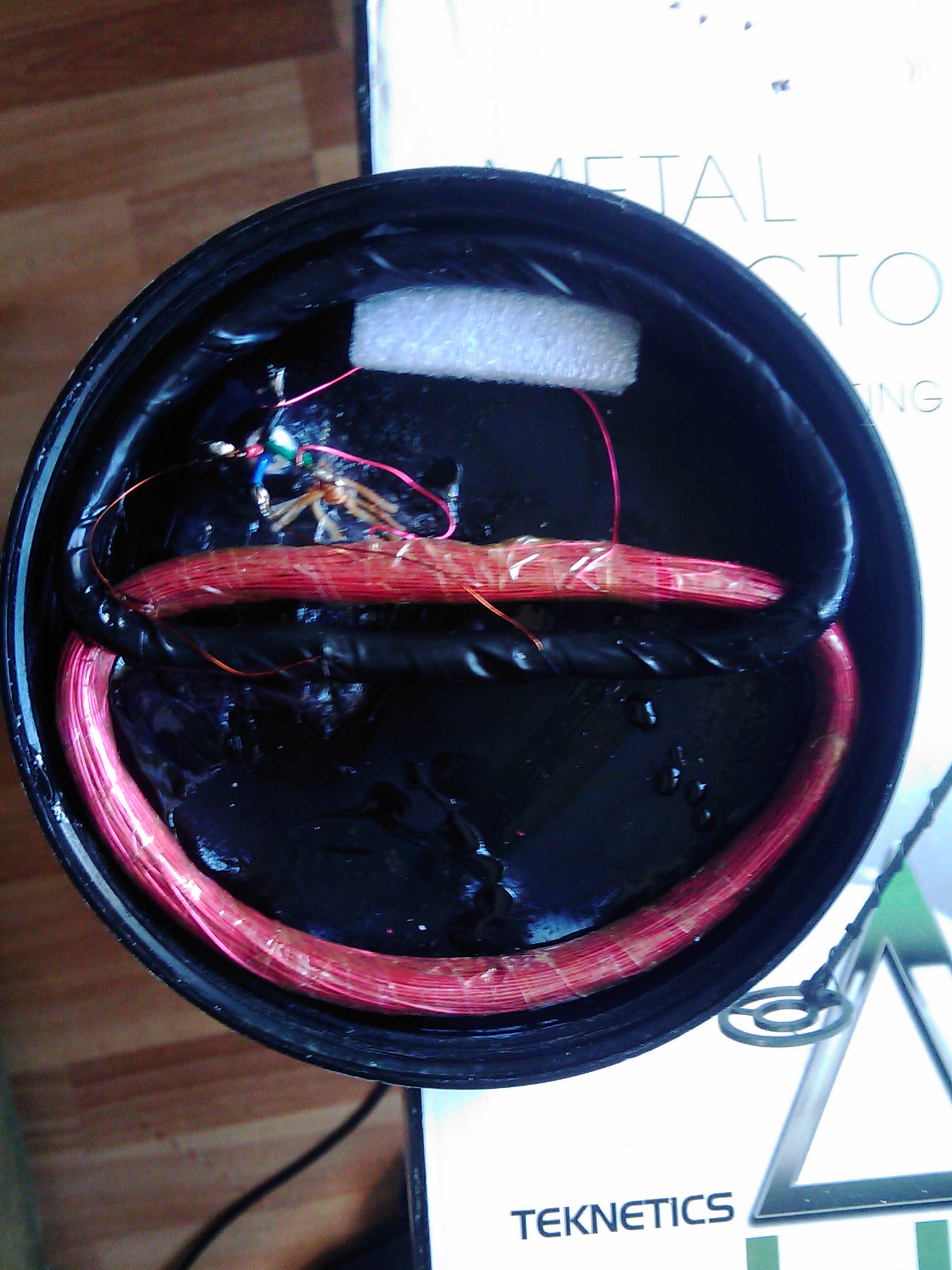

              build one ..exampleClick image for larger version
