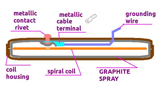

            For visual guys:
Name:	Graphite coil contacts.jpg
            Instead of using rivets, you soldering wire at about tiny 2x2cm Cu metal sheet, than glue at inner side of coil housing and then spraying by graphite.

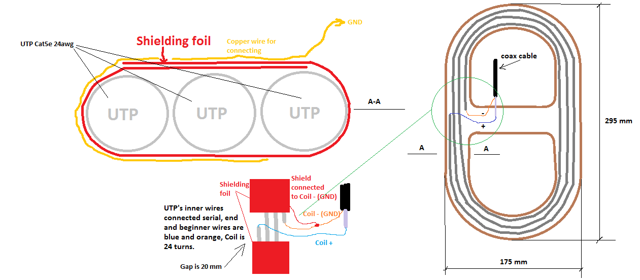

                      I made a SurfXX PI metal detector. The coil was made of UTP cable, at first without shielding. The machine worked well when I used it in dry weather. My problem is that the detector goes crazy when it operates over wet ground. It gives false signals.
                      So I decided to shield the coil. I wrapped the coil in aluminium foil, then the foil was connected to the coil negative lead (GND) through a copper wire. The shield has a gap, approximately 1cm. But the detector doesn't work. It detects the foil. When I turn the Treshold higher, the detector responses to metal objects, but only about 1/5 of the distance without shielding. I tried to change the damping resistors value, but that had no effect. What should be the problem?
                      Thank you for your help.

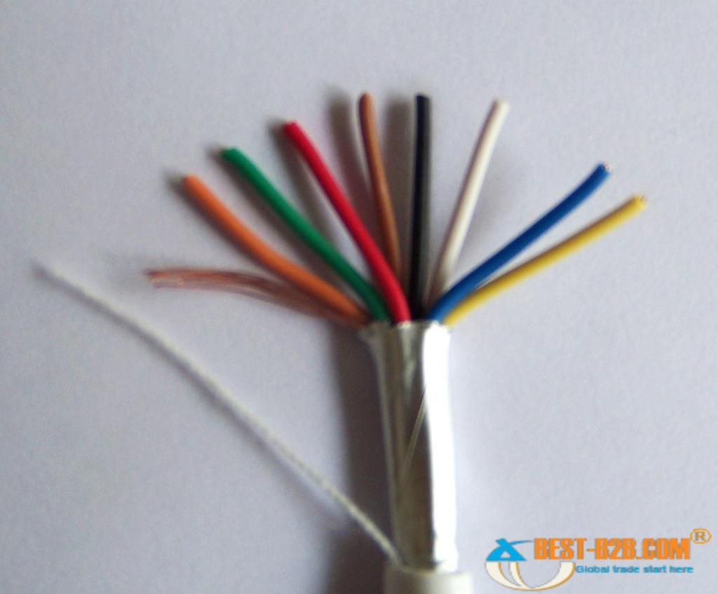

                        I have an other idea: how about making a coil out of alarm cable? It is similar to the UTP, but it has a shield. Has anyone tried this?Click image for larger version
                          Please make a picture of the coil and show us how you made the shield.
                            It should work, but I wonder if you will have enough windings to achieve the correct inductance.
                              I couldn't take pictures of my coil but I made a "professional" drawing of it. I hope you will see what you are interested in.
Name:	Coil section.png
ID:	335452Click image for larger version
ID:	335453I made some modifications on the shielding, you can see the latest conditions on the drawing. I have experimented the appropriate number of turns, and if I remember well, it was good between 23-27 turns.
                              The detector is sensitive enough without the shield, it has about 20cm sensitivity for small coins. Works stable on dry ground, only problem is the wet soil.
                              I tried to change the damping resistor's value and the impulse length but no success. I guess the aluminium foil should be a wrong material or it is too thick.
