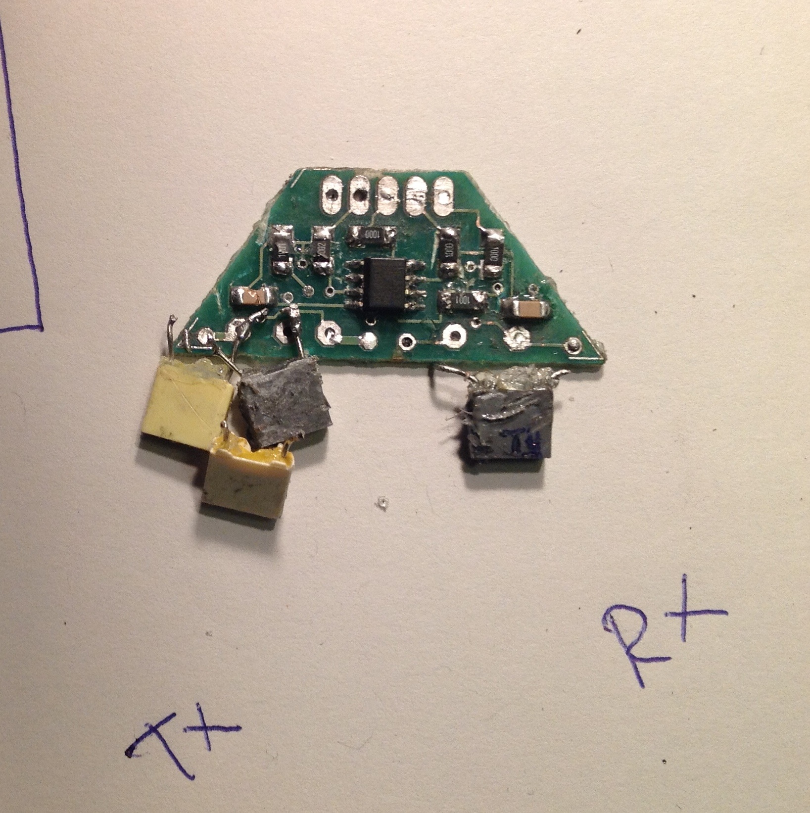

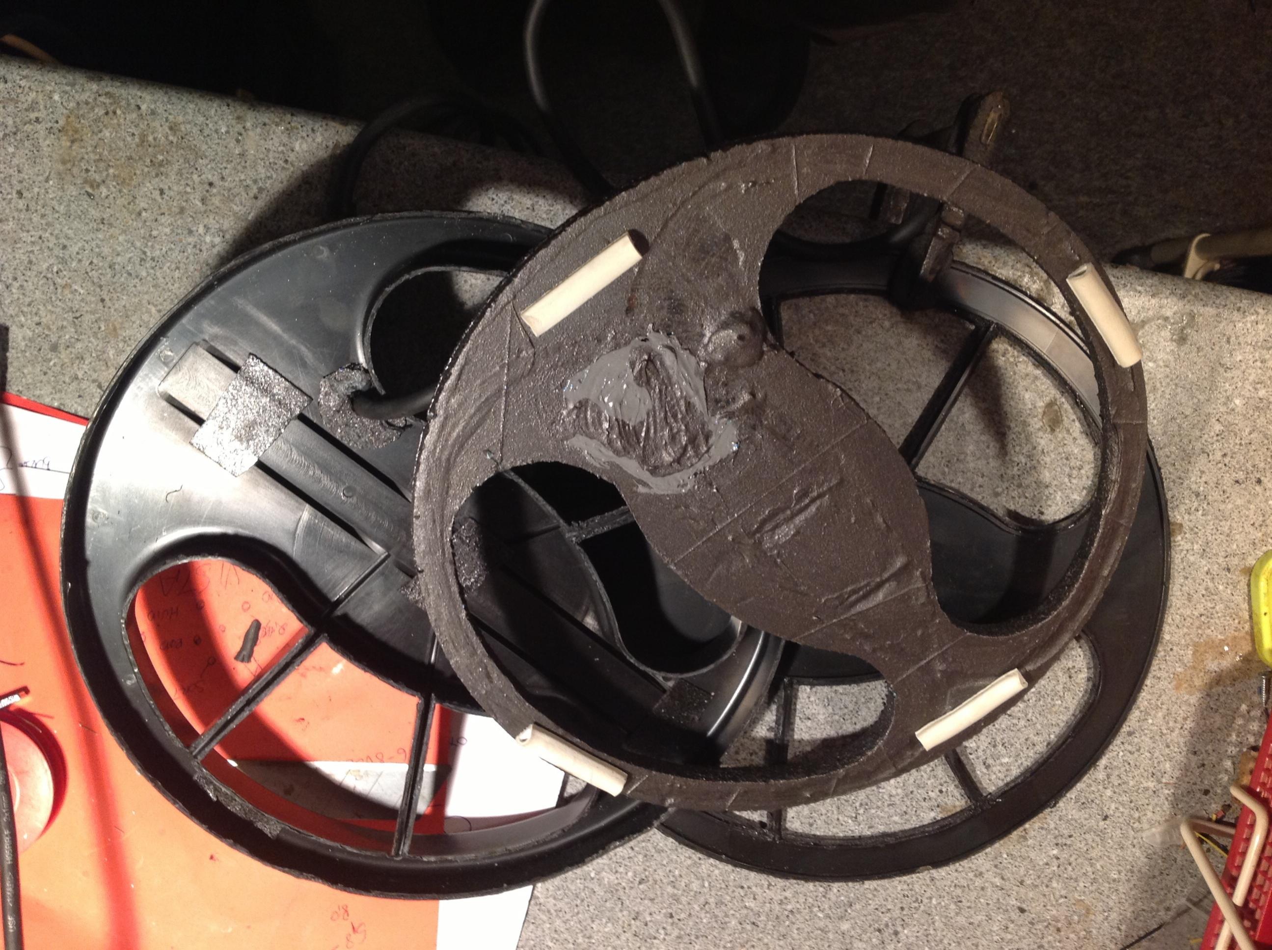

          You so correctly Davor. It just open it and it was Very Nice made, with a board and on that a 8 pin IC, some resistors and capacitor...
          A small ekstra coil to finetune the TX, and all glued together. I take it as learning and properly in 4-5 years I can make a coil.
          The TX was 2,4 ohm with 0,63 mm wire and the RX 17,2 ohm with 0,30 mm wire. If I am really lucky, the board still works, and I can try to make a coil. Thanks.

            Trying had to do this. Allso to post pictures right...
              I could take it apart, so the board came out...
                Any idea or a guess what I should measure. ?
                Coil inder diameter 145 x 215 (DD) and TX 2,4 ohm with 0,60 wire ?
                And RX the same size 145 x 215 mm - RX 17,2 ohm with 0,30mm wire ?
                It would Be a big help, If somebody has an idea what appoxly I should measure.
                My plan is to build a larger coil, (13") the stock coil is 11", and I think that to get the same uH or mH, I must use one size up in thickens of cobberwire...RX 0,35 / TX 0,70 or stay 0,60. ! is that what you allso would do ?
