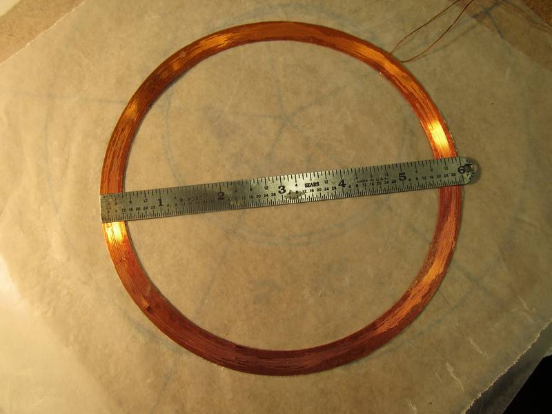

    Just Curious if I could Wind This Radial Coil.
    LOTS OF FUN, But turned out Very Good!
    30 AWG wire, 5.25" ID and 6" OD.
    Inductance 350uH
    DC Resistance is 5.7 Ohms.
    I Didn't count the Exact Turns yet, But I will.
    **Finished weight is 6.5 Grams.

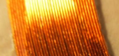

    did you glue the wires together? Looks like it... Did you do any measurements besides resistance and inductance? What about the self-resonance frequency?

        When I make coils on a wooden peg former - then bind the turns with cord, the turns are bundled - no set place for the turns.
        When I have in the past made or modified a Transformer or commericial coil, the turns are all arranged neatly - side by side...
        For greater efficiency.
        If I can summon up some motivation, I may wind one with 'neat turns' where the each turn is 'in its proper place'.

          As Close as I can determine, the Self Resonant Frequency is 2.56 Mhz.
          The Coil has 32 Turns, 30 AWG.

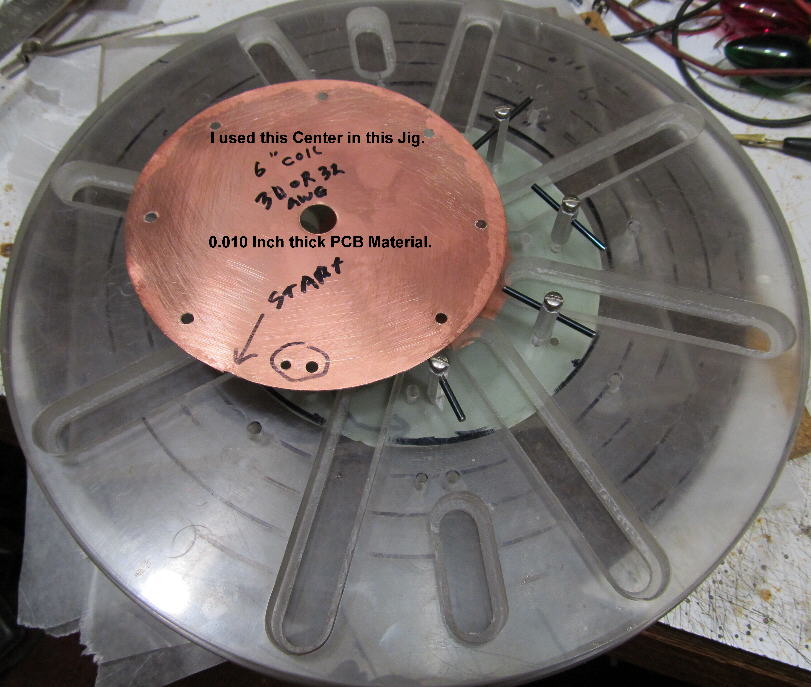

              This coil was wound in This Jig, using the .010" thin PCB as a center piece.
              First Attempt to wind this Failed badly, It Fell apart on removal from jig.
              Second attempt was wound in 2 Minutes.
              However Epoxy Coatings and Drying times too over 3 Hours to finish it.
              I measured the Interwire Capacitance to be 10pF.
              On my detector, it detected a 1 Gram Gold Nugget at 3 Inches
              And a 1/2 gram at about 1 1/4 Inches.
