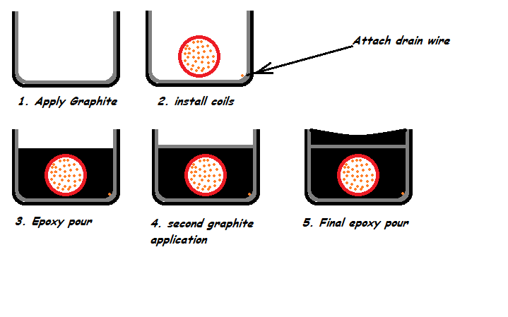

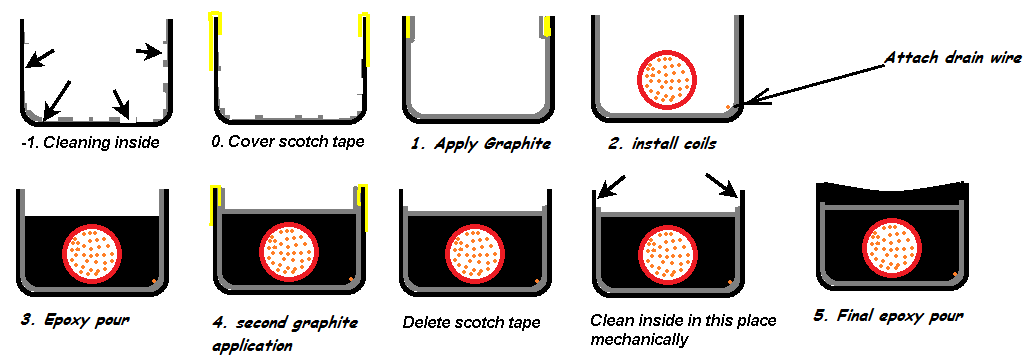

Basic concentric design

              I guess if you had a top and bottom LIDS - then sure add paint to both halves -why woudlnt you. I get this.
              What I dont get is,,
              Specifically on a concentric spider, (like tesoro, 9x8 or a whites 9" circular) the shell has carbon paint in it - (ive seen it on tesoro shop video) the coils go in, the operator adjusts it all, then, this is the point it all goes a bit dark.
              Does the potting resin have lots of carbon in it to form the other half of the E-screen. ( As this is the side that looks at the ground )
              Do you put a graphited paper ring in on top of the coil - touching a ground pad - then Pot with normal potting compound.??
              (You could do ally foil or survival blaket and wire but bit of a chore)
              Do you not bother with closing the box ? Is the E-screen only on 3 sides??

                  Just a suggestion.. Graphite spray is easy. The only issue I could see with this approach is getting the epoxy to stick.
                  The graphite spray I have been using almost melts itself into the plastic anyway from the liquid carrier in the aerosol.
