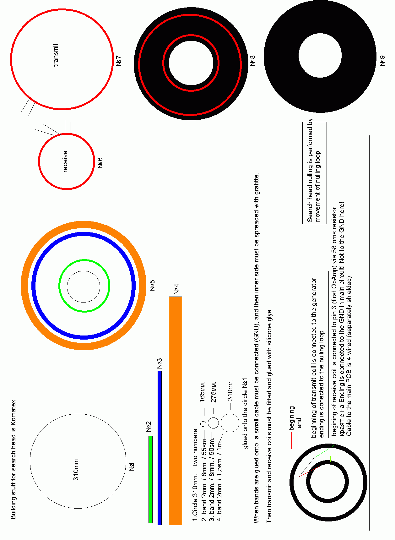

    I would like to build a 10" concentric coil for a 1260x since there are none available. Any help would be appreciated greatly! Attached is a drawing with the stock 8" coil specs. I need to figure no. of turns for both coils, resistance, capacitance etc.
    is it '1200 typo' coil? in RU zine I see a data on 1270 coil... will be this info useful for you?

        The pause is abnormal. Click image for larger version
