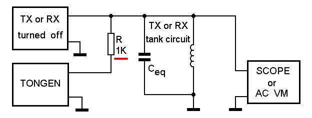

      I don't know if this is a bad way to do it, but I used a tone generator and the scope and one resistor at 1K ohm. (Detector turned OFF)
      With the plug in the detector and the 1 k ohm at hot wire from the generator, And the scope prope at the plug, I could could see the resonance at coil 1 and then coil 2. If they got same resonance, everything seem to me thats they should work.
      If there where some different I could finetune with a small capacity, but only If the coil was to high at resonance.
      Doing this I had in mind what Freq. the Detector was runing, and was happy If the resonance allso was the same as the Freq.
      Sorry my bad english, I hope you understand. Otherwise Maybee a Guru can explain, If this is a good idea to do it.
      Henrik.
        Henrik, if this is your test circuit, you should increase resistance more than 10K.
        Resistance 1 kohm is too low. It operates as damping resistor.
          You do not need to achieve exactly the same Tx frequency. Plus or minus 30% is fine.

            In my case I will change to a 10 k ohm, next time. At my Teroso 14,(x) khz, the TX had the same resonans, but the RX was some of.
            At my Bliss both the TX and the RX got 8,10 KHZ as the detector is working at. And last on my Vista Gold the TX was 25 khz, but the RX got amplifirer in the seachcoil, so couldn't Be measured like this.
            Measuring the coil and the Detector together with the plug in the detector, you have the capacity built in the Detector in play allso.

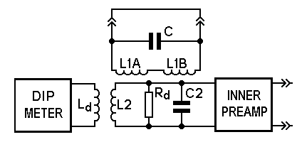

              Despite inner preamp, the resonance frequency of RX tank circuit can be measured by inductive absorption.
              Radio amateurs use a device called "dip meter", dipmeter, or just dipper. It measures the energy absorption at given frequency by inductively coupled nearby tank circuit. The dipper contains a tunable generator whose current changes when the RX tank circuit in the vicinity is in resonance. The generator is tuned for maximum energy absorption or dip reading in an indicator. The coil Ld serves as inductive coupling to the measured LC resonant circuit. It should have diameter almost those of the measured RX coil. For correct measurement, the TX coil L1 is shorted. This has little influence for measurement because L1A and L1B form induction balance with RX coil L2.
                Not all Rx-es have a parallel capacitor though...
                  However each Rx has a resonance frequency thouph ...
                    Not if series tank is terminated with high impedance. In such configurations the only resonance you may measure is a self-resonance of the coil, and that is not the one you are after.
                    Hence, a coil resonance works in situ only if there is a parallel resonance with Q well over 0.5.
                    OK, most detectors qualify.
