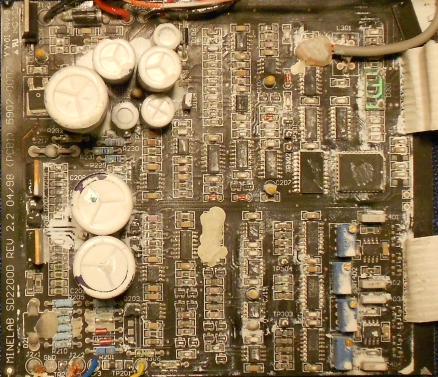

      Mick I SODA Blasted off the White Paint on one side of one board and both sides of the POWER and COIL board.
      DO you think that I need to start a new thread on doing a reverse engineer of the Power/Coil board or should I RESURECT the old "SD2200V2 Noisless Power Supply Thread and have all that info CONTAINED in one SPOT/thread.
      PIC's will follow in what ever thread we do decide.
      PS it makes things so much easire to ID with the White STUFF OFF.

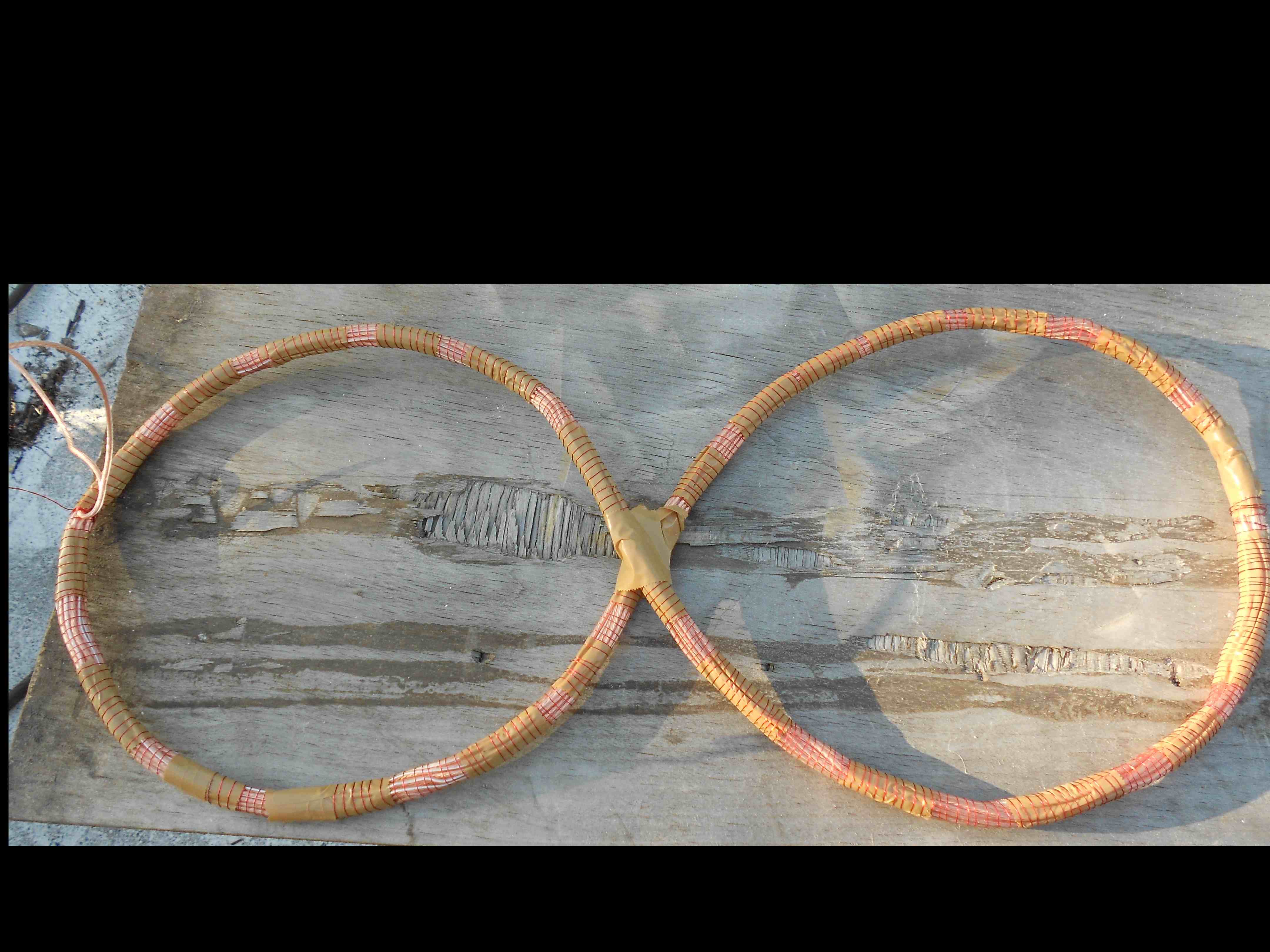

        Final Fig 8 coil specs and pics!
        Well here is the my final figure 8 antiference Bench Coil.
Name:	Fig 8 coil post.jpg
        I used 60ft (18.28M) 18awg Twin lead Speaker wire from Rshak pn:279-008 clear. I seperated the zip soldered ends with 2 overlaping shrink tube to reach apx the dia. of insulation on wire.

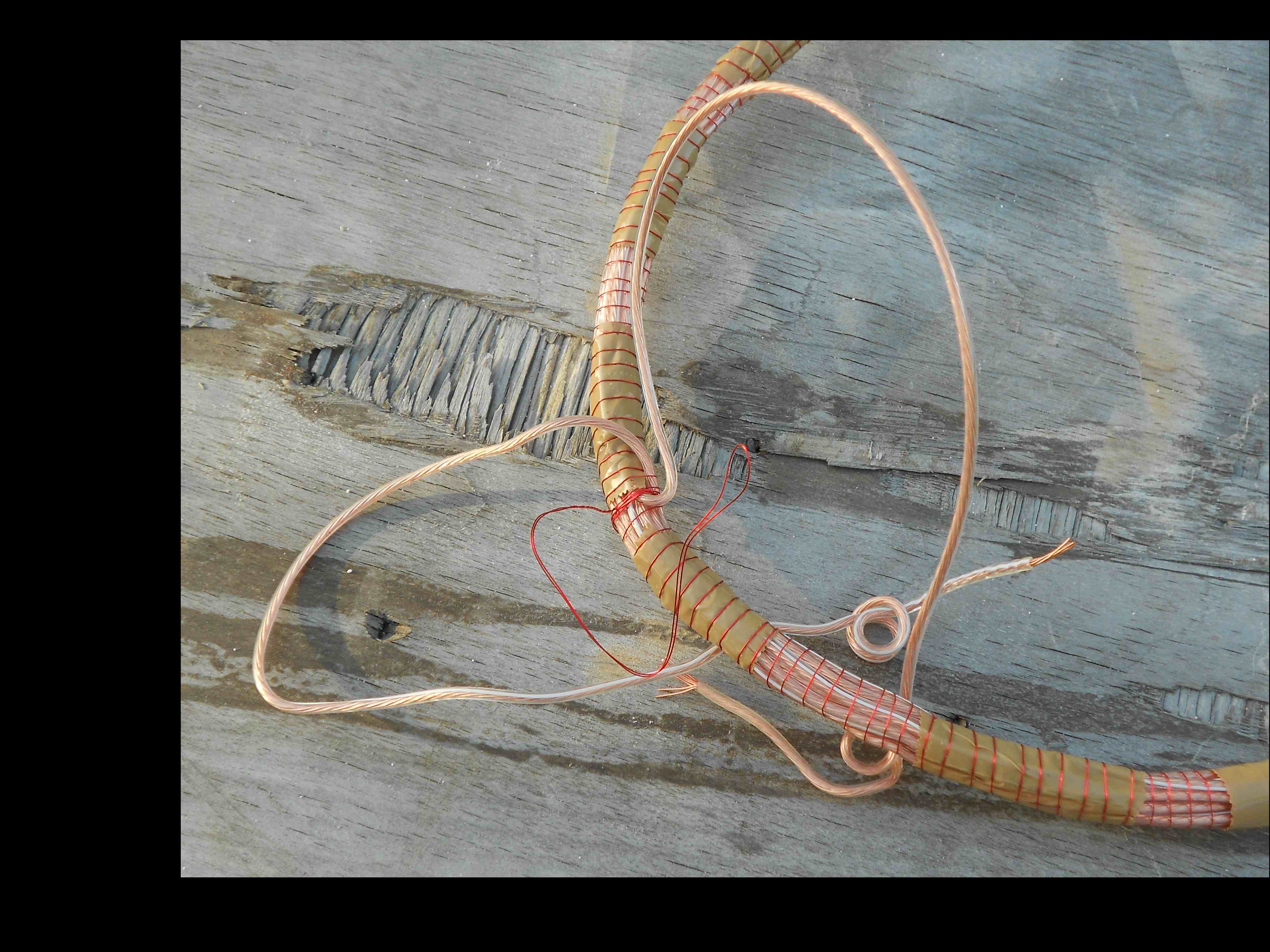

        I wound 19 turns on the coil form previously pictured. Then I tested for ohms and inductance and had to unwind 1 loop. Then I wraped packing tape to hold the coil togeather and then took 30agw magnet wire and wound around and round as in pics. I started from the side of the coil from where the 2 windings come togeather and wraped till I got to the Left hand. I then made a Loop and then continued winding down the other side of the coil, back to the start, leaving 1/8"+ between windings.
Name:	Fig 8 coil shld post.jpg

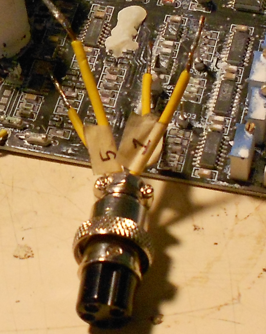

        I had to wait till I got my 5 pin CB Mic connectors to get the MD to settle down. When they go in I tested the fit and It was too Tight/Small, not like the ML ends. So I took my Digital Calipers and found that the OD on the plug was within a couple of Thou's, so when I measured the Id on the Pin holes, I discovered that the ML Plug Hole was 20 Thou's larger. Well I stripped the Plug, under the MicroScope and removed the Pin Conectors from the plastic plug. I used a pair of 4" vicegrips to hold the plug, with two layers of clean greaserag for cusion. I found that the 1/8" drill bit in the drill press running at 2000rpm did a Perfect job of REAMING out the little buggers. When I reinstallled the pins I used an exacto knife and small flatblade screwdriver to spread the female pins. I had to reset the Stop on the underside of the solder end of the pin so it wouldn't pull out again. I installed pins 1,2,4,&5 as pin 3 on the connector of my machine isn't connected inside the box.
Name:	Coil Pin crop.jpg
        I didn't have any Coax attached to the coil yet but wanted to test it so I just soldered in 4 numbered jumpers so I could test it. Worked Perfect NO More 60hz + interference.

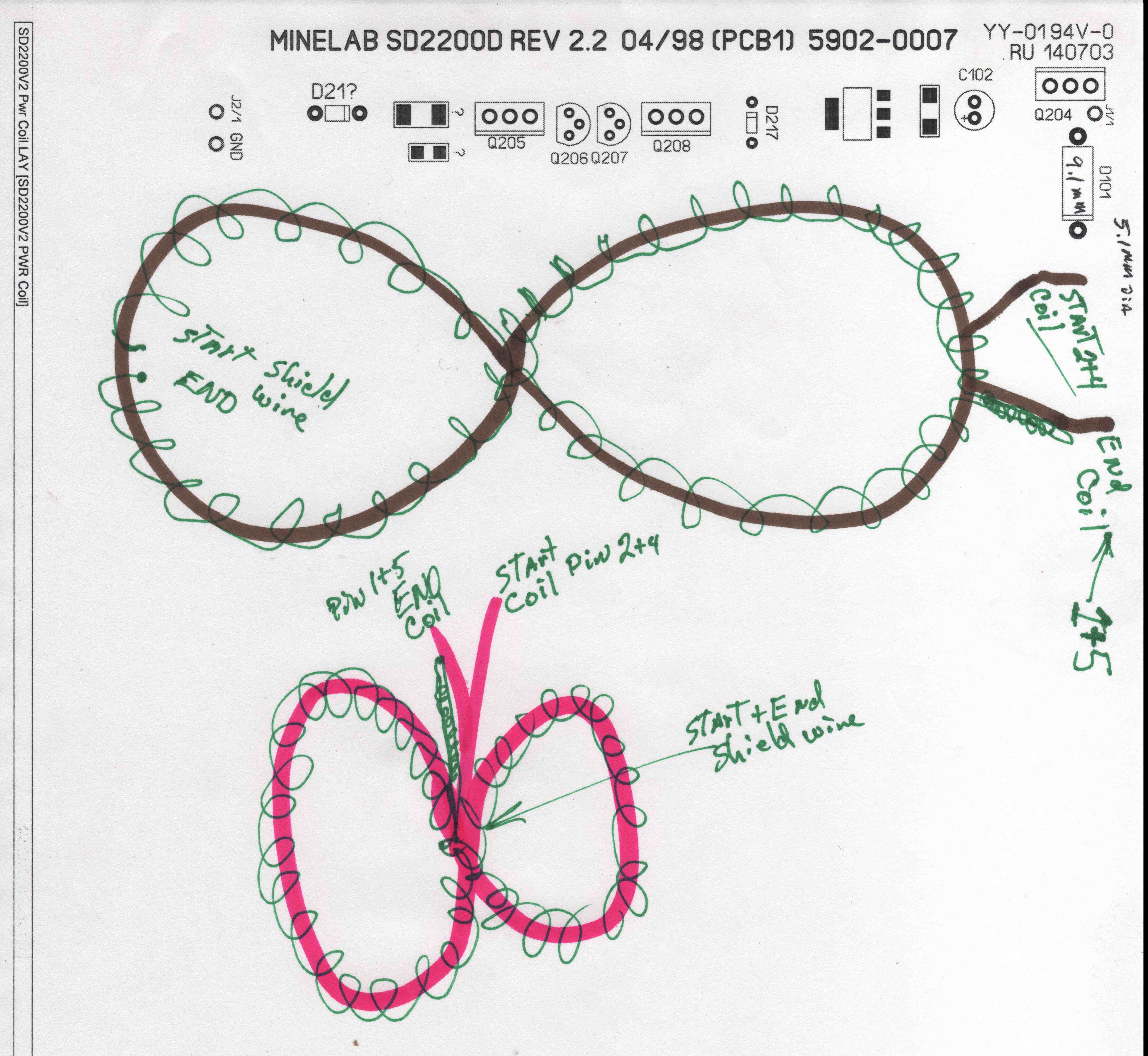

        I did some testing on the coil and found that it would pick up an US 25c coin at 16-18" (40-45cm). this was from center of both coil loops, But from the Cross over it registered ZIP.
        I'm thinking that maybe if the coil was Squished from the long side and the Coil Leads were made to exit at the crossover loop then you could build a MONO Antiference Coil????
        Anybody have any thoughts on that???

          G'day Bill,
          Well done on the coil, looks nice! The only thing I would have done different is to add some sort of spacer between the coil windings and shield as this reduces capacitance, making a faster coil. I used bubble wrap on mine, but normally people use spiral wrap of some sort, preferably made from a material with a low dielectric constant. But in saying that it seems to be working for you just fine.

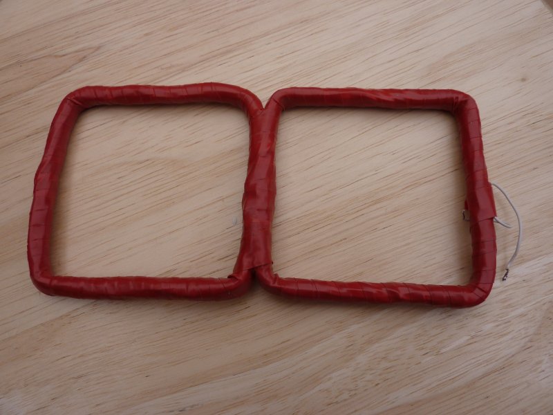

            Figure 8 coils are great for minimising interference. I was able to run a SD2200 quietly in a lab and close to a cellphone tower with one of these, whereas with a normal mono it was impossible. I prefer a double square version as you get a more intense field around the centre bar as it has double the conductors all the way across. Coins flat do give a double response with zilch in the middle. Coins on edge give a good response centred on the middle bar. A sphere gives a uniform response in any direction and peaks over the centre bar. For nugget hunting in noisy areas this is a good coil as nuggets are usually irregularly shaped and at any orientation. The coil in picture is a small one, but I have made them of all sizes up to 5ft x 2.5ft overall but with the bar in the long dimension. Good for towing on a sled or vehicle mounting broad side on to give great and fast ground coverage.
            Eric.

              I call these tanga string
              Concentration of current in a centre bar resembles a lot the DD coil middle section and pronounced sensitivity there.
                Mick, I figured that the Thick insulation of the speaker wire would offer some insulation to the shield wire. I know it isn't perfect but it's a good enough so I can get some work done on the bench.
                Eric, below is the pic of what I ment by squishing the coils, it's almost what you have done in your Square D (pun intended) Design. And Yes the paper I did the drawing on is my start of the sd2200v2 reverse engineer. Thats why I didn't want to make a NICE Picture, I'm tired of makeing SCALED drawings for tonight.

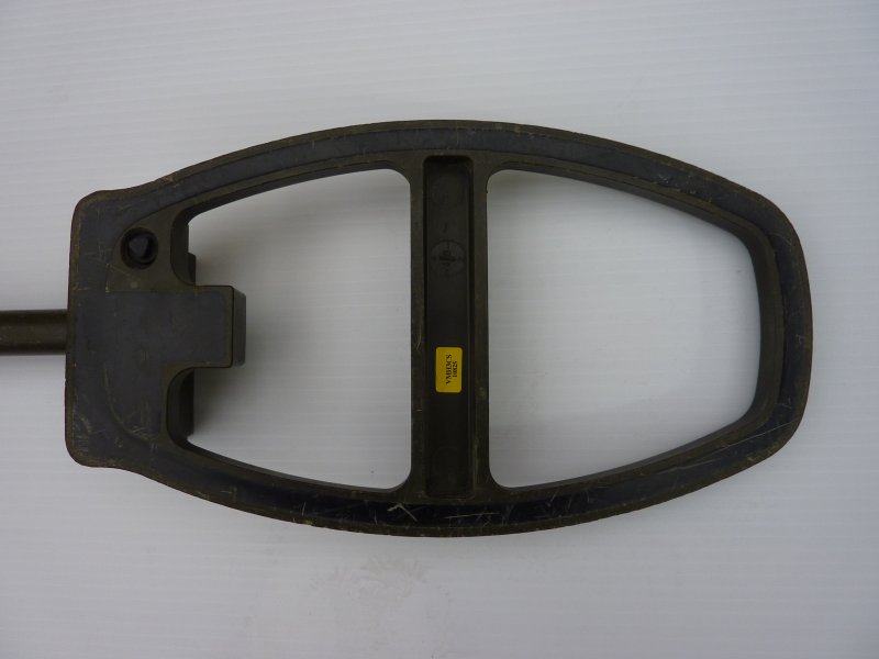

                  Picture is the underside of a Vallon PI mine detector coil. I thought these were figure 8 type, but when I got one on ebay it was just a straight mono. The crossbar is just for strengthening. I like the shape though, and it would look smart for a fig 8.
                  Eric.

                        I have a better pic of the 2200 cktbrd.
                        I'll send it to you if you want?
                        I have to put grid lines on it so we can reference the chip at A:1 on the board. A row would be at the top of the baord and 1 is the column #. Then the chip/s are referenced inside that Address. This chip # will also be used in a Spreadsheet with the Stock chip at the beginning of the row and the substitutions in the row after and then have breif comments at the end. I'll use the Landscape orentation so there is enough Columns to print on one sheet front and back.
                        I'm tired for now, last night I started to layout a grid in TurboCad Pro, but when I got it almost ready to set the lines, I noticed that it was a Mirrored Image like looking from underside the board in reverse, I just Killed It and was going to finish it today but spent all day Looking for a Monitor Cable, it was in the Last Place I looked(te he, always is). Got a bunch of other Sorting done also. AND I got a makeshift camera Jib arm mount made, so I can get directly over the top of the board, I'm playing with different light sources to get the tracks to standout when I'm Zoomed in on the full 4Mb images. Its hard to get enough light and still not get the glare and get the traces to stand out Clearly on the baord.
