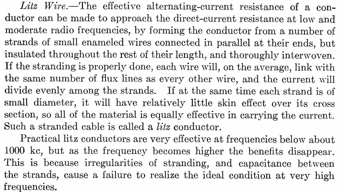

    Hey All;
    I found a nice explanation of Litz wire while searching for Litz core coax (no, I haven't found any). Anyway I thought I would post it for those who are curious:
    QUOTE:
    "If the strands are insulated (Litz wire) and frequency is increased, eventually we reach a point where the conductor resistance increases and we are much worse off than we would be with braided or stranded wire. The upper limit point is generally around 1 MHz for Litz wire.
    From Radio Engineering by Terman:
    In reality, the real advantage of Litz wire is NOT reduced resistance per unit length for a given diameter. The advantage is less slope in resistance with frequency and reduced eddy current when the conductor is in a multi-layer coil or transformer. The individual strands are like laminations in a transformer core, and below a certain frequency they greatly reduce eddy currents by decreasing the "short circuit" path distance for magnetic flux induced currents that are not in the normal current flow direction."
    END QUOTE
    I found this explanation interesting and thought I should pass it on.

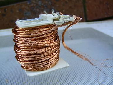

      Have photo's of the process if people are interested for me to post to experiment for yourself.
      Viewers could be interested in your photo's.
        ?? is Could be interested, but seems otherwise.
        Anyway, i have no idea what real Litz wire looks like as i have never had any or a disected M.L Coil to compare.
        Below is what i made into a 38 strand twisted wire. Not sure if it could be called Litz wire though??
        Cheers Sid
          If each wire is enamelled, in a somewhat broader definition this is a Litz. In a bit more narrow view, a Litz should be a braid that would interleave the wires, not just twist. For our purposes the most important feature is a cross section of each wire, as it is responsible for eddy current generation, so braided or twisted comes just about the same.

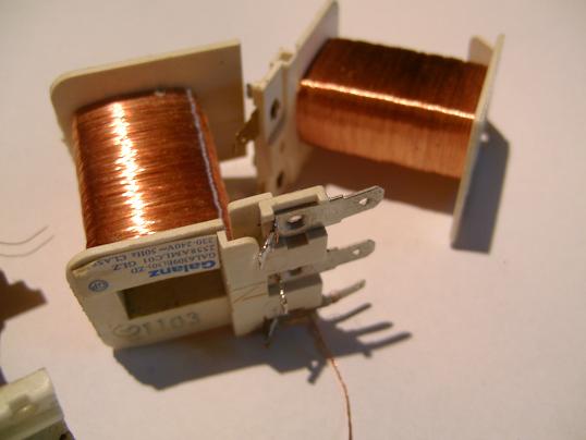

            Hi Davor, each wire is enamelled.
            The original wire is from 2 desected Microwave oven fan motors, see pic below.
            Supprised at how low Coil Resistance i am getting for a 6 inch, 160uh coil.
            BTW, Microwave ovens have that lovely large Capacitor inside them. Have desected one and removed the intercapacitive Mylar sheilding material. If anyone is thinking of doing the same, wear surgical gloves as the oil filled Capacitor is very messy and smelly, but the Mylar material can be stripped, cleaned and possibly used for shielding our coils. Have meters of this material from one capacitor to work with once cleaned of oil contaminants.
            Microwaves also have a large fast switching heavy duty diode that may be used in PI detectors.
            All this information above is in experimental stage, but so far i like domestic Microwaves, other than heating food.....and the good part is they are given out free. So if you see one lying out in the street gutter, consider the material available to us experimenters of Metal Detectors. Another positive, sell the rest as scrap metal (large mains copper wire transformer) and make another 5 dollars or so for your effort
            I like the outcome of the homemade Litz copper wire so far. It is time consuming to make. Wish i had only made it a bit longer for a Inductance of 300uH to compare with standard copper enamell coil to see if its worth all the trouble to make it.
            Cheers Sid
