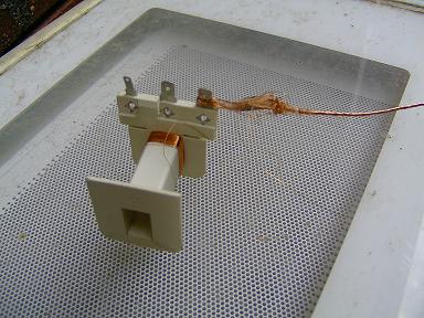

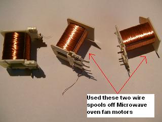

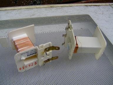

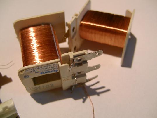

    Below is what i used as the wire. It is from Microwave oven fan motors which i removed the metal frame supporting the motor itself and used the copper wire as you see in the picture below. I used 2 of them in my experiment to get 38 strand wire with a combined length of 33 feet or there abouts.
    I will measure the wire size when i get my digital vernier working again once a fresh new battery is fitted.
    So far i achieved a 38 strand, 6 inch coil, 160uh, 0.2-0.3 ohms coil.
    Pretty good in my books.
    Cheers Sid

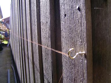

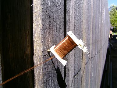

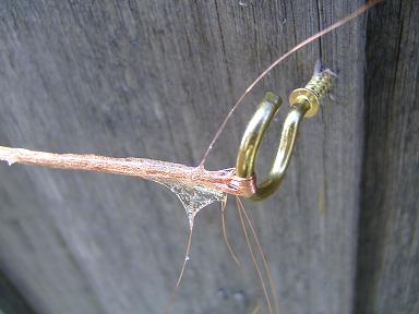

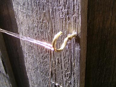

    The next step i had to consider was how to support each individual insulated strand of copper wire.
    So here was born the idea of supporting the wire on the fence boundary line at home. The longer the fence the more longer the wire that can be made.......but.......I have not experimented with it yet and may complicate things when it comes time to twist the wire in a bundle at such larger lengths....Who knows, some of you might know if already done. Only when its been experimented with, we will know, but i think it should be ok if you have someone else helping you out somewhere down the line.
    Using 4 hooks spaced out approximately every 9 feet as in the picture below.
    Start at one end and tie the knot hehe
    IMPORTANT: Please note that the wire is very fragile and can break. This is where most people may fail if the wire is mis-treated eg, applying to much pressure, over stretching it's breaking point and not taking your time, in other words go slow and not rush the wire build.
    It is time consuming. For me, it took me all up around 10 hours spaced out over 2 days. It took longer though for me because it was more difficult to unwind the copper wire off the rectangular wire spool i used (Microwave oven fan motor) than to place it on the hooks.
    HINT/TIP: If you do break a wire, remove it to the nearest previous end, tie it there.
    Then re-tie the spool wire there also and continue.
    Cheers Sid

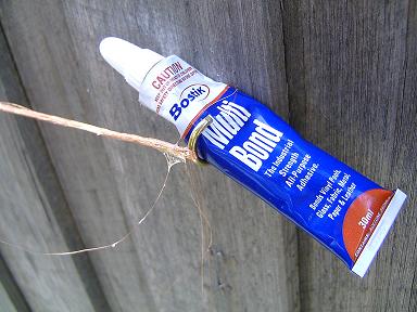

      The first thing you have to do though is glue each ends as shown in the pictures below.
      Allow enough time for the glue to dry........You are almost there.......... so kick back now and have a beer and marvell at your creation that is being created before your eyes.
      In saying this, one beer only as you could still stuff things up at this point
      Cheers Sid

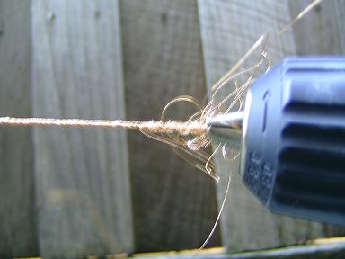

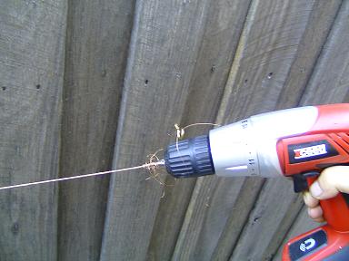

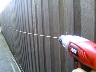

        Once glue is dry, its time to wind the wire up by using a drill. Much easier to use a cordless drill than a power drill and set the revolutions at low speed.
        Clamp one end of the wire on the drill chuck as shown in the pictures below.
        I used clockwise winding, i think.
        Begin to wind the wire at slow intervals and keep checking that it is winding ok.
        HINT/TIP: VERY IMPORTANT......There is a point where you have to stop or else the wire bundle will begin to twist in itself, so once you feel that the wire bundle is rigid (which you could do by observing that it is all neatly twisted).......DONT go any further or you will stuff it all up and it will be all a waist of time for you.
        If it does happen though, rewind anti-clockwise and hope that it unwinds itself and has not broken any strands.
        Note: when you wind the wire with the drill, the total length will become shorter by about a foot or so due to the winding.

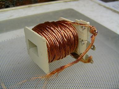

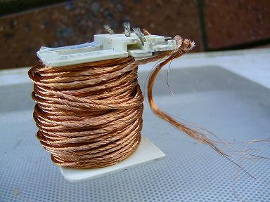

          Now its time to remove the wire from the drill chuck and wind it back on to a spool.
          See Pictures below.
          Now you have some coil building wire that was created by yourself which could be a benefit in your application. please post your results for all to see.

              Possibly not what you want to hear having spent 10 hours on it but.. I think technically speaking what you've created still isn't Litz wire. You needed to split the wire into several bundles and twist them together separately first. By twisting the whole lot together straight up some of the strands likely stay on the outside of the conductor for the full length while some stay in the middle, when they should alternate.
              From the wiki on Litz:
              Furthermore, the strands cannot occupy the same radial position in the bundle: the electromagnetic effects that cause the skin effect would still disrupt conduction. The bundle is constructed so the individual strands are on the outside of the bundle (and provides low resistance) for a time, but also reside in the interior of the bundle (where the EM field changes are the strongest and the resistance is higher). If each strand provides about the same average resistance, then each strand will contribute equally to the conduction of the entire cable. The weaving or twisting pattern of litz wire is designed so individual strands will reside for short intervals on the outside of cable and for short intervals on the inside of the cable. This allows the interior of the litz wire to contribute to the cable's conductivity.
              The benefit for a MD of true Litz over what you've created may well be very small though so I wouldn't stress, it would be interesting to see.

                Old school fine Litz is often woven or like a hair plaits.
                But some of the thicker modern litz appears spun like sids.
                The main thing is having multiple strands in parallel which are isolated from each other - connected only at the ends and Sid should have that. Watch out for twisting them up real tight though as the recycled enamel can fracture and get shorted turns. You dont want too much spiral wrap or it will have more L and R per unit length.

                        Thanks all for the feedback. Its experimental for now and seems to have a low R which was my initial aim.
                        I am sure some individual wires are twisted in/out of the whole length, so no individual wire is constantly twisted on the outside perimeter of the bundle or inside for that matter.
                        The size of the wire looks around the 0.1-0.2mm mark, but can only confirm when i use the digital vernier for accurate measuement.
                        Tepco, working with 0.05mm or even a more demanding 0.032mm as you suggest is beyond our practical capabilities.
                        Thanks for the tip in obtaining similar size wire from car ignition coil
                        Besides i will shield this coil and compare to a similar solid copper wire for comparison in a working PI.
