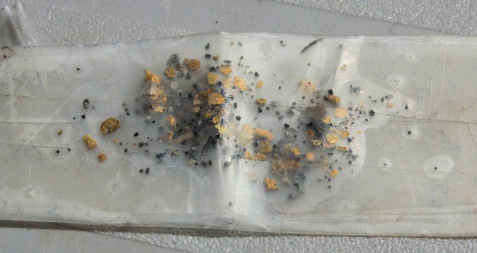

    This question concerns the coil detection pattern above and below the coil. I was bench testing a VLF coil today, using about 1/2 gram of flake gold (several pieces) secured between scotch tape. I attempted to detect the sample beneath the coil and could manage only very scratchy reaction, and that with the sample almost pressed against the coil. By accident, I passed the sample over the top of the coil and was surprised by a very sold hit. After several passes, up to around 5 inches, I continued to have this reaction. I again tried below the coil, with no reaction.
    Thinking I had a defective coil, I tried other items, gold chain, gold and silver rings, coins, pull-tab, etc. etc. and all gave good signals within the expected range.

      "Does this make sense?" Not in the slightest. The shielding of your coil could be different above the coil and below, eg. graphite-painted below, nothing above. That might be one explanation. Are you holding the test targets in your hand? If so, it's possibly your hand that's being picked up. Try blu-tacking the target to a plastic ruler or something similar, then wave it over the coil, so your hand is kept away.

        The best I could do was around 2". Strange. My test platform is within an urban setting, on a plastic yard table with no metal parts. The coil and machine are about 4 feet from the ground. There are no overhead transmission wires, and the Bliss was very quiet. The strange effect I had yesterday was that I was able to detect ABOVE the coil to around 5 inches. Whilst under the coil, the detecting range was within 1 inch.
        Today everything evened out and the detecting range was about 2" on either side of the coil.
        Obviously there was a variable yesterday which I missed.
