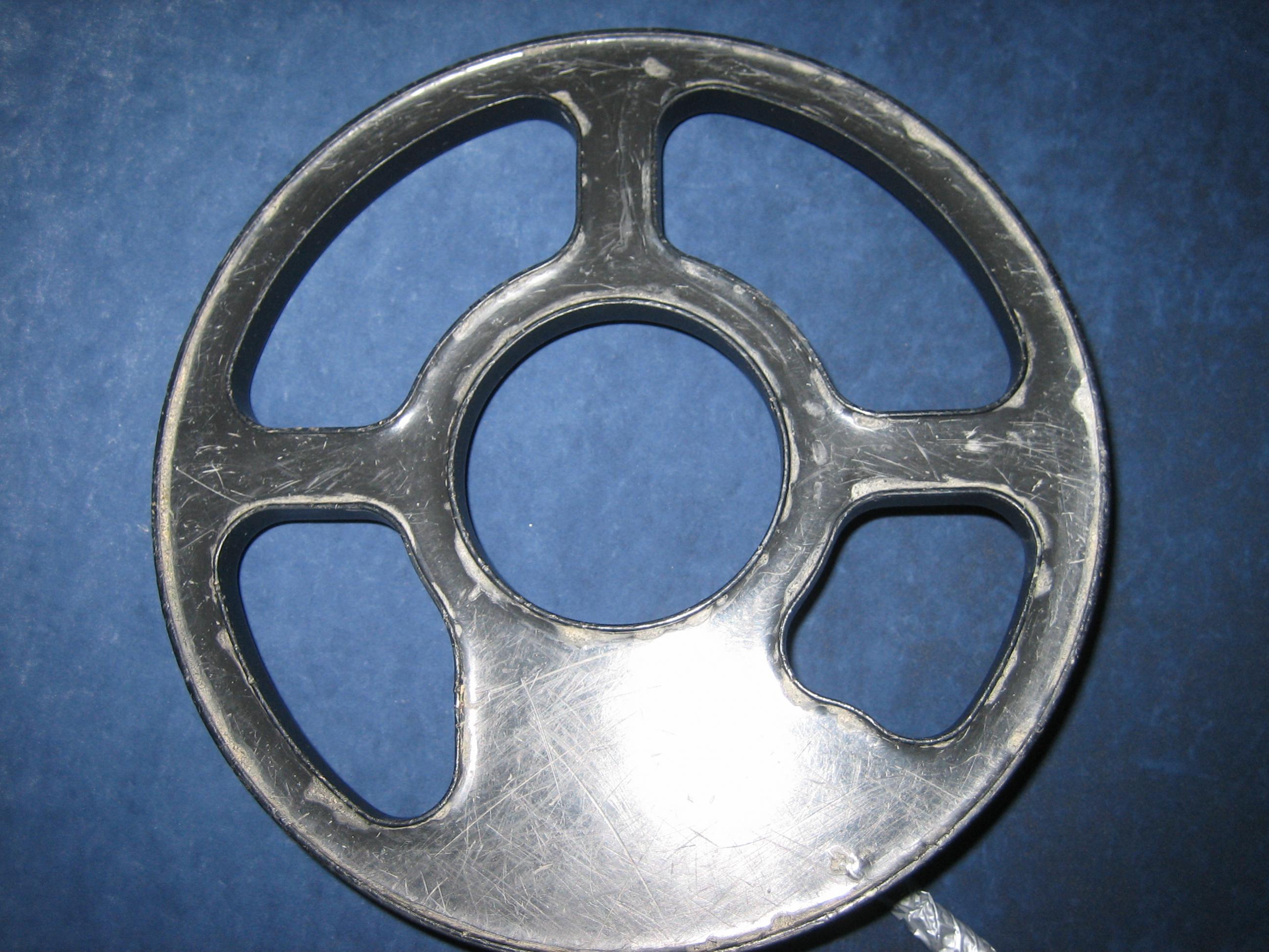

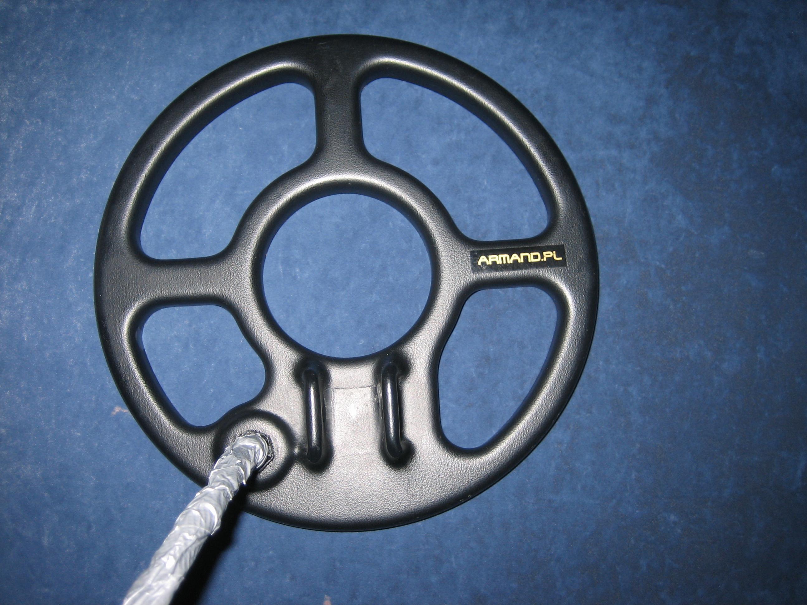

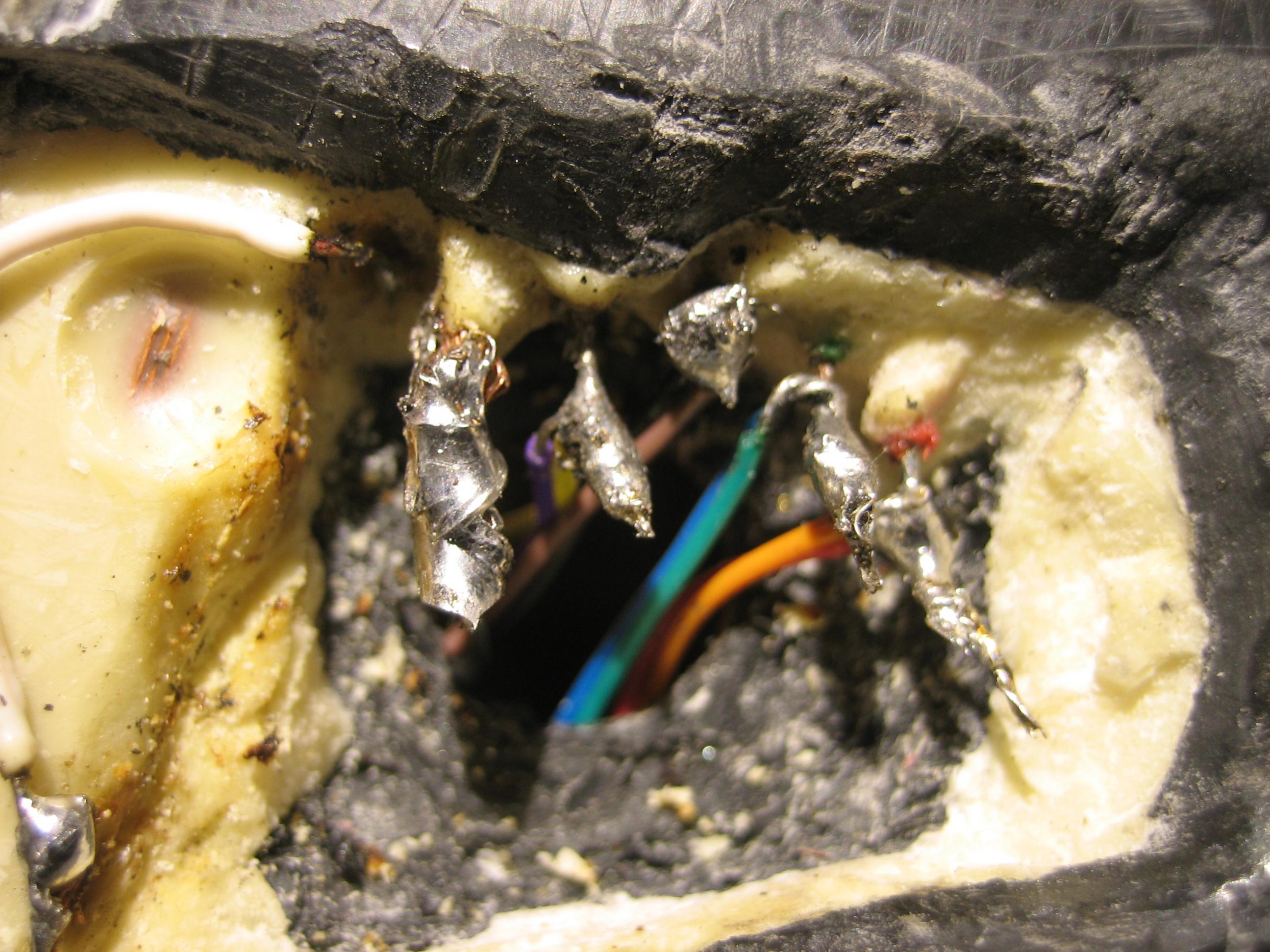

    Hello, I have a detector Armand Anticus(PL) .

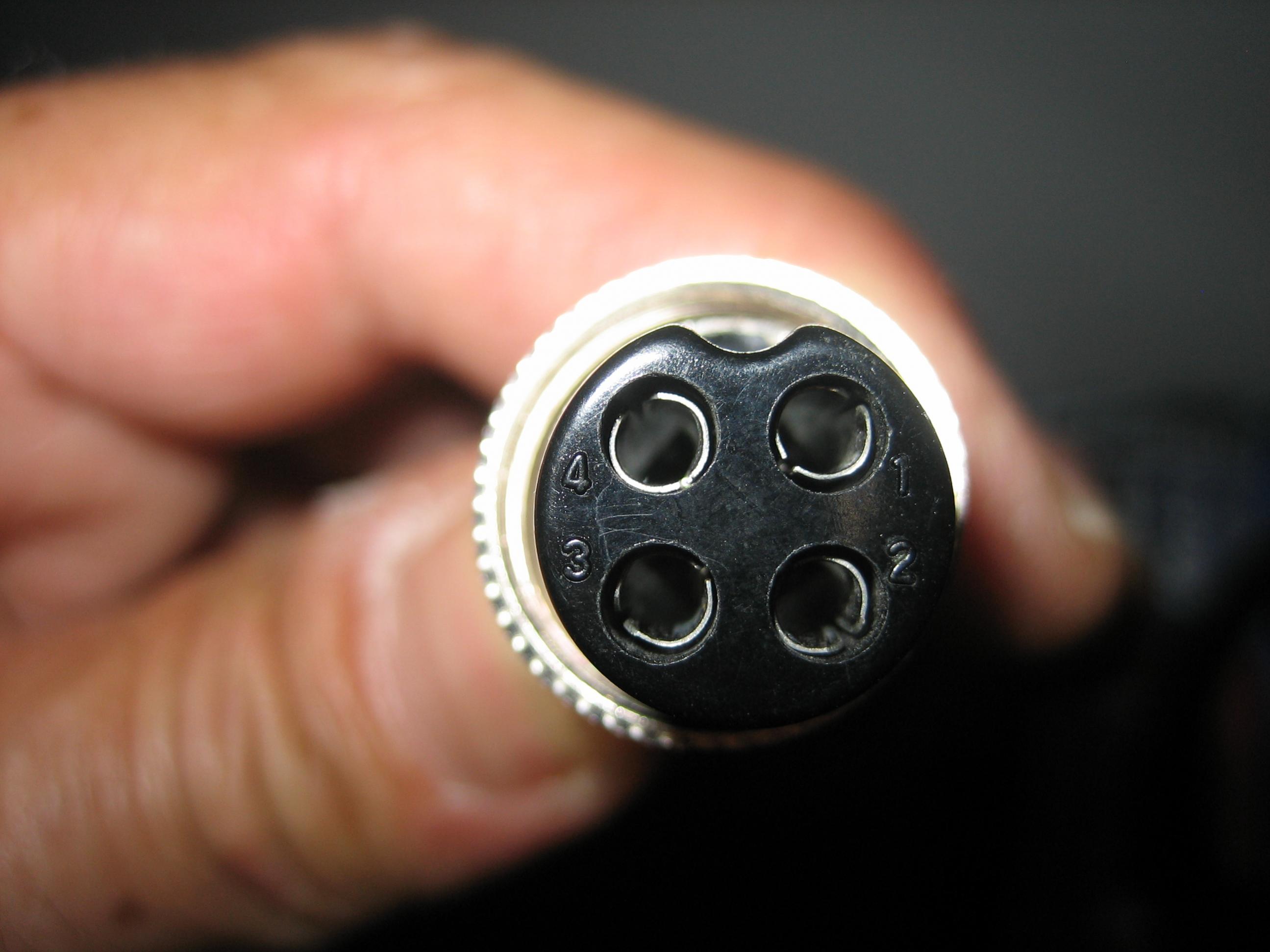

    The cable of disc is broken, there are 4 wires and mass, a red wire one green one black and one white and copper wire braid over all.
    A wire is disconnected in the coil near the gland.
    I do not have the frequency of the coil which is concentric dual o 21 cm in diameter, I just managed to measure the impedance of a coil is :15.5 ohms between red and green wire, the other coil is 35 ohm between black and white thread.
    Between black and mass 35.2 ohm between red and mass 15.4 ohm Click image for larger version

    No idea on the diameter of the wire used, the coils are a 20cm diameter and the small center is 9.5 cm.
    I would like to know the frequency of the coil and the wire used to try to remake another.
    Any help is welcome, thank you all.

      The manufacturer says 10khz and seller told me 7.8 khz, who believe?
      It always tells me not to use any wire to produce a new coil.
        The manufacturer should know the correct answer, unless you want to believe the salesman.
        Since you are able to measure the resistance of the coils, you should also be able to measure the inductance. The RX tuning cap is probably on the PCB, so have a look at that as well. Using the inductance and capacitance values, it will possible to get a close estimate of the working frequency. However, you'll still have a major job on your hands making a new coil for this not very common detector. You might be better off just buying a replacement.

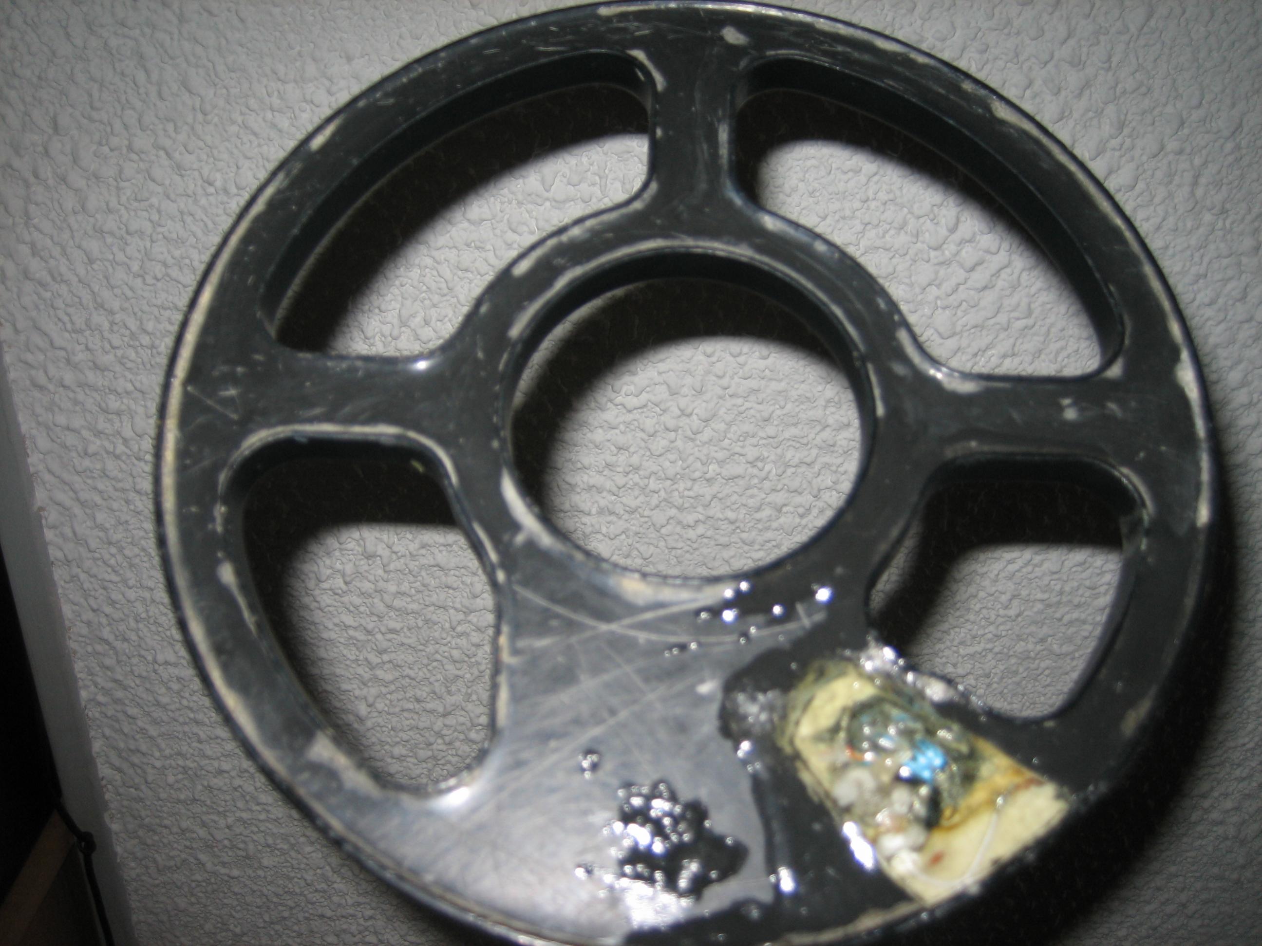

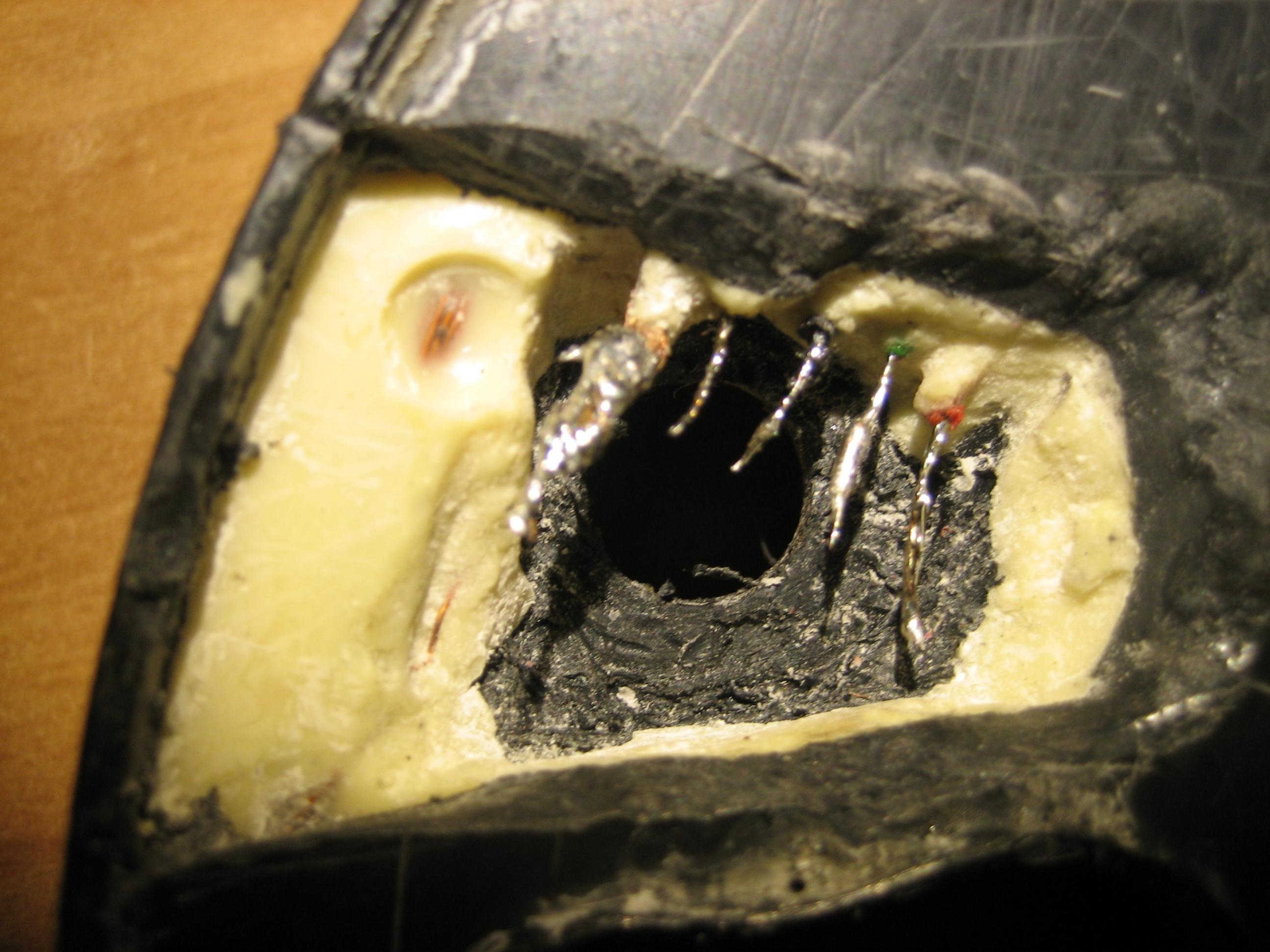

            I finally managed to fix my disc with a mini strawberry and a soldering iron.
            The work is long and difficult, but with nothing to lose I started, successful progression in pictures.Click image for larger version
ID:	336205Click image for larger version
ID:	336206Click image for larger version
ID:	336207Click image for larger version
              After some test it's works fine
