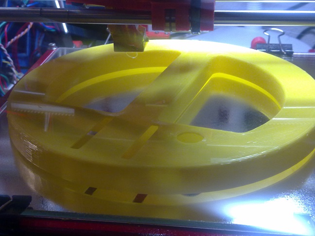

    Has anyone tried to produce a search coil housing using a 3D printer?
    What were the problems encountered? Weight? Porous? Easily damaged?
    Does anyone have any existing CAD drawings?

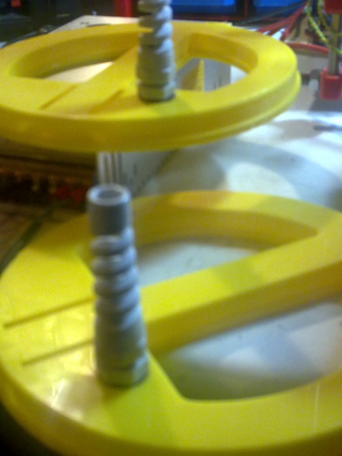

              Hi. No problem with abs.
              look this
ID:	336235Click image for larger version
                We use 3D printer models quite a bit. The wet-method produces pretty robust and tough models, often good enough for limited production. But they are pricey, and I still wouldn't trust them for a high-impact loop cover. Dry-method 3D is what most of the lower-cost printers use like RepRap and Z-Corp. The models I've made with this method tend to be more brittle.
                For loops I would definitely recommend vacuum-formed sheet plastic which is thinner, lighter, & stronger.
