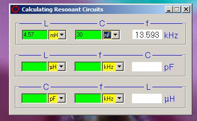

    We can calculate the working frequency of a coil with inductance of tx :4.57uh and rx:10.47uh , capacitor on oscilator 30nf, its possible or i need a scope.

      I get 429.83 Khz. Are you sure your inductance might be 4.57 mHY ????.....if so then the frequency would be 13.59 Khz. This doesn't count the parasitic capacitance introduced by your cable....which would lower the frequency a little.
                Originally posted by scs View Post
                [ATTACH]25218[/ATTACH]
                Excellent demo scs, on how a little practice check can replace thons of theories.
                  Sorry tx: 4.57mh and rx:10.47mh concentric coil double o, wire 0.3mm, capacitor on oscilator 30nf, MD with 9v battery, i've just mV meter. I want just the total frequency of the coil in Khz.
                  Many thanks for this good description i think that will be effectly 14Khz.
                  Regards.
