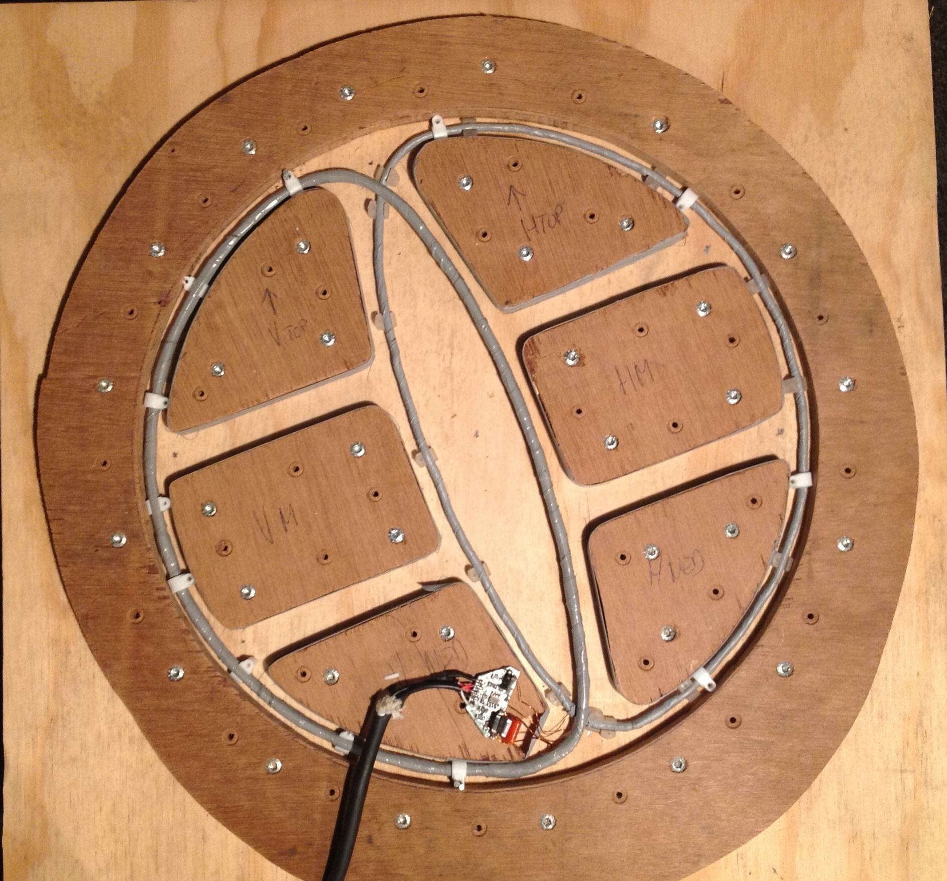

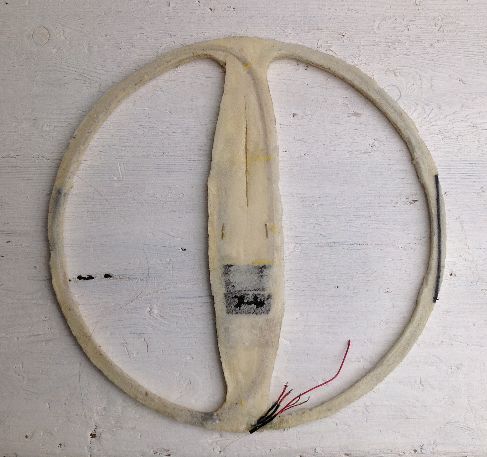

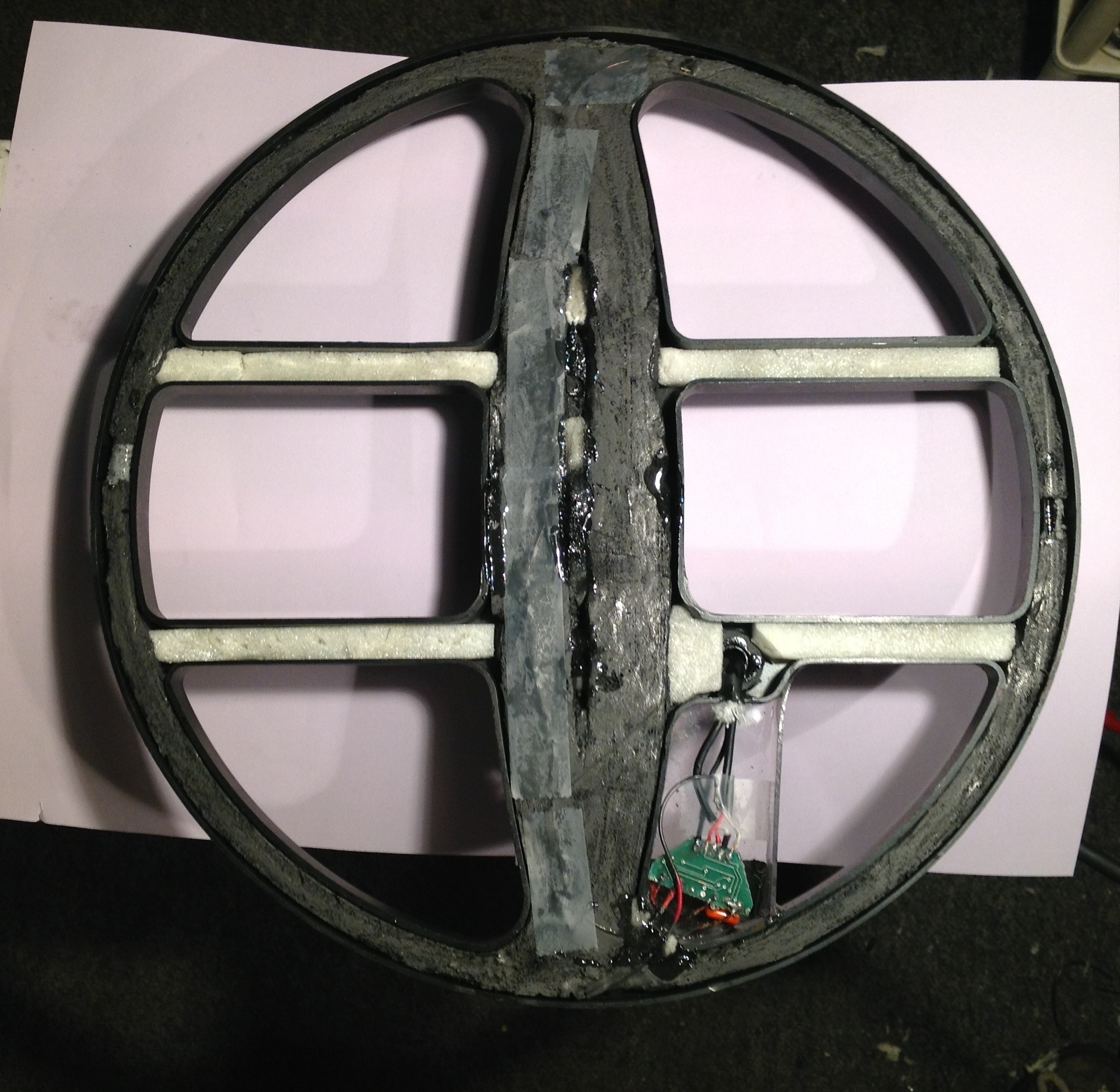

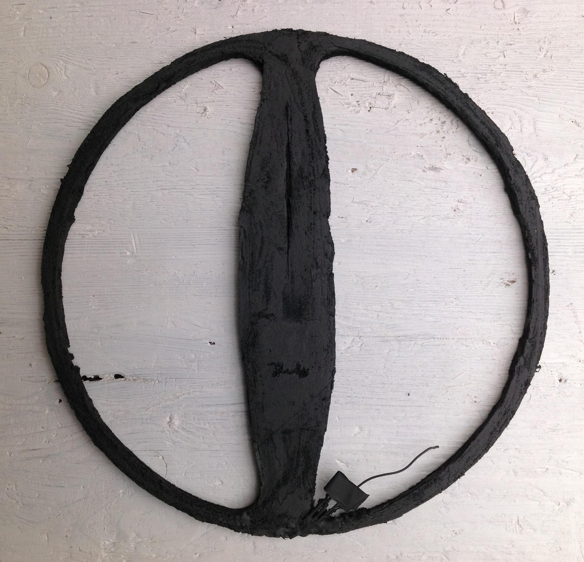

Never said it was easy to make you own coil... This is my no.3 try, this time a 13" / 25 khz ( Vista Gold ).
Here is some pictures how I did it this time. I gave up Sheilding in the shell and and molded coils into something Moldable Foam, so i could paint the Graphite spray and do the finetune, before the epoxy should close it up.
The good thing is that the total weight will low, because of using foam.
Henrik
