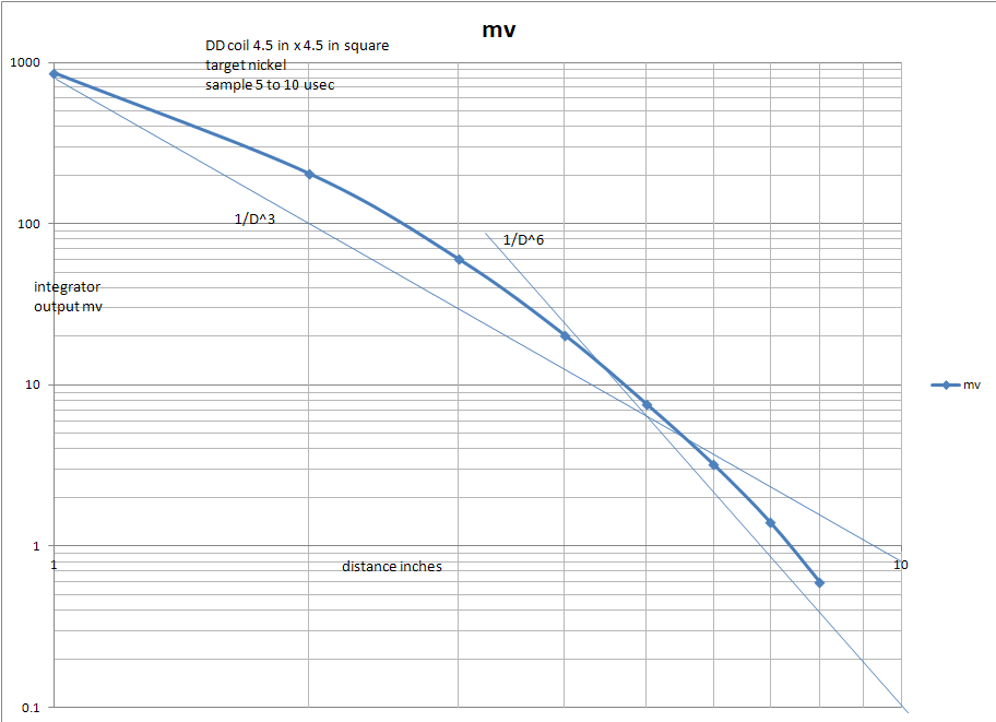

    I am trying to build a PI detector. I've been playing with a square DD coil, 4.5 x 4.5 inches. I started small to save wire while playing. I thought square might be easier to build. I'm including a graph. My questions are. Does the graph make sense? Would a round DD coil be more sensitive? Would some other shape be better? Would making the coil 10 or 15 inches change the answers?
    the voltage that is generated in the rx coil depends on the inductivity and the resistance of the coil, the target feedback (big- small, deep-low) and the power which comes from the tx
    so the graphic should make a sense
      Generally round works best in terms of inductive coupling efficiency. Build 2 identical round mono coils, then shape one into a square and do air depth comparisons.
      Round is also least susceptible to ground lift-off effects. That is, a OO coil (as used by Nexus) is best, a 00 coil (such as an SEF coil) is next best, and a DD coil is next to last. Only a double-square coil would be worse than a DD. A tight corner radius produces a field non-uniformity that creates lift-off.

        The rounded corner rectangular coil comes close to the round coil. But you have a combination of a small and large "round" coil.

          Seen from a practical point of view the eliptical DD is the best shape.
          Technically seen its like a ground scanning rod - with one sweep and a good DD coil its possible to scan with the complete coils lenght 30cm deep for coins -
          at its center region up to 40cm or more.
          45cm coil size x 3m sweep = ca. 1,5 square-meter searched ground per sweep (per second).
          Seen from the weight and that the front side of the coil better can penetrate bushes or handle ground with all kind of vegetables or stones
          the eliptical DD also is the best solution.
