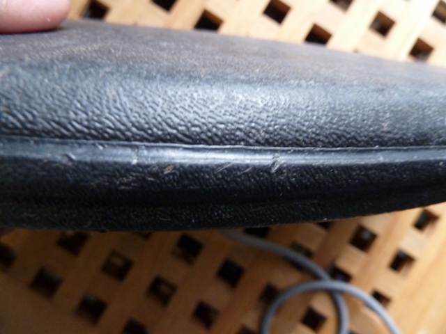

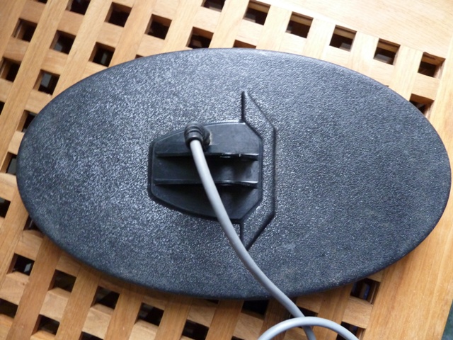

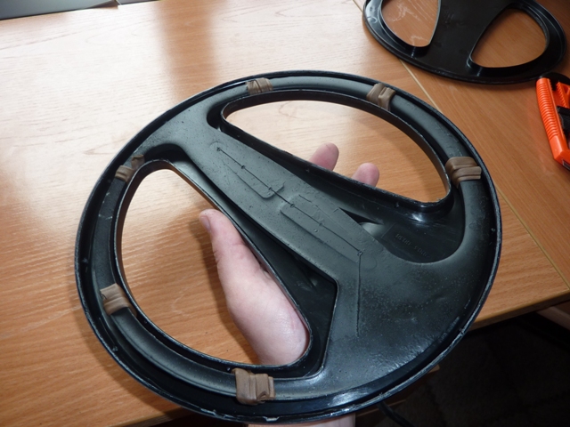

    Hi
    Is it possible to open this kind of coil? Without giving too much damage?
    With hot air maybe? Solvent?
    For your experience and information I am grateful!!
    All the best
    Dirk

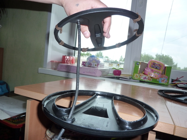

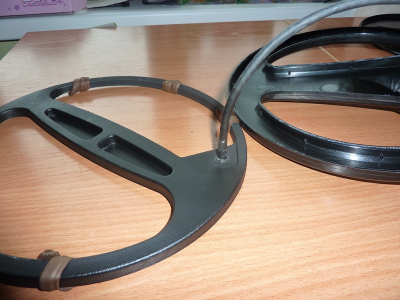

      try to insert a knife in glue juncture and go by it around.
        depends on what the joint is, if its friction(ultrasonic) weld then dremel, if its just a sealant try picking at it and see if it peels off

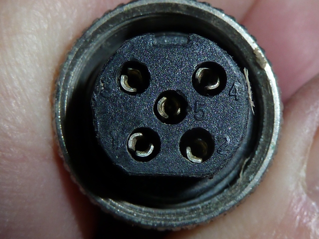

                It's a coil from a Whites MXT. I measured the pins with a continuity tester. Only conduct 2 pins. (Pin 4+5)
                  - no preamp
                  - no resonance capacitor(s) in TX
                  - may be serial resistor and parallel capacitor in RX
                    a data on coils shared out by C. Moreland.
                    Winding, followed by pins (pos,neg), followed by inductance, and finally DC resistance.
                    White's DFX concentric
                    Rx 1,2 13.8mH 36 ohms
                    Tx 4,5 540uH 2.7 ohms

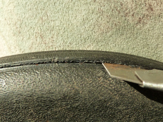

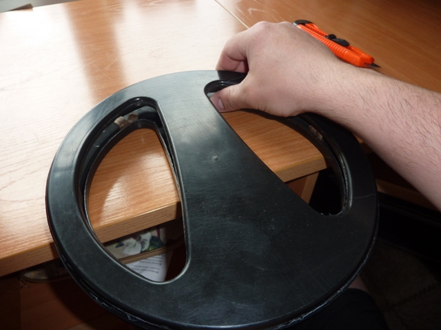

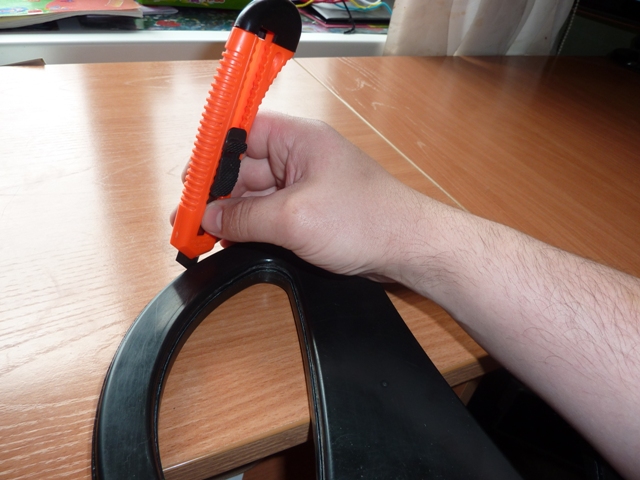

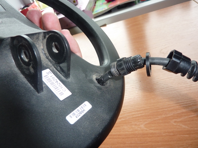

                        Take a carton cutter (stiff razor knife) and carefully cut into the seam. Once you get it started, it is easy to run it around the seam and split it open.

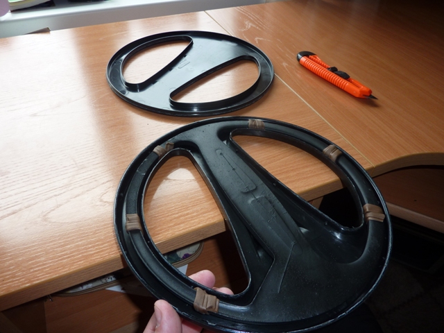

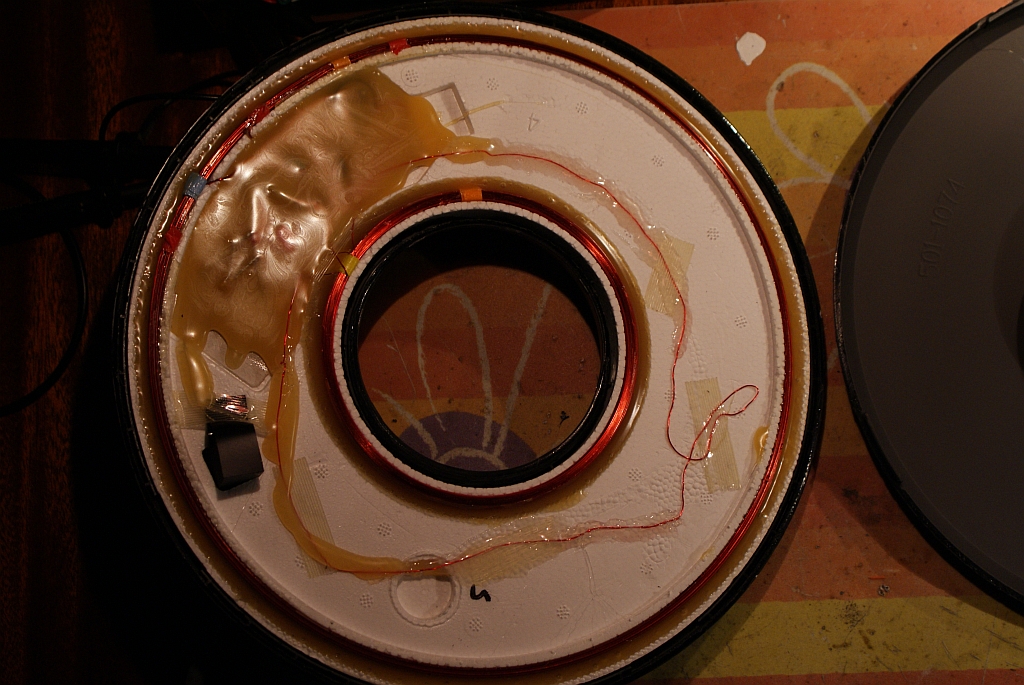

                            Coil is open!
                            Thanks for the hints!
                            With knife the coil was good to open.

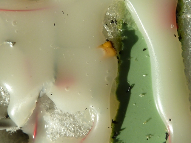

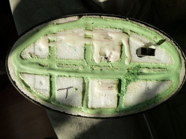

                            But what now? Hard to believe that a wire to be broken here ....

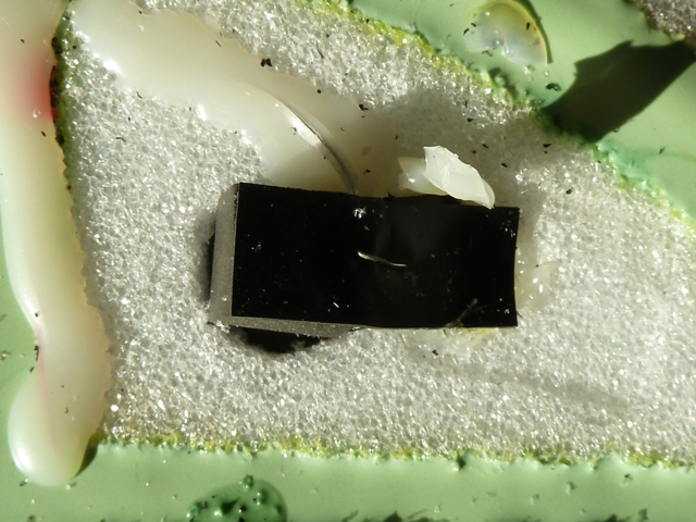

                            I can see a capacitor.
                            Also, as the screen is made ​​- interesting!
                            I will try to get at the port. Maybe I can repair that thing again.
                            Or at least I can use as a test coil. (for Rhaptor project ... or maybe Silver Dogs TGSL kit)
                            Dirk

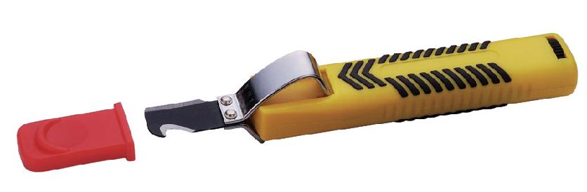

                              As "knife opener" I usually use this cable stripping tool (is not as breakable as "olfa" utility knife):
