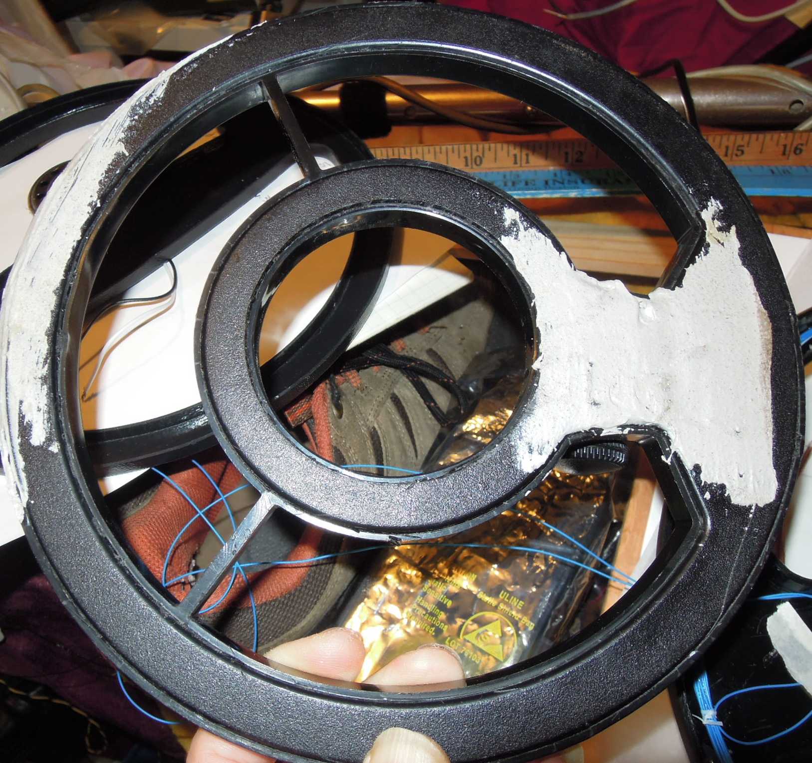

                      I used some 2 part epoxy in a caulking gun type cartridge I got for $5 locally it worked good but was really heavy
                      and a bit thick so might have bubbles in it (didn't sink into the hollow ears).

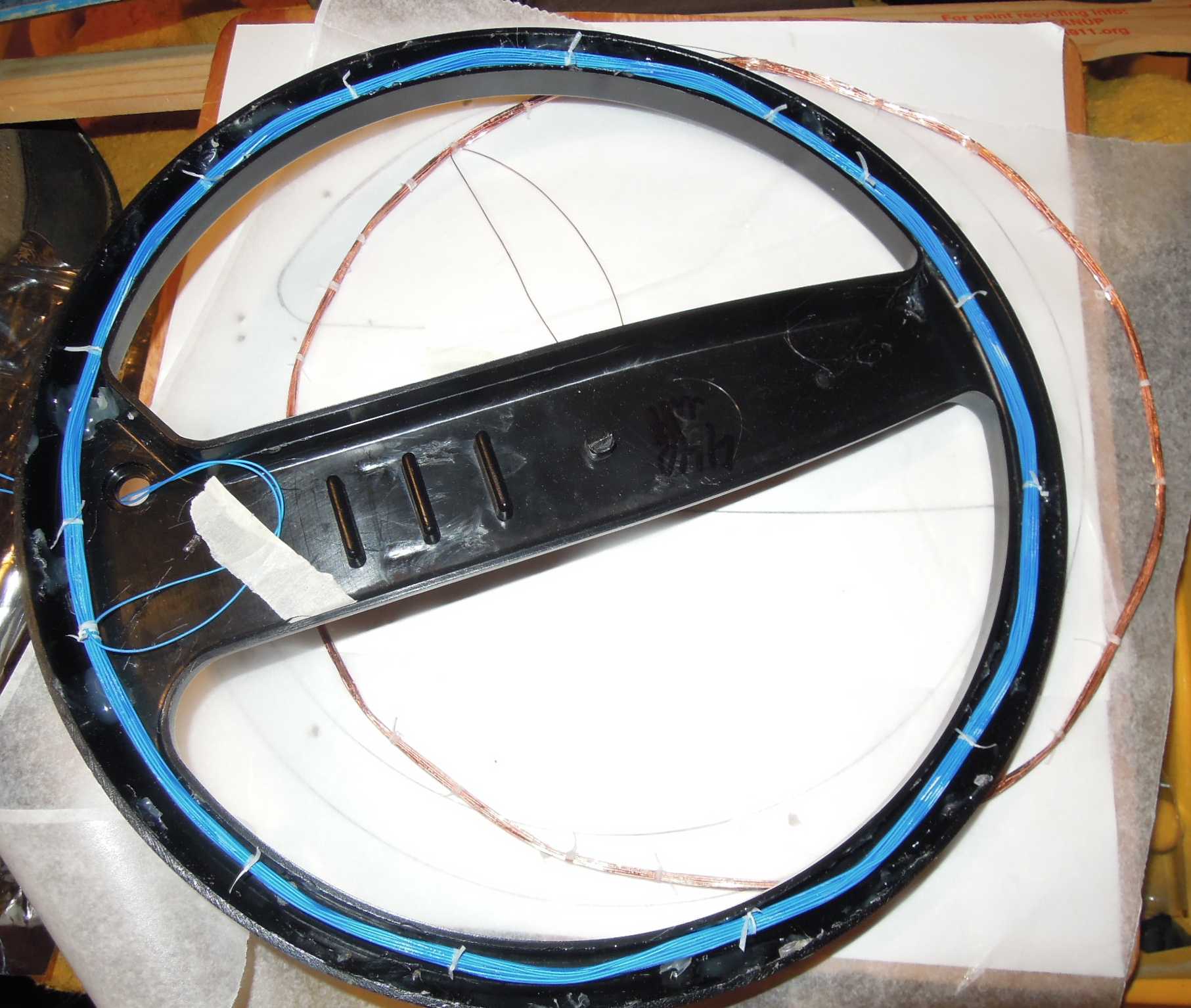

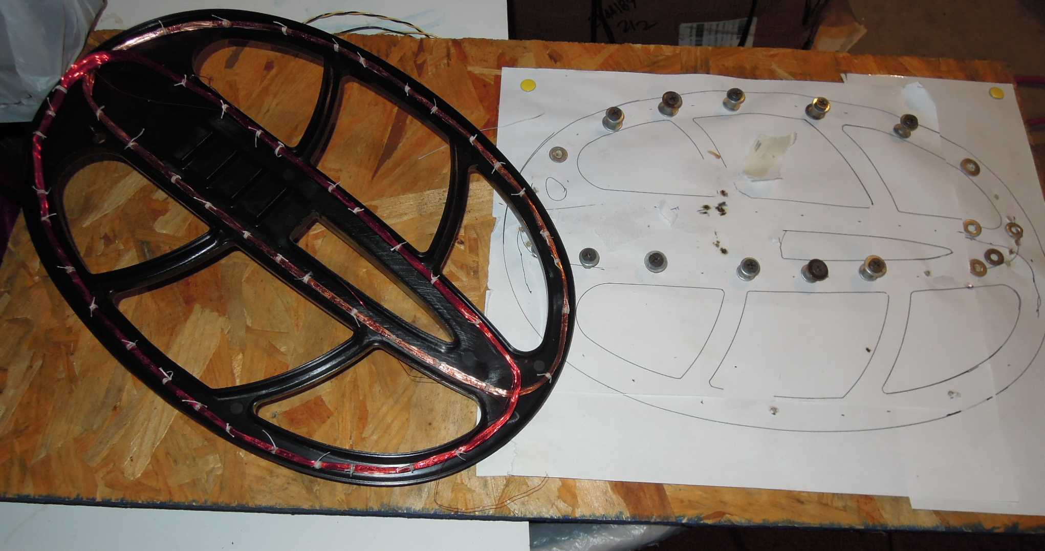

                      I have several coils I am just about ready to pot but not sure what to use...

                        Hello,
                        For US http://www.newark.com/
                        Polyurethane resin for 1131 grs / 20€ / http://fr.farnell.com/robnor/el171c-...131g/dp/725985
                        Polyurethane resin for 566 grs / 12€ / http://fr.farnell.com/robnor/el171c-...566g/dp/725973
                        The mix is clean because you mixed in the same bag the 2 components.
                          That's something they should make in China and sell it for $10. Newark has some for $30 + Shipping.
                          I was looking for a cheaper alternative...I guess my $5 concrete patch plus some $7 microballons
                          will have to do it...

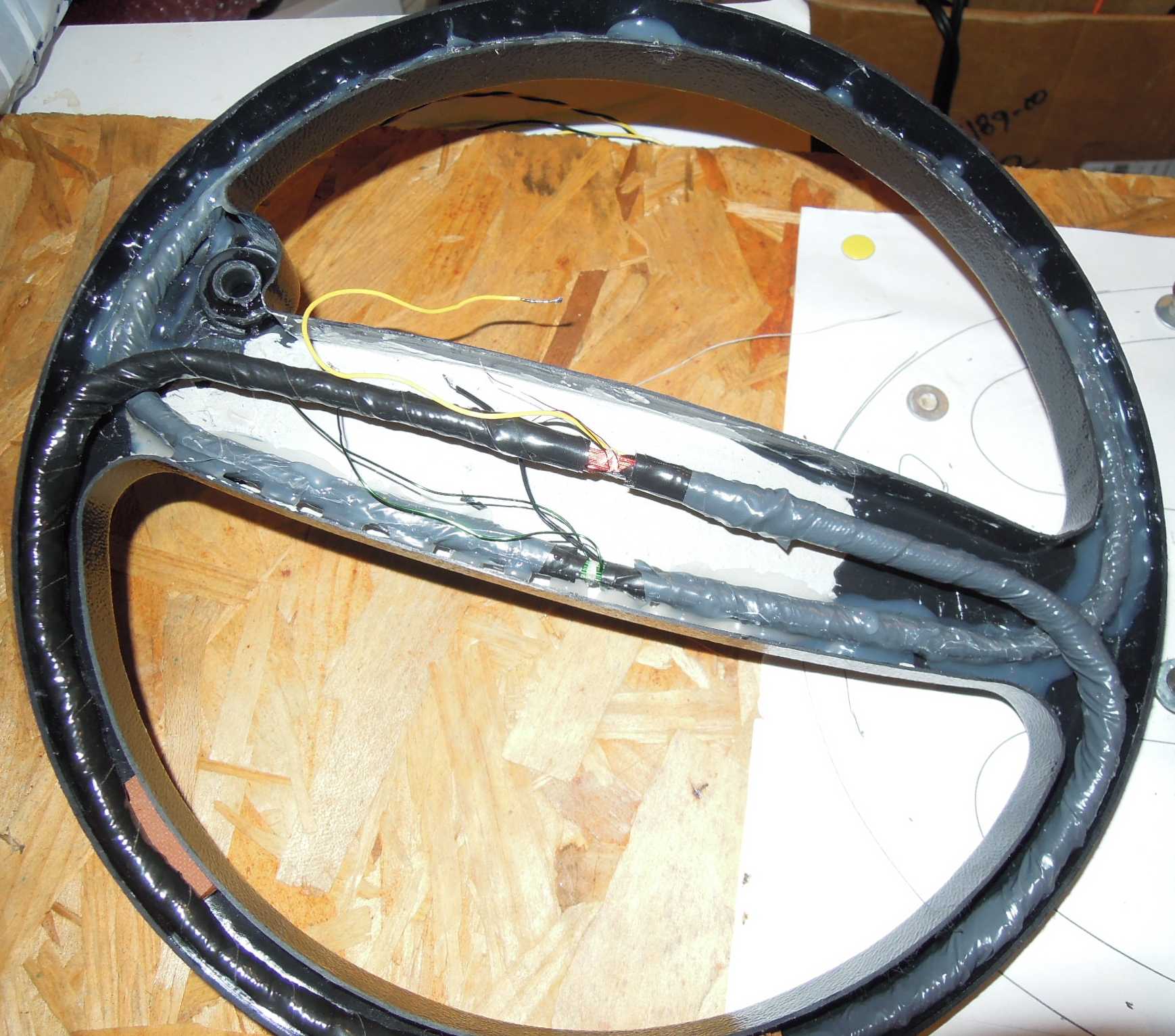

                            for my mono coils i tack the loop in with hot glue small blobs well spaced, then cover the loop in just enough epoxy to hold it then i seal the coil and fill the shell with expanding foam through a small hole drilled in the shell, it will grow worms out of any gaps and just trim those off, you can put a little silicon where the worm grew as some foam will soak up water but most dont, and you need the stuff that is creamy white when dry, the yellow brown stuff contains iron oxide powder.
                            its no good if you dive or need it neutrally bouyant, but if you like it as light as possible for general beach or land use is great.
                            i have made 2 vlf coils but as yet not potted them up, but in theory as long as they are nulled and cannot move while it sets i cant see any reason why it wont work there too.
                            p.s. its very important that you seal up the shell, ideally the only holes should be your fill hole and the cable exit, i have filled the cable exit with epoxy and reassembled the pigstail while its wet, give it 20 mins to harden then fill with foam and it worked, but if its not sealed it will make a right old mess.
                              MG Chemicals 832B is what you want. It will only make a 10.5 and a 7" round coil, if you use every little drop, no waste.
                              Depending upon how many coils your going to make, buy the 3 liter bottle 832B-3L, it will cost you a lot less in the long run.
