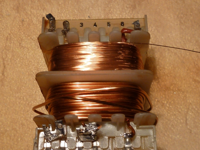

    I would like to make a DD coil myself (for TGSL).
    Now there are various recommendations here in the forum ...
    I'm interested in the thickness of the wire is to be used. In other words: How thin can be a wire?
    I have old transformers. I would like to use the wire. The Wire thickness I measured: is 0.14 mm. The wire is too thin? Maybe too much resistance? Is it important with coils for VLF detectors?
    Thanks for hints!
    Dirk

    You'll find a recipe for building a TGSL coil, and if you want to use thinner wire for Tx you'll have to make a multi-strand wire of the thinner wires. Tx is critical because if your coil has more resistance the coil Q-factor will be lower, the oscillator will have problems starting, perhaps the amplitude will not reach maximum, and it will suck more current. For Rx of a TGSL you can use even thinner wire than that with no problem.
      Thanks for the valuable information. I opened an old broken MXT coil some time ago. Now I understand why in the old defective coil, one "D" is wound with thicker wire and the other "D" is wound with thinner wire.
      Then I can at least RX - wrap coil with the thin wire.
      Dirk
        Ideally both wires would be made as litz wires, as a perpendicular cross section is very small, and eddy currents are much smaller. So in case you have no problems making a multistrand thick wire - that's even better than a single strand thick wire.

              Sometimes is mistaken man ...... The wire is thicker than I first thought. I do not have a digital caliper. The first time it was a reading error. The right measurement is 0.24 mm.
              Is this wire size well suited for self-made coils of Silver Dogs TGSL kit?

                A good coil will have inductance and resistance close to the original. Lower resistance is better, but such a coil is heavier. Balance is a matter of geometry.
