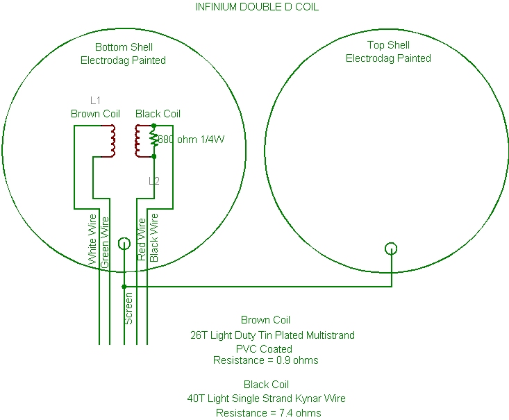

      PI detector with DD coil - Garrett Infinum LS has a damping resistor on RX coil inside coil housing - 680 Ohm.

      May be it is placed in Infinum because coil is not balanced well.
      To be sure it is good idea to check with oscilloscope signal shape after preamp.
      Also strong signals from bad ground or big target may create oscillations (ringing) in RX. Why not?
      So I vote for using damping resistor on RX.

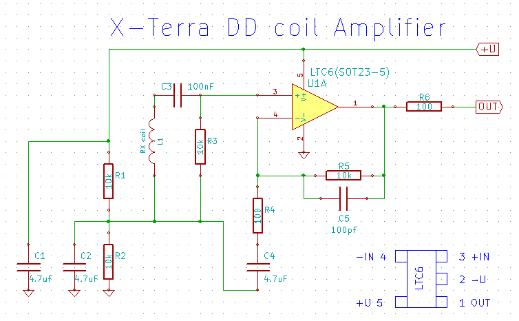

      How about to add preamplifier in coil housing (Minelab style)?

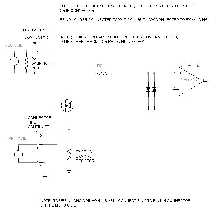

          Hi drbean,

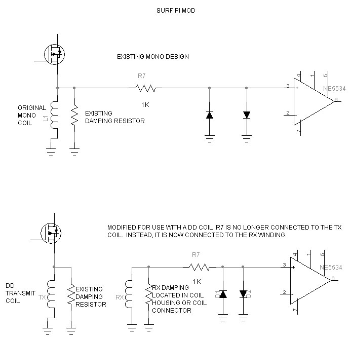

          I am not sure what you want or which Surf PI you have since there are more than one pc boards to chose from. So, drawing a diagram could get confusing. Instead, I will give you specific instructions which should be clear enough.
          Now, regardless of which pc board you have, you have to disconnect the transmit from the receive. In this case, if you look at the preamp (the 5534) you will see a 1k resistor connected to pin 3 of the opamp. The other end of this 1k resistor connects to the transmit transistor. This 1k resistor is the connection between the transmit and the receive.
          So, you have to disconnect the end of this 1K where it connects to the transmit transistor by unsoldering it and then bend the resistor in the air, so only the end connected to the 5534 is still connected. You could try to find some open area on the pc board and drill a hole. Then you could bend the resistor such that the open end fits in the new hole. This end that is still free but now in a hole can then be connected to the receive winding of the dd coil.
          Now, as mentioned, one wire on the receive winding will connect to the open end of this 1k resistor. If you are going to use any Minelab compatible DD coil, you will need a coil connector compatible which you will mount on the control box. Once that is done, you will connect pin 2 on this connector to this open end of the 1K resistor. Pin 4 of the connector will connect to the hole left when you removed the 1k resistor from the pc board. Pins 1 and 5 of the connector will connect to ground connection on the pc board.
          So, when done, pin 2 of the new added connector is connected to the open end of the 1K resistor. This connects the receive winding to the preamp. Pin 4 of the added connecter connects the transmit winding to the detector. Pins 1 and 5 are the grounds needed to complete the coil wiring.
          Once this simple change is made you should be able to use a DD coil. If you decide to build or use a mono coil again, you will have to make sure pin 2 and pin 4 are connected on the coil plug. This jumper will reconnect the transmit and the receive. On a ML compatible mono coil, this connection is already made in the plug.

                                Here are a couple of simplified pics of what needs to be done. One is basically showing R7 has to be disconnected from the transmit circuitry and then the open end of R7 has to be connected to the receive winding.
                                The other pic shows the layout if a Minelab connector is used so you can use ML compatible DD coils. Keep in mind that there is a damping resistor inside the ML compatible coils across the receive winding.Click image for larger version
