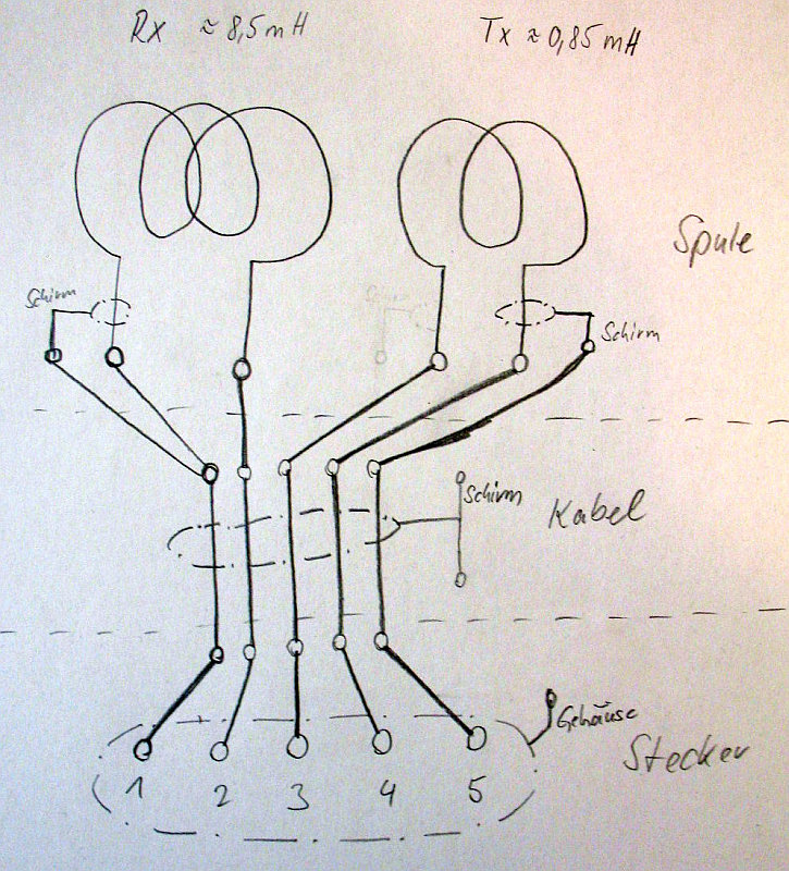

                          Hi Bernte_One,
                          could you check, if my sketch is so o.K.? I am not shure how to connect the shields of the coils, connectorcase and the cable. What about Pin 5?
                          (Schirm=shield, Kabel = cable, Stecker = connector, Gehäuse = shell or case, Spule = coil)
                            hello
                            the whole shield from coil
                            coil shell
                            tx part
                            rx part
                            goes over the cable to pin 1 (should be rx gnd)
                            pin 5 is only shield from electronic box which goes over the coil cable shield down to coil
                            but it seems at my clone coil not connected on shielding coil shell (but makes sense for me)
                            so you get a full shield
                            i suppose at one point the pcb board is connected to shield from e box too

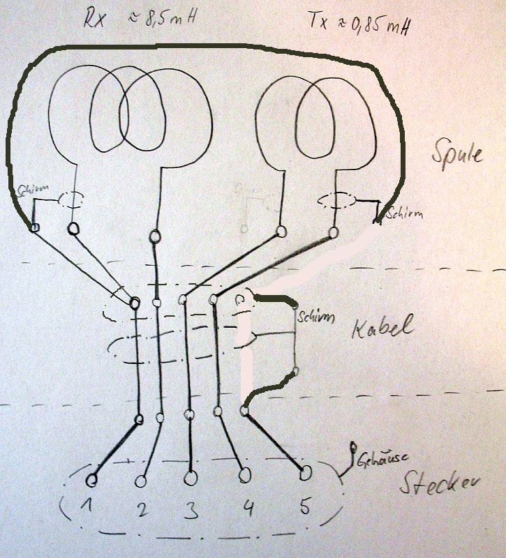

                              What surprises me is that the shield of the coil goes to the receiver coil, would rather expect to pass the interference to the transmitter coil to keep the receiver coil trouble-free.
                              According to your description this plan should fit:
                                plan2 looks good
