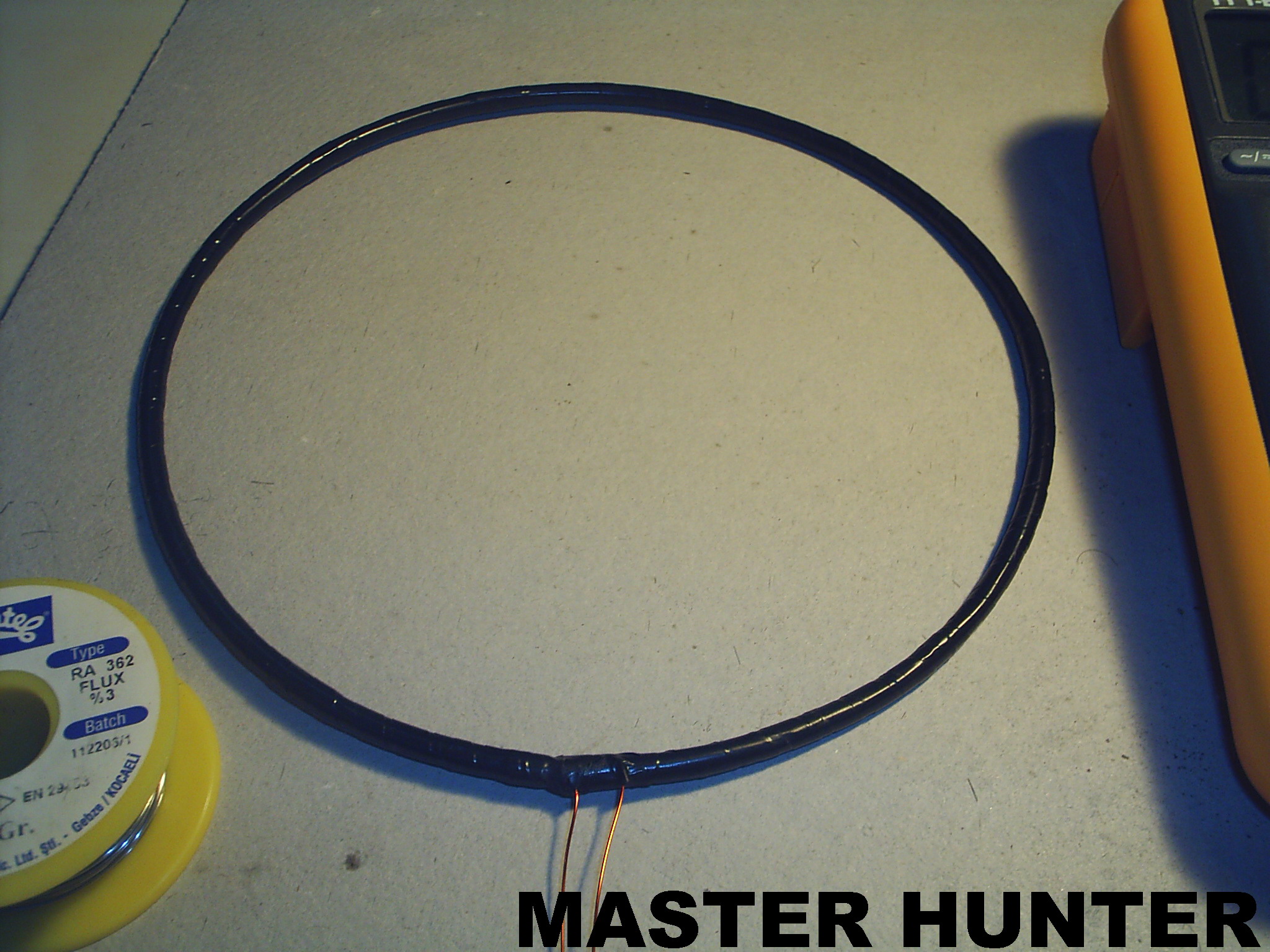

    Hi everyone,
    I posted this in another section of this forum, and it occurred to me that here is the right place to ask for help concerning my issue
    My asking is this:
    would anyone, please, give me some help concerning the coil for Golden Scan 5 ?
    I mean where can I find its specifications: its diameter, the thickness and quality of the wires involved, and the number of the wire turns..etc
    Please help me and be sure that I'm
    thankful in advance to any reply

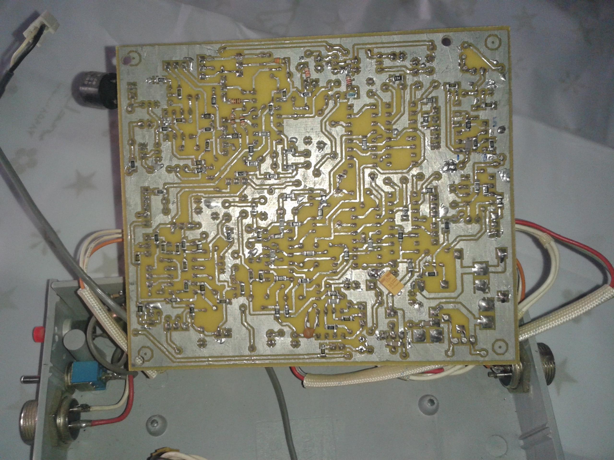

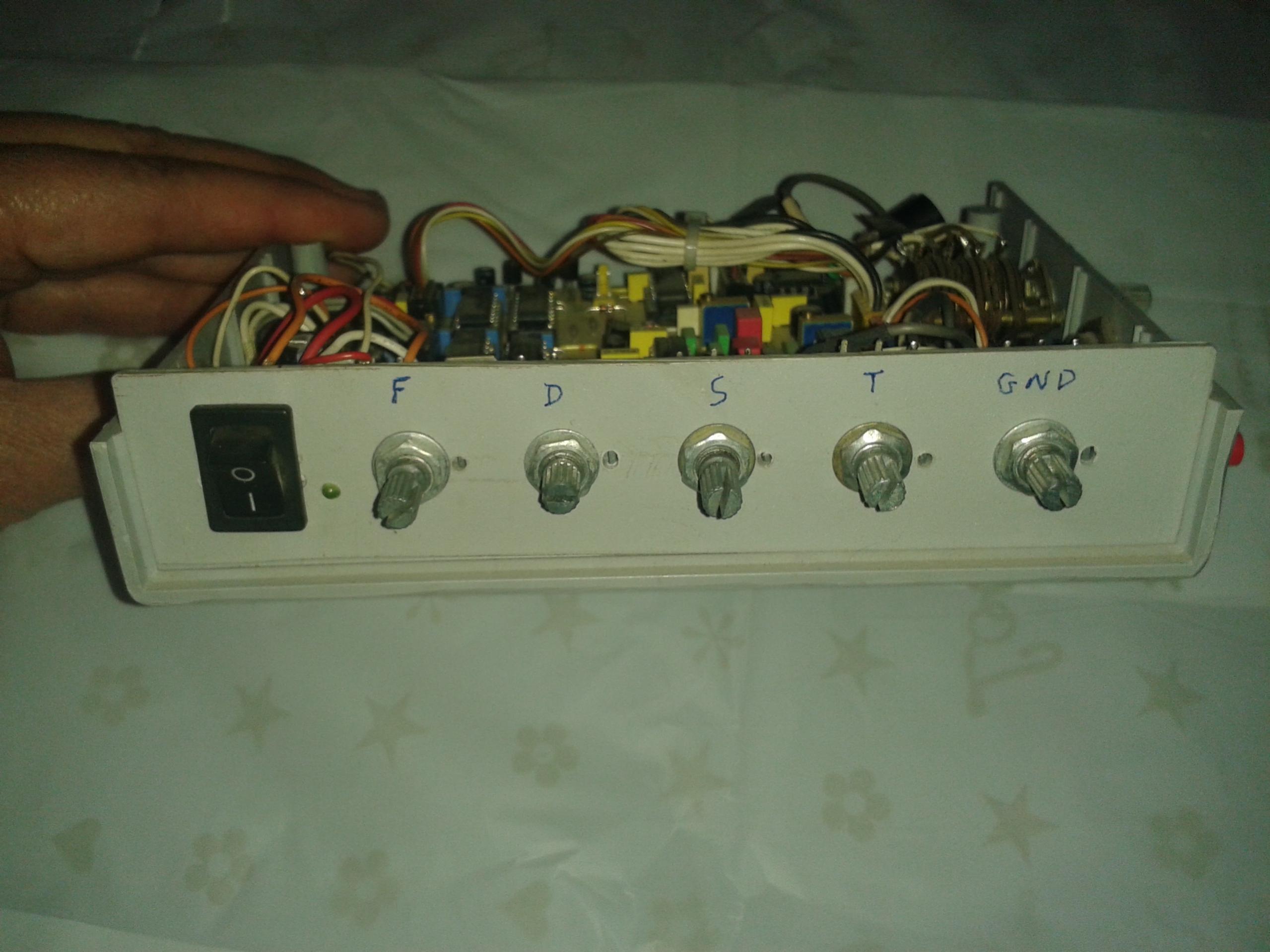

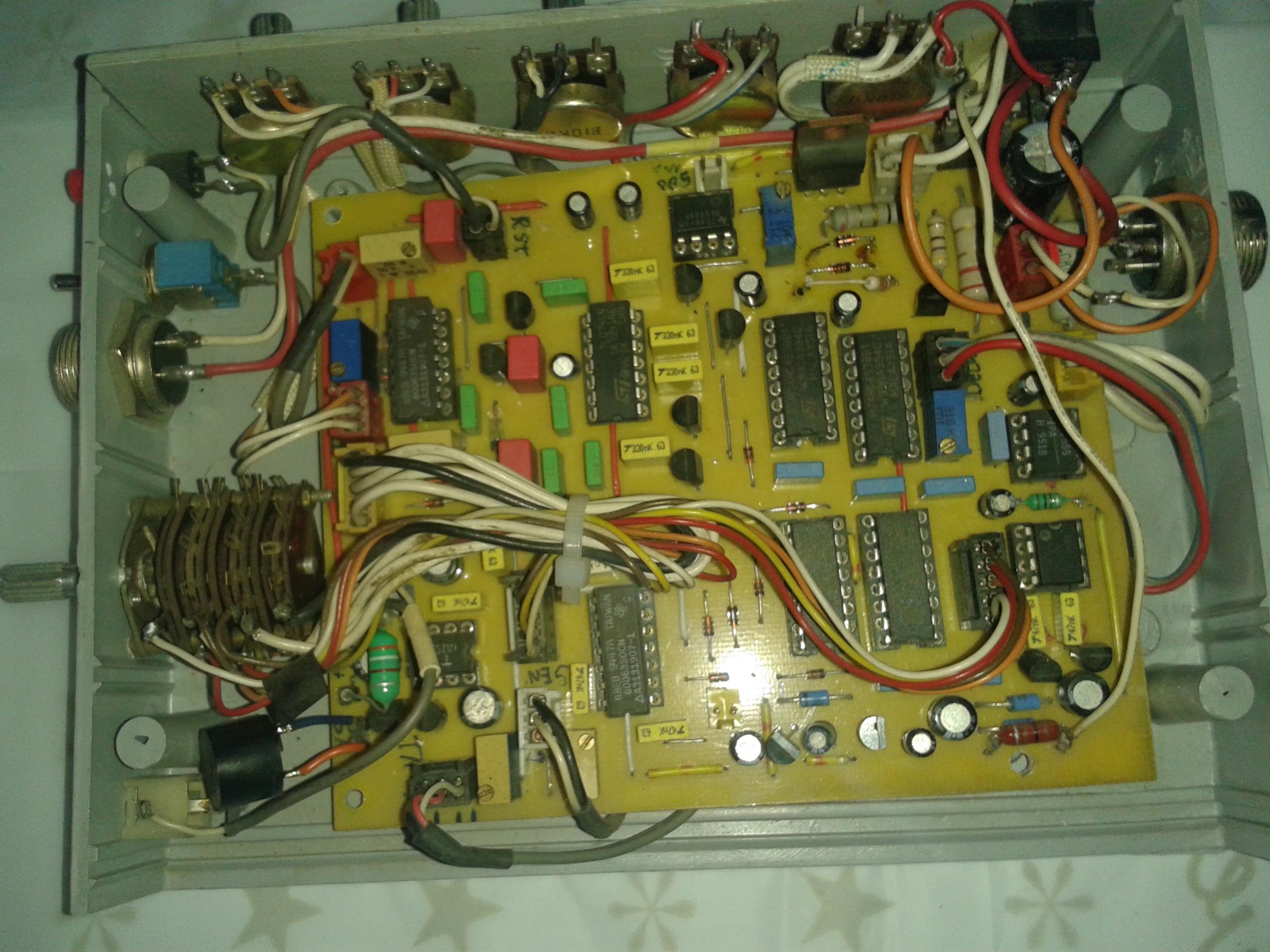

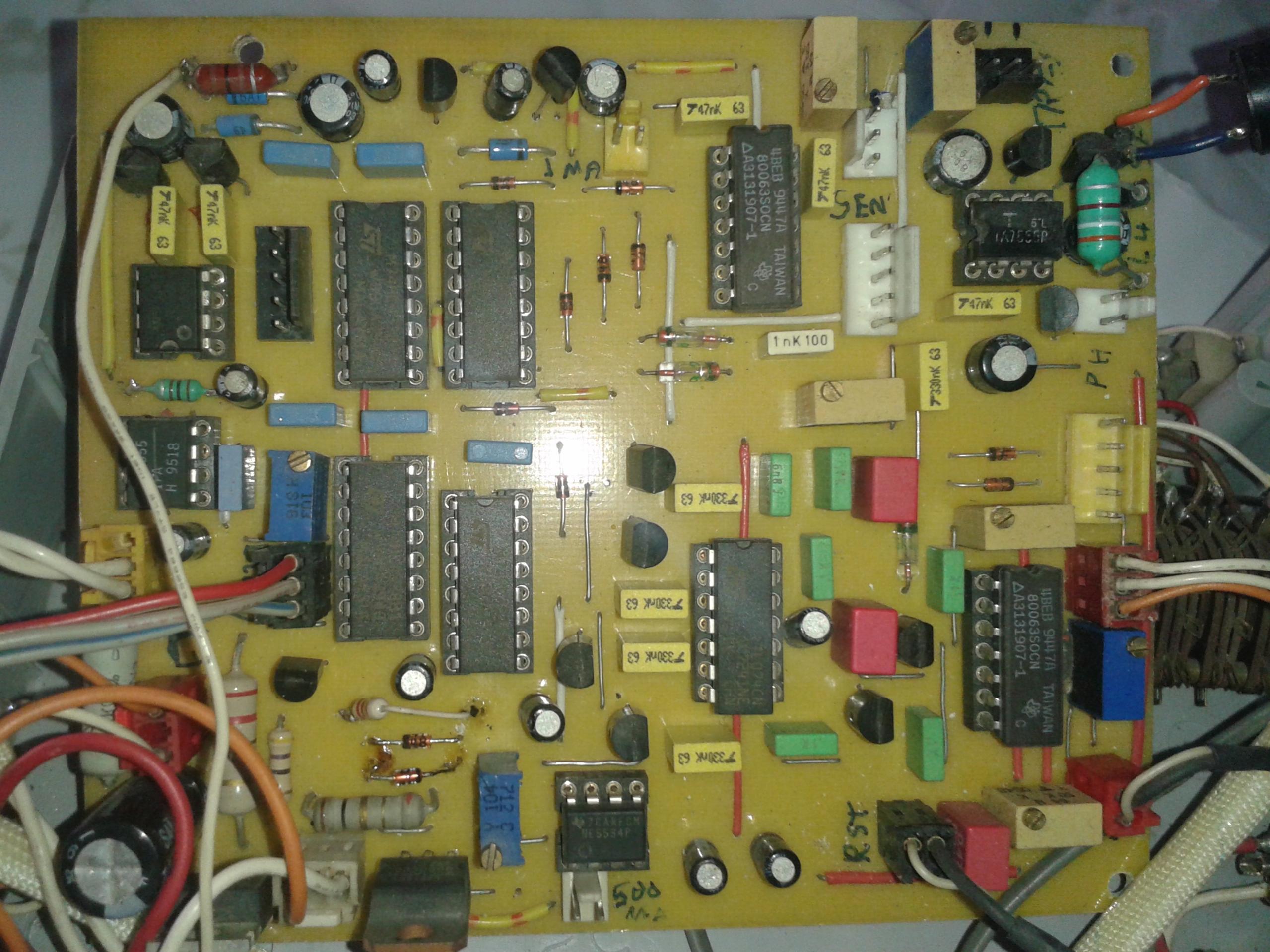

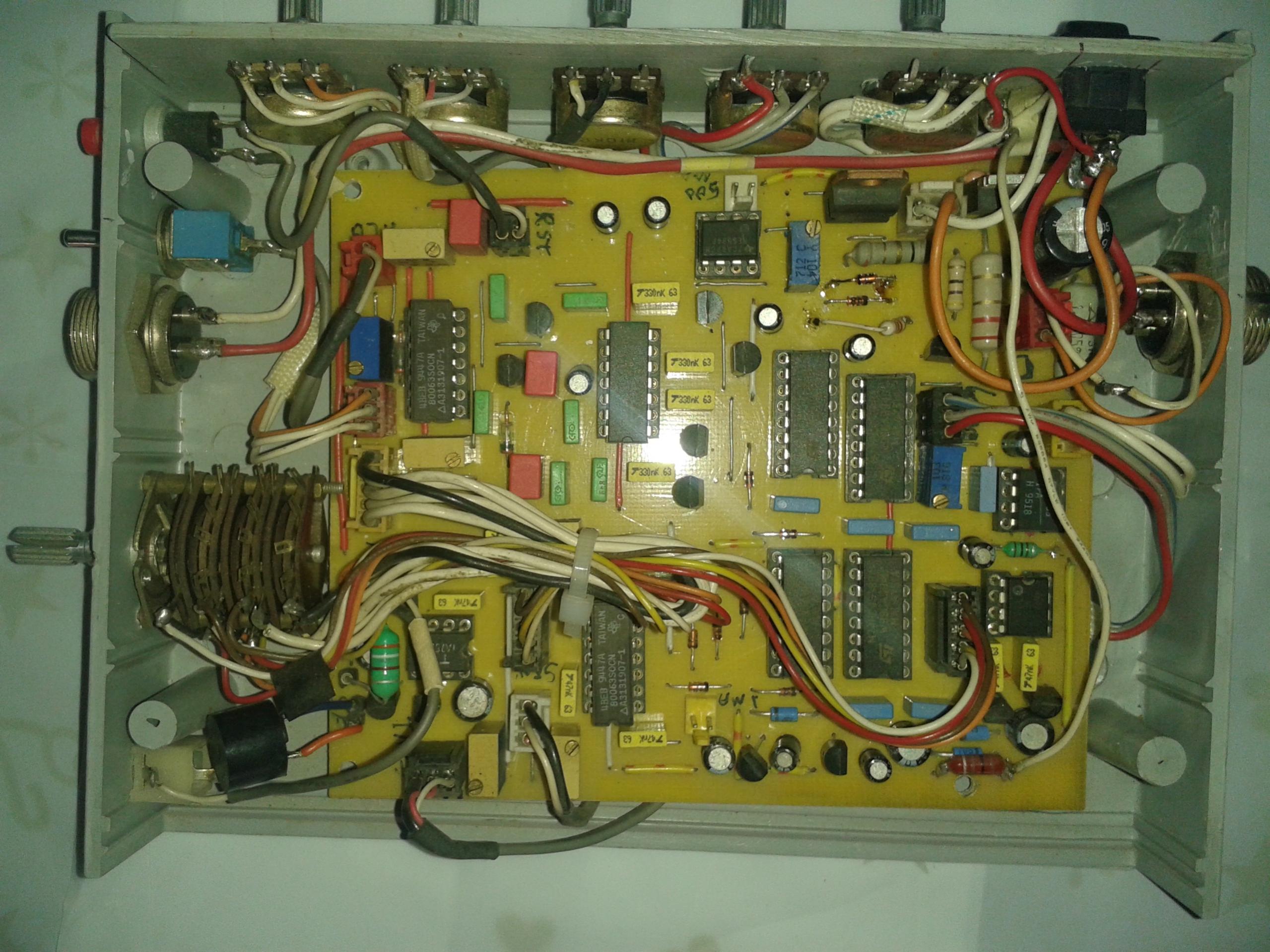

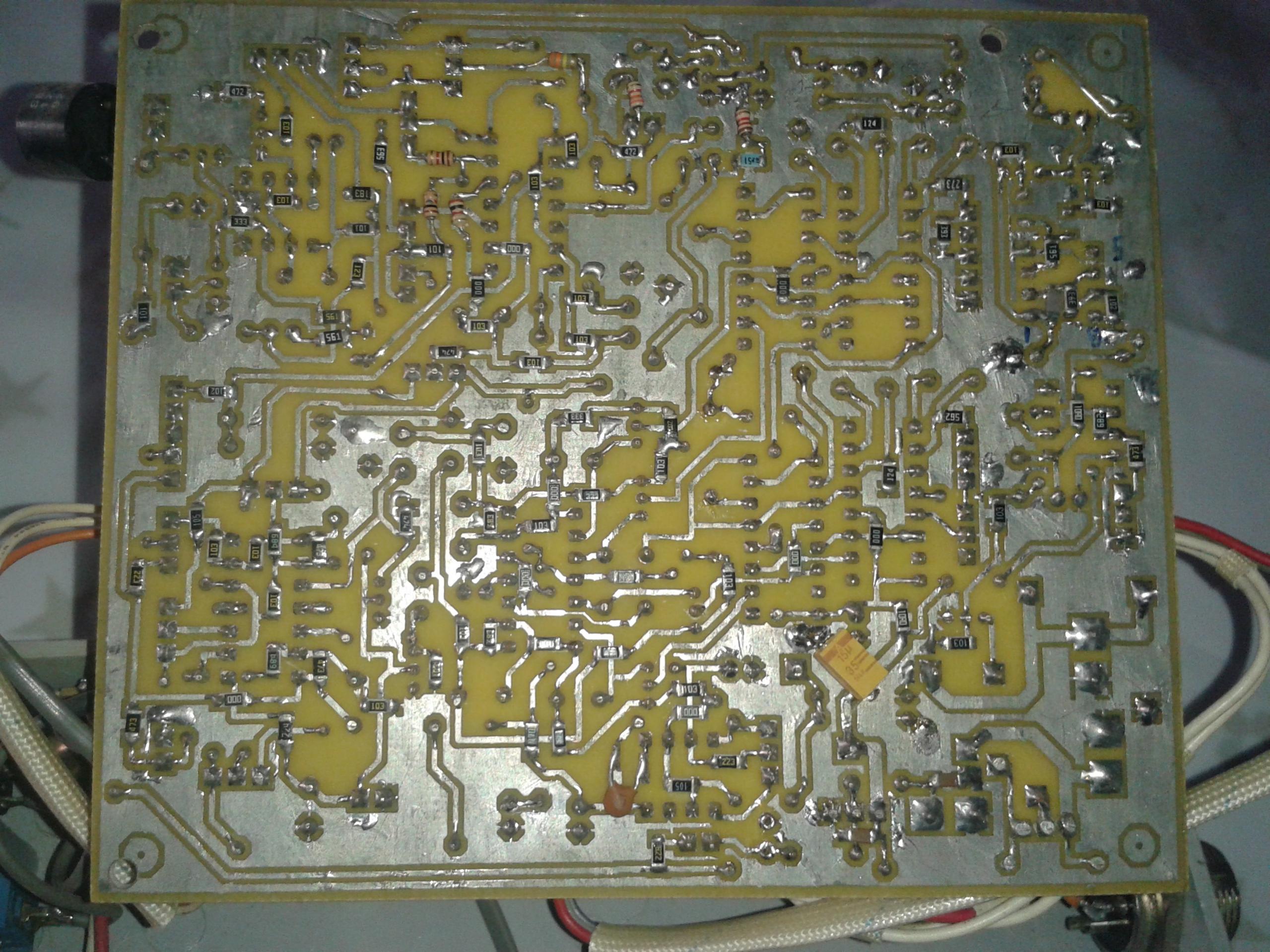

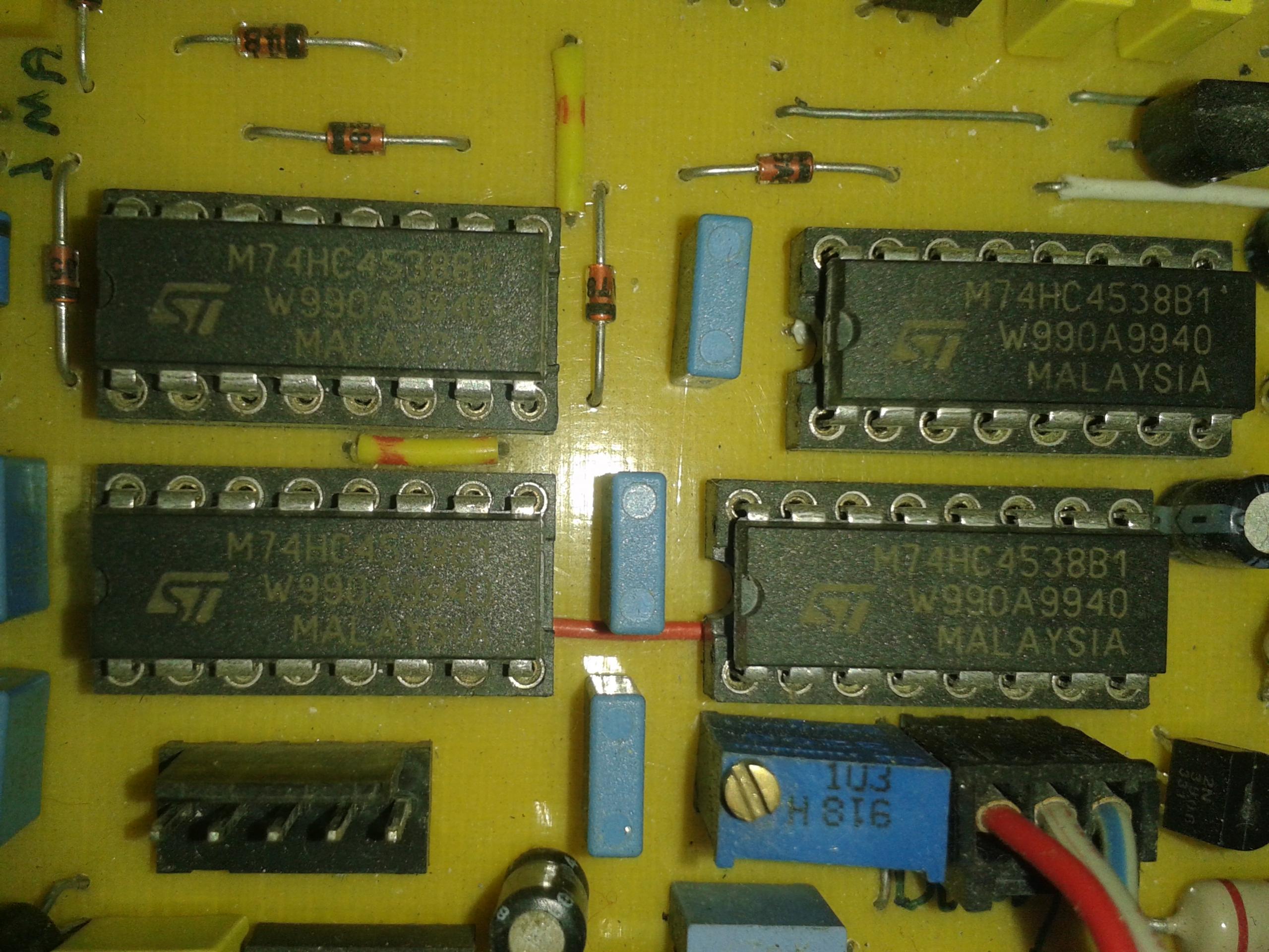

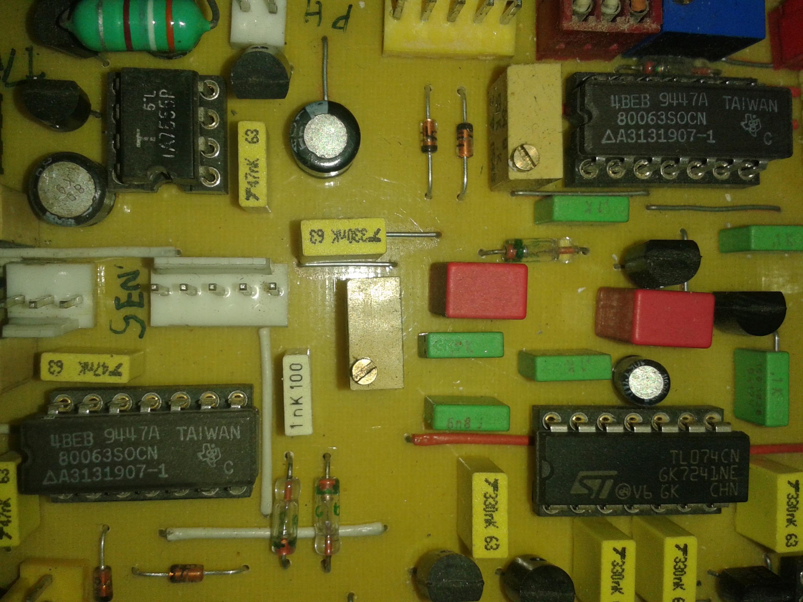

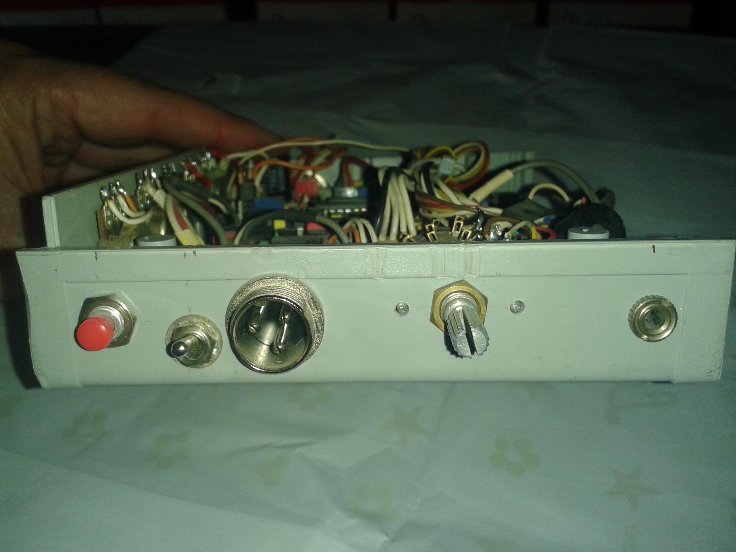

ID:	339043Hi Guru and everyone,
                I'm so sorry for the long delay. I've been through a lot.
                I hope you and the guys are still helpful.
                In response to your reply to my last request, concerning the GS5 coil,
                yes, I have GS5 in my hands, and here you are the photos of my device.
                I tried to camera digit it from all angles.
                Any inquiries, I'm ready.
                I'm looking forward to seeing from you soon.
                You have my respect and best regards.

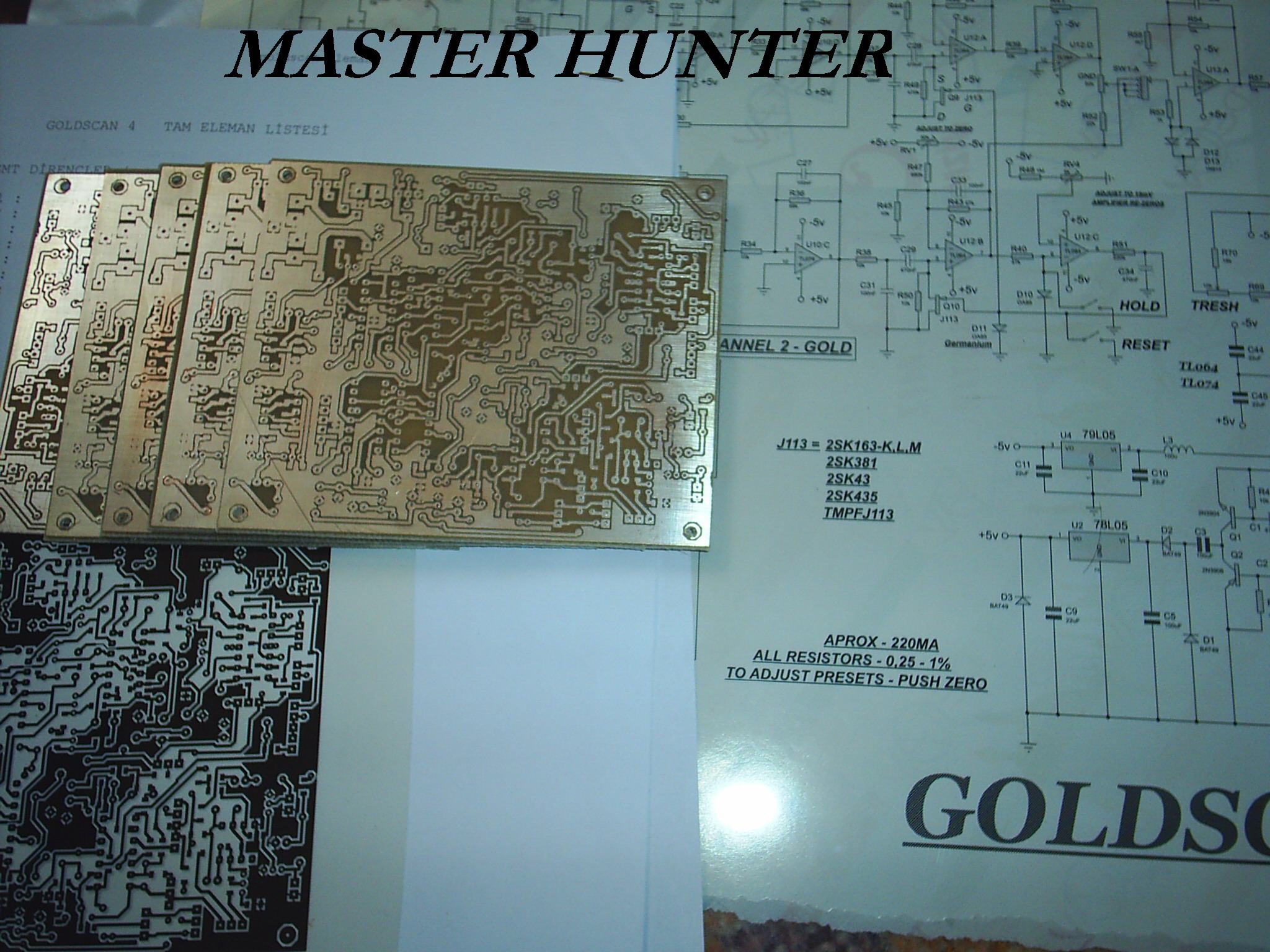

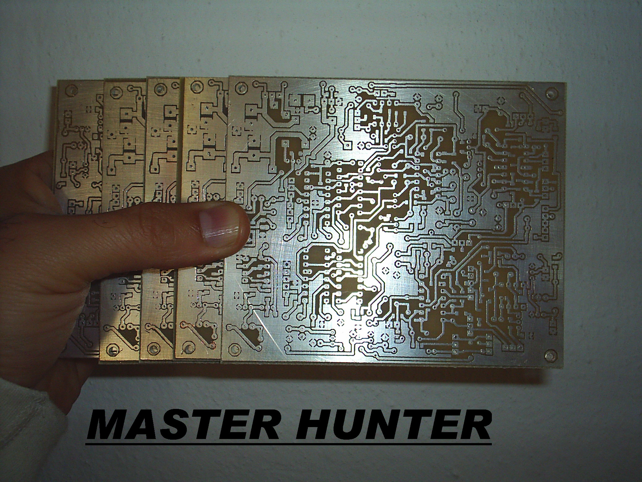

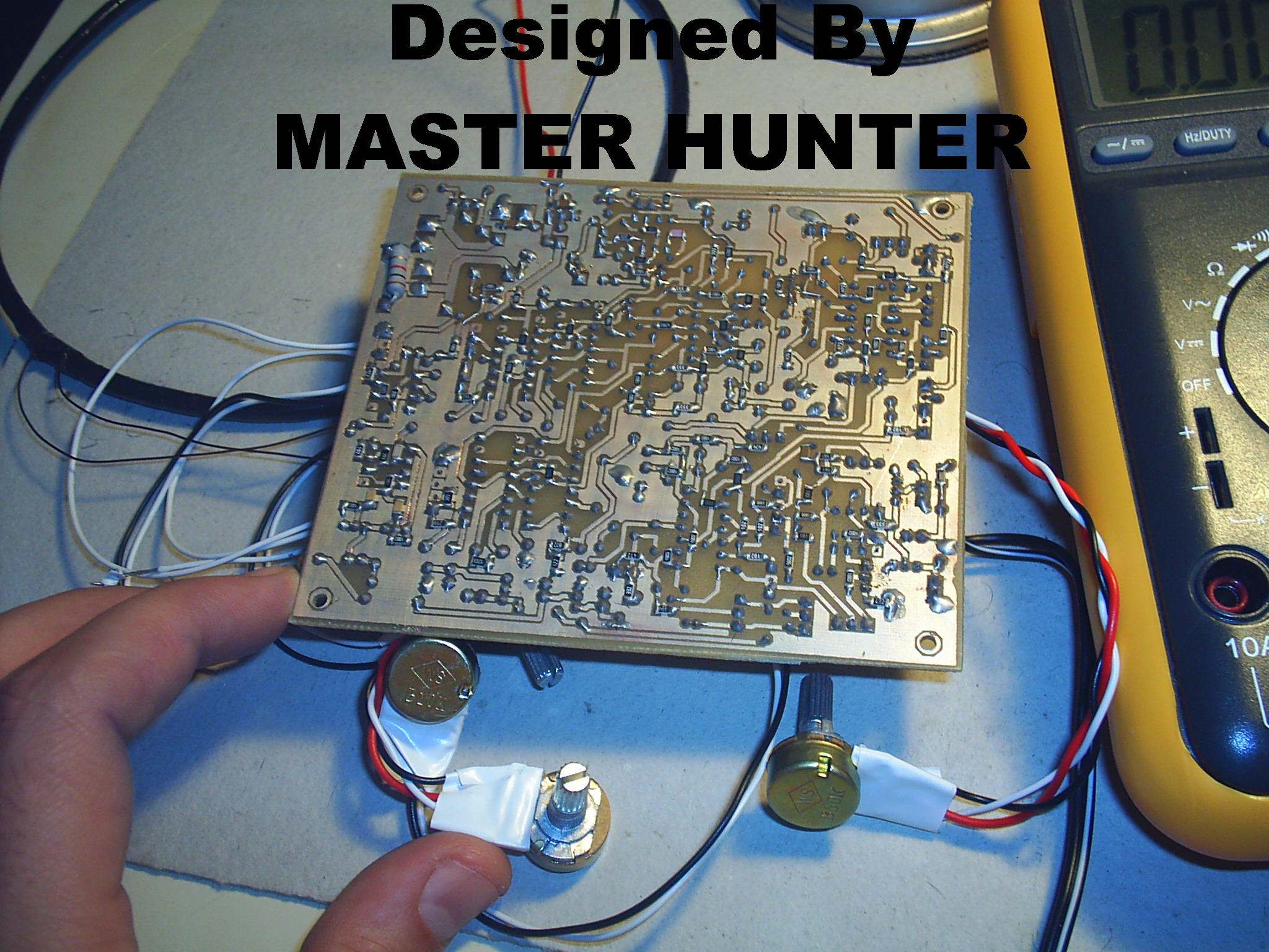

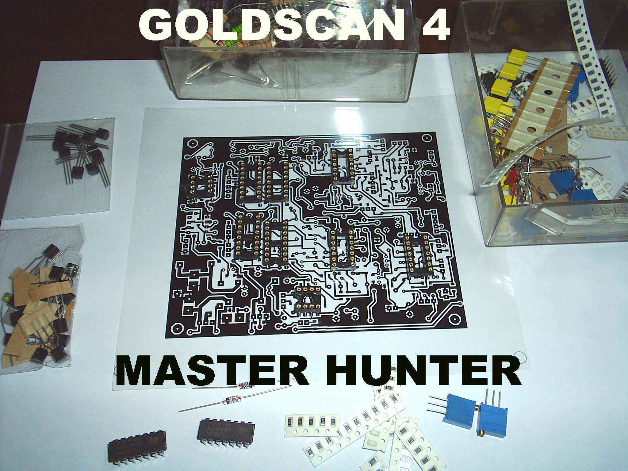

                  oohhh mama mija... thanks lots for real hi res pics, but this is not original GS5, this is DIY board using GS4 schematic.
                  this board is by guy 'master hunter' name. this guy certainly did never see GS5 in his life and not could to see.
                    Eric Foster's hard sweety dream... GS5's at makdonalds conveyor... like the hot dogs for everybody...

                      This is not a Goldscan 5. This is a clone of the Goldscan 4. There is a pdf somewhere with the protel files (?) that were produced by a Vladimir ?.... This is his pcb layout. Think it ended up on some Turkish forum.
                      For coil data look in this thread http://www.geotech1.com/forums/showt...5479#post25479
                      Look for posts by the gurus who successfully built copies of this machine and coils. Alexismex, Jose' and Max.

                        Actually, A while ago I asked for the schematic for GS5, and it was sent to me electronically.
                        On the basis of this schematic I myself designed the device shown in the previous pics, and it worked.
                        You can't imagine how glad I am to finish this device. Anyway, whether the schematic shown in pics is for GS4 or GS5,
                        could you please help me out designing my coil for this device ?

                          Look in the thread that I posted. Look at posts by Alexismex, Jose' and Max.
