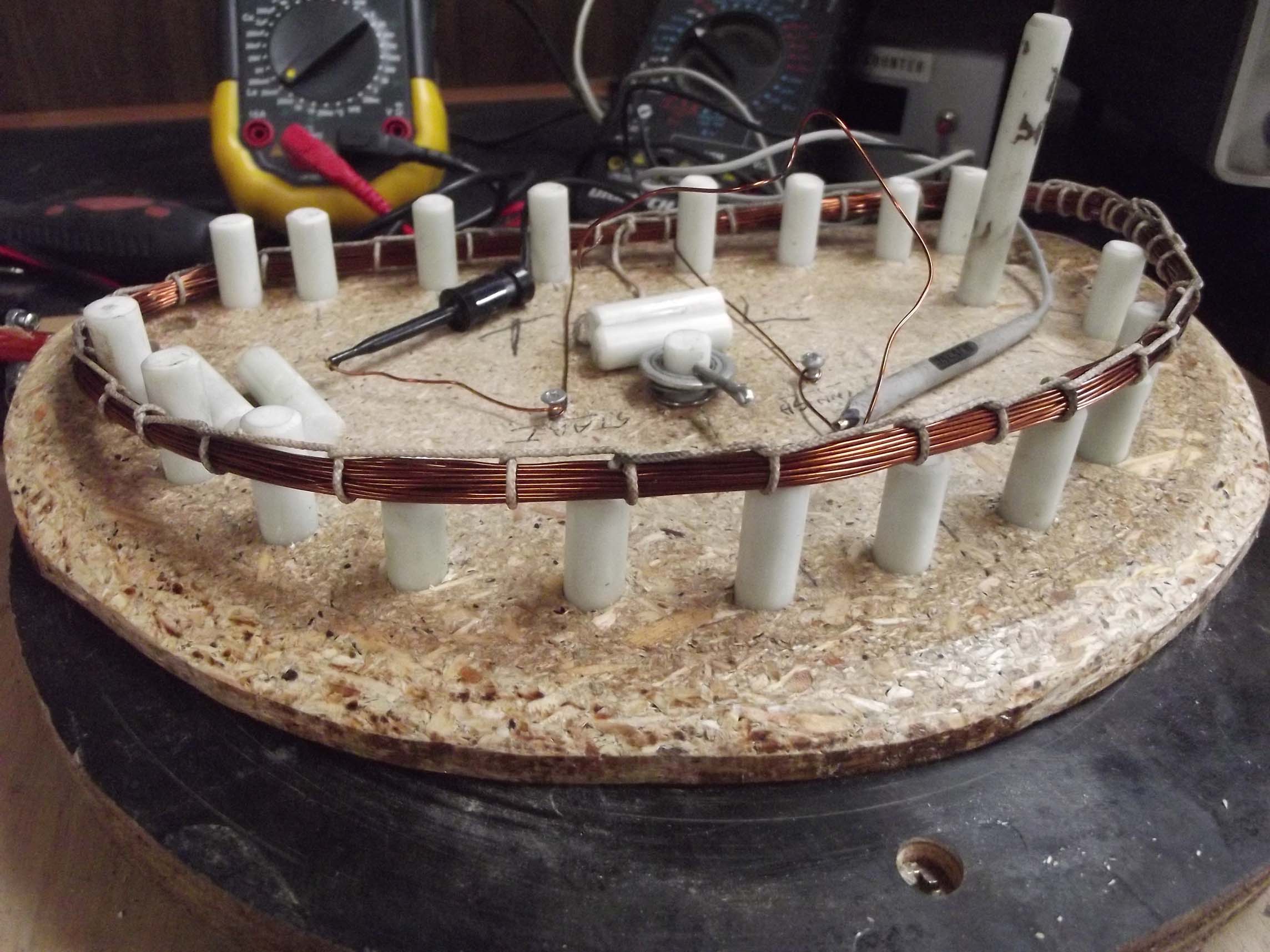

          HI TO ALL ,, As I have not been able to get a TGSL PC-BOARD from SILVERDOG,, & wanted to get started on a DIY build I ordered a IDX=EDU KIT & its coming..
          SO my original Coil former winder was for a DD coil to suit the TGSL,, But after reading the IDX thread I see I can use these dimentions to wind A coil for The IDX ..

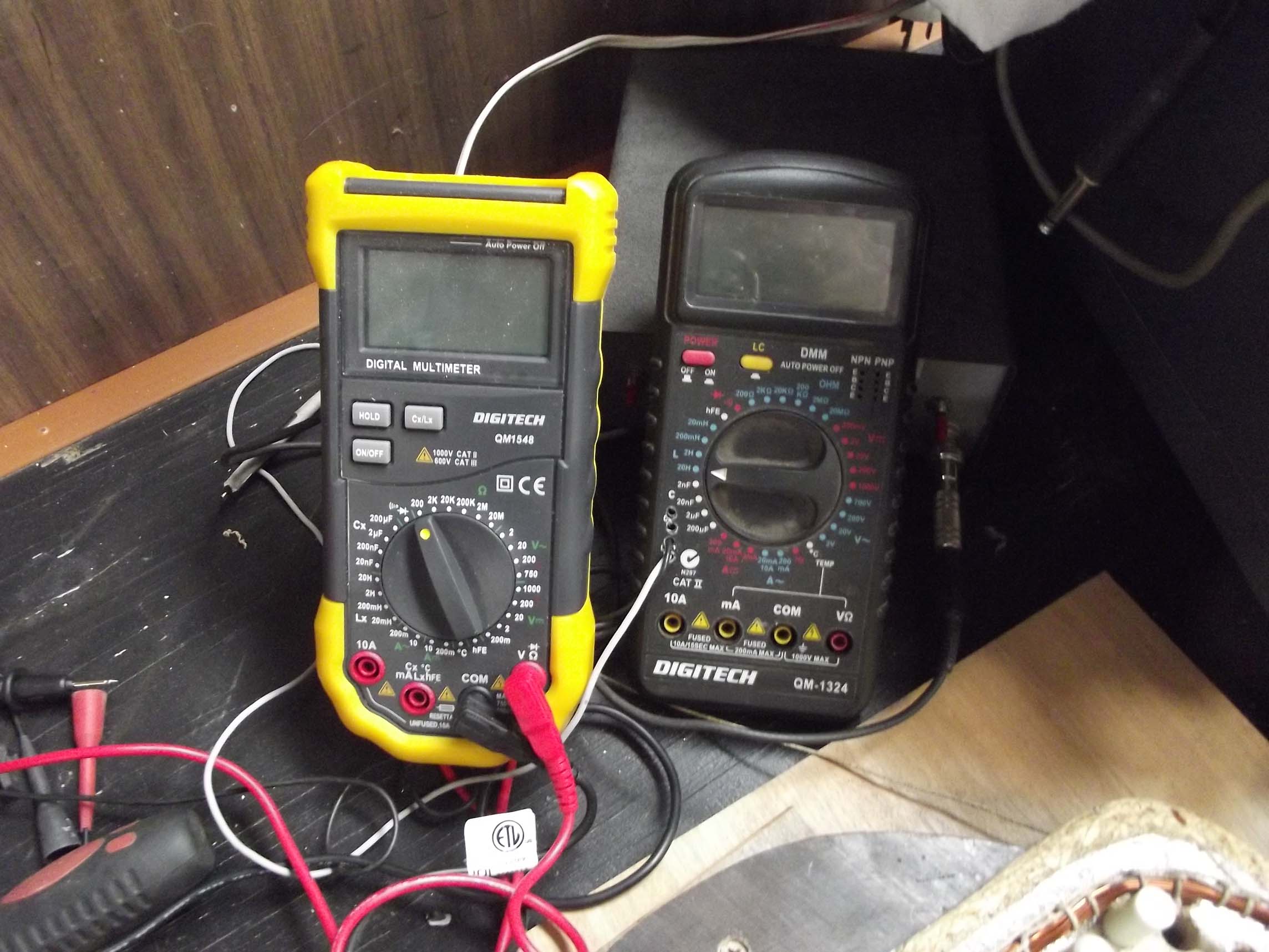

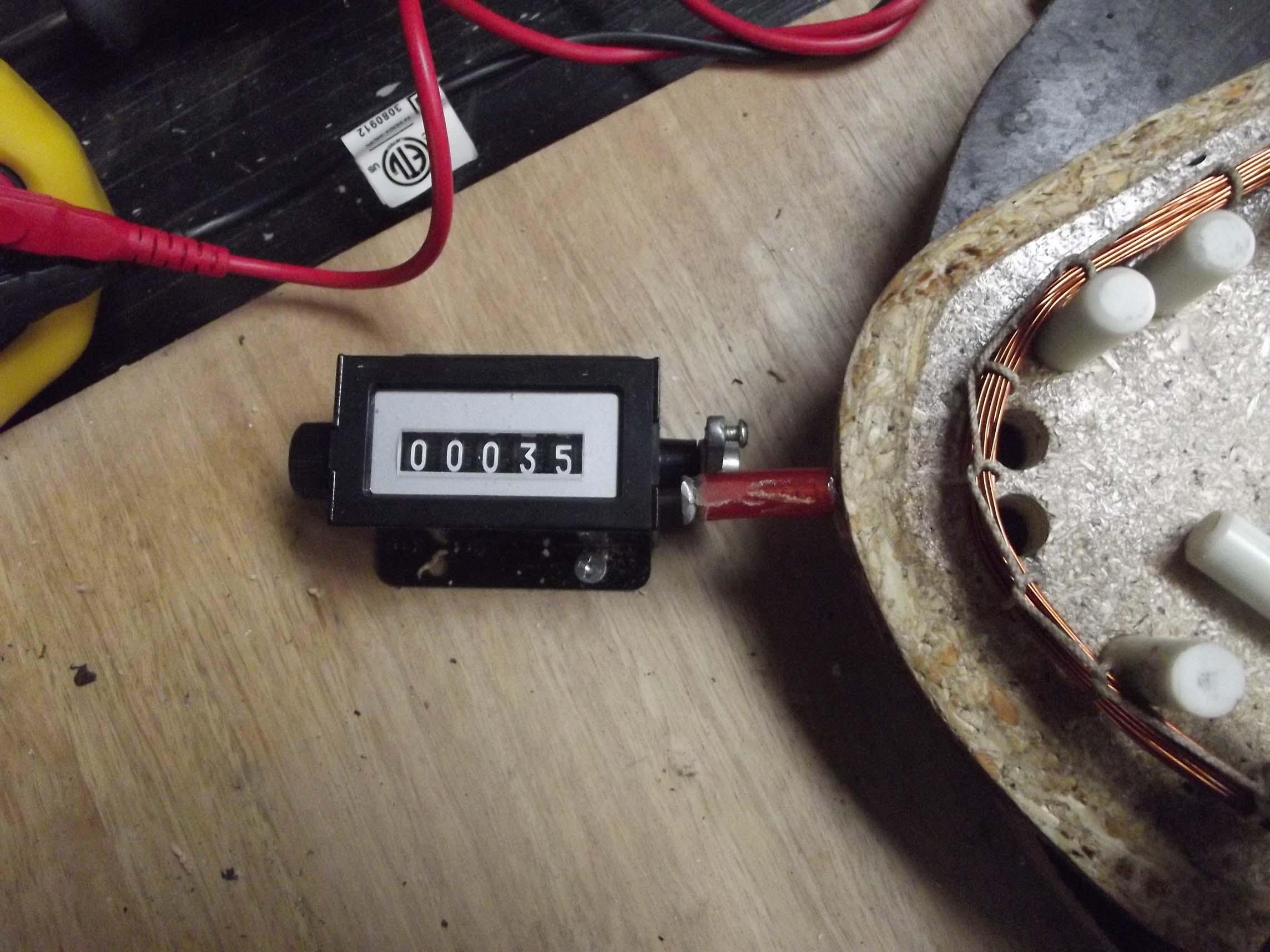

          OK i started with the TX coil using 0.7 Enameled wire 35 turns Gave me 1.7 ohms as per Intructions ,, My MH reading is close to instructions ,But not exact ,,
          To Explain ..I have 2 meters that measure MH & both are reading differently my New one measures 0.57mH & my older one reads 0.62mH ????? & THATS not as yes potted ,Thats only tied with cord see pics..[I have the opportunity to remove turns before potting]
          FRom what I have read here The mH reading may go higher once potted- [glued] any suggestion & or help would be appreciated ..
          ANOTHER Query is Coil temperature as when I did the Measurements it was 42c here today ???? [does that affect readings??]

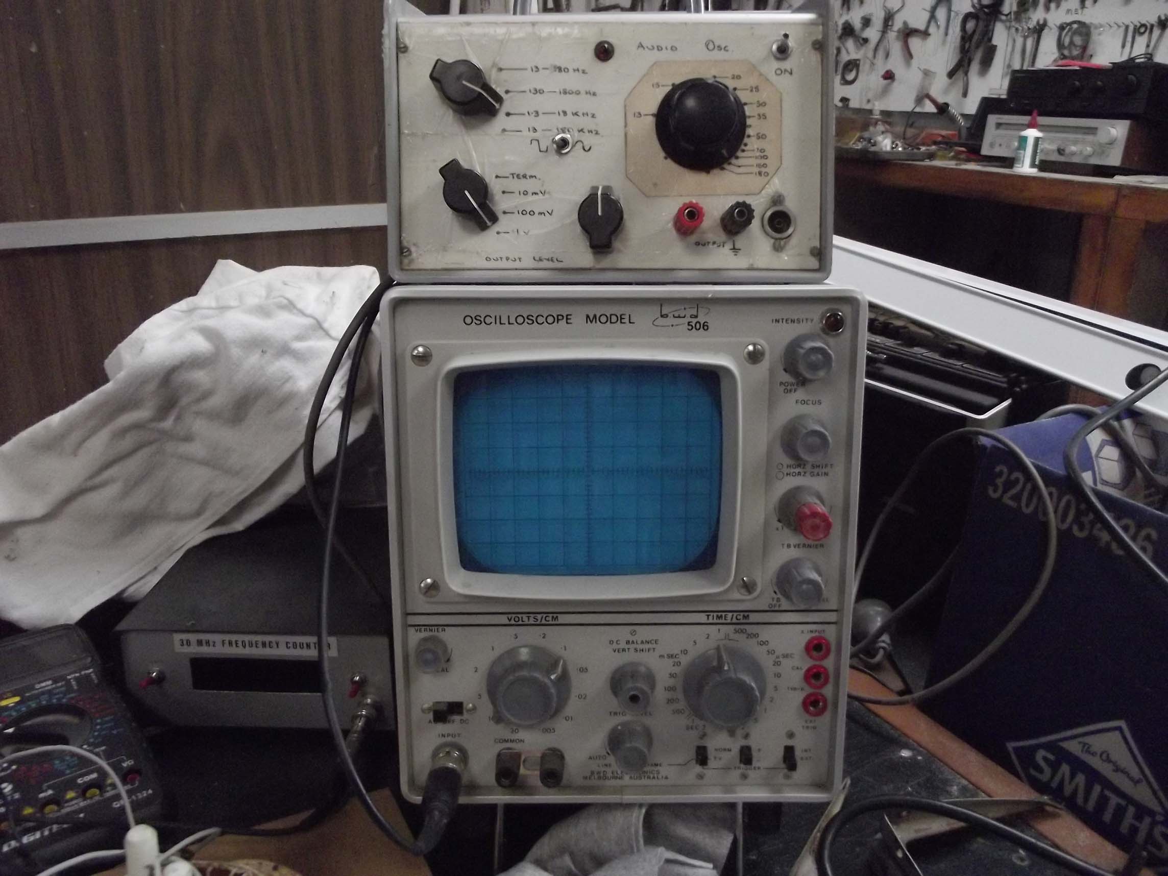

          I dug-out my old Scope But will need some advice there as well ,Its an old unit [pictured below] single channel ..
          DON has a message in the IDX thread of how to check the coil using a frequency signal & the scope But i do not relly understand all of it ???? I have my old signal-Gen & a counter that could help????
          WELL ITS my first of many trial coils I guess ,But doing this as I await the IDX kit to arrive from the UK -to Sth-australia..
          sOME PICS of my set-up ..
          CHEERS ,,,,,,,,,,BARRY IN a HOT AUSTRALIA..

            My take on the whole inductance thing is that it's a moving target so easiest to wind the number of windings
            with the correct size wire and don't worry too much about it. The tuning cap will most likely be off a bit too
            so a fine tuning with additional caps will bring it into tune.
            On some of my coils the resistance was off. I discovered ordering by AWG does not always give you the same
            diameter wire. It's like how a 1/2 gallon of ice cream is now 1.75 - 1.5 liters (hey boss we can save $0.03 by
            making the diameter smaller but calling it the same thing..).
            It is nice to have a 2 channel scope for checking the Disc and GEB positions but a lot of work can be done with
            a single channel. Frequencies are low so most any scope will do.
            You can check resonance by sending a sinewave into the coil and seeing what frequency the highest amplitude
            occurs at. I don't have a picture handy. You need to isolate the signal generator and scope so your only looking
            at the voltage in the coil. So take your coil and put your tuning cap across it. One end is ground of scope and
            signal generator. The other end goes through a 10K resistor to the signal generator and through another 10k to
            the scope (so the 2 resistors connect one end to the coil/cap end and the other ends go to each device).
            Fire everything up and sweep the signal gen looking at the scope. Look for the highest peak voltage. Stop sweeping
            there and read the frequency. This is the frequency that your coil/cap is tuned to...
            I'd like to do this with my coils but I don't have a good signal generator handy..

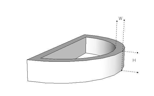

              Is some definition or ''best ratio'' between H and W, when making DD coils?

                I believe H = W gives the most field strength...

                        Hi Valters that is a good question. In general RF the ratio is 1:1 for best form factor, best inductance and losses .. Q. Bundling turns as we do here Is frowned upon in general wound devices from mains transformer design to VHF air cored coils.
                        Have a look at a Helmholtz coils where the field out of the end gets projected, by stacking spaced coils - maybe good for MD coils - although bulky

                            I am at the stage of potting the TX Coil & hoping the super-Glue [recomended] does not affect the out-come figures ..
                            Question What is most important ?? The Resitance reading of the coil [In this case 1.6-1.7 Ohms ,,,OR the mH reading ????,The Resistance should not alter with potting????..
                            After potting ETC I was to wrap the coil with poly Wrap & I bought a roll of aluminium foil [self stick very thin for the farrady shields..

                              Bind the turns tooth floss is good. or the waxed whipping twine sailing guys use.)
                              Add a few drops of cyano to stiffen it up!. Dont flood as you may need to bend the shape later without fracturing the enamel covering the wire!!!
                              The L and R does not alter with the cyano.
                              The L goes up a few % when you bind it - as the turns get closer - but dont stress as the final frequency is not a big issue. Plus you can tweak the freq, with the cap value later if you feel the need to get 6.57688976kHz ( I run mine higher to see smaller items 12.5KHz Tx with no issue )
                              Wrap the coil post glue, in pvc insul tape, then foil with a fine drain wire then pvc tape again - Dont forget, foil needs a gap or the Mag H field wont get out. Make sure you have a shell that will take your coils when you got all these wraps on them.
                              Dont pot the coils in the shell untill you know it all works - as wasteful. I would say if you just put coils in a shell and potted you would have a 5% chance of success.!!!
                              Tack Tx coil in the shell with, say 4 small spots of hotmelt glue -- then place Rx - dont glue this one.
                              Location in room is critical - dont sit your coils/shell on anything with metal in it -- trust me
