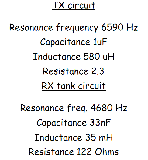

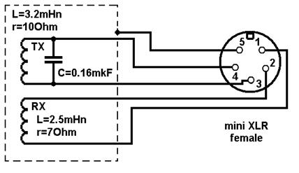

                  My hunch as to why it didn't work is that the receive-coil differs. The F2/F4/BountyHunter coils have a very low RX coil resistance, a few ohms. This isn't because they have thick copper wire, or are made to be really low-noise. It's because they have a fairly low number of turns onthe RX coil. This 'low-sensitivity' arrangement is compensated for by having a high-ish gain pre-amplifier. Maybe the Whites coil has a greater number of turns, a proportionally greater resistance, and more output voltage. Just a guess. Seeing as you've sold it, we may never know...
                    Here's some info on both;
                    Whites
Name:	Whites Coil Specs.gif
                    F2
