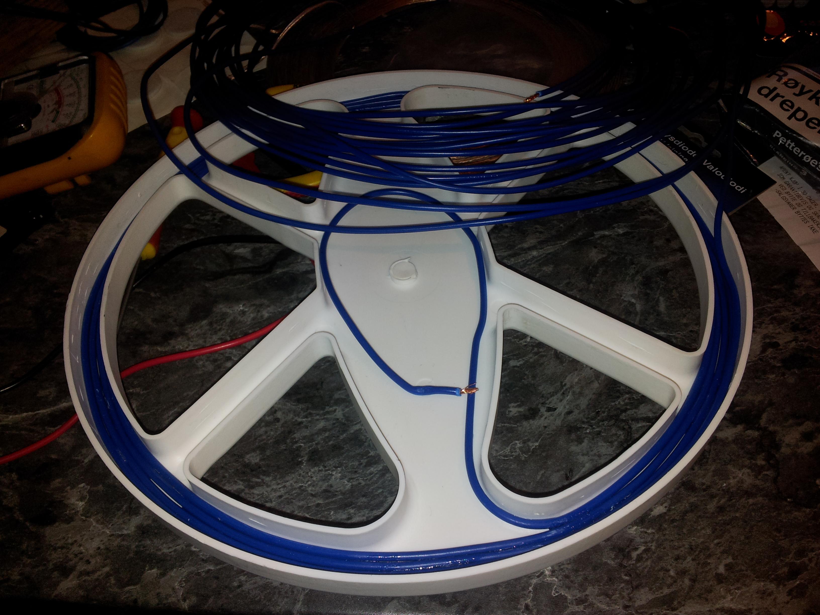

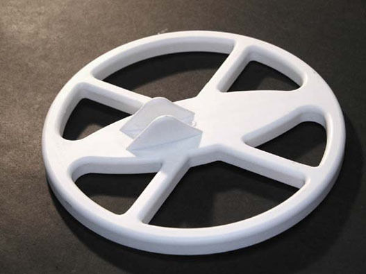

    I'm trying to make a decent coil to my surf pi kit. I bought this cover on ebay that I will use as coil housing. The cover has i diameter 280 mm.
    The wire I have is RK (H07V-K) 1,5mm2.
    So what I wonder is how many turns I need with wire and if this may be a good coil.

      uff... this wire you use is fat for your housing. take 0,6-0,8 mm diameter wire. this fat wire will be good for big coil, 1 meter x 1 meter. not for small coils.

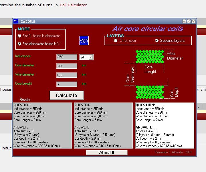

        Qiaozhi: Thanks! But what is the ideal inductance with the surf pi 1.2?
        kt315: Yes, I feared that it might be too thick. I can maybe 20 turn with this wire, with four rounds in width and five layers. That gives me 0.247 mH in the coil calculator?

            it looked like a handy program, so I downloaded it what about this? (if 350 uH is a good inductance)

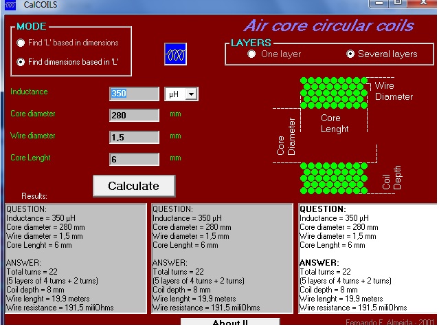

                For a 140mm radius coil, wound with 1.5mm diameter wire, you should get the following:
                20 turns = 284uH
                21 turns = 312uH
                22 turns = 340uH
                Any of these should be OK for the Surf-PI.
                The final measured value of the coil will depend on how tight you bind the wiring. If you use spiral wrap, and then cover it a layer of electrical tape, the calculated and measured values should be very close.

                    Are you saying the coil wires need to be bound tightly?
                      yes with thick wire like that, capacitance should not really matter as the gap will still be sufficient due to the thickness of the plastic insulator, so when tightly bound you wont get falseing when bumping rocks etc.
                      when i started, i wound a barracuda coil out of 2mm wire like that and it worked fine, yours is a smaller diameter, and less winds, the problem with that type of wire is it can be heavy(mine was), the type of coil shell you have is injection molded as well while they are excellent shells strong etc, they are quite heavy, it all ads up.
                      i would wind a rough coil out of that wire for testing and setup, but save that shell for some better wire, the degaussing loops out of old crt televisions and monitors, wind good coils and can be got for nothing, its the loop of wire that is fitted around the screen, plenty of coil wire there just take off the tape and wind a coil off the loop, you can get a few good coils that way.
