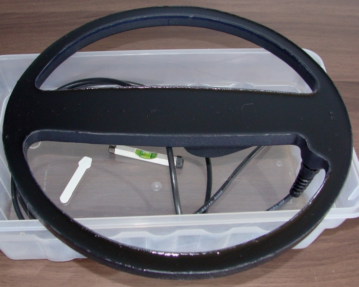

    Using epoxy potting compound works out to be quite expensive, would it be possible to use a polyurethane Liquid Plastic Casting Resin without causing any loss of sensitivity? which looks to be less than half the cost, Any other suggestions appreciated, Fastglass etc.? What did you seal yours in?

      I used polyester resin because it was cheaper but even with the minimal amount of catalyst it got quite hot next one I do I will try epoxy and see if there is any difference.
        You don't say what kind of detector the coil is for. If it is for a PI machine I would not cast the coil in resin at all because it will add capacitance and slow it down.

          Yes, I don't think you can beat the potting epoxy from MG chemicals. It cures hard and best if all, sticks to plastic shells! I trashed a few shells until I found this stuff. Fill your empty shell with water first (without wires of course) to see how much you need. 350mL is more than enough though, especially if you use fillers.
            All I use is MG "non-conductive" potting epoxy that DBowers uses. Easy to work with and you can use it indoors without horrific odors or toxic fumes.
            A bit more expensive, made for the purpose......................worth it.
