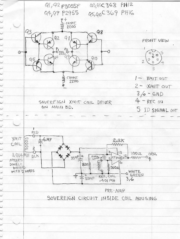

    hi the I have a torando 1000 coil for a minelab sovereign elite and I am in need of a wiring diagram for my six pin connector.
    the coil lead core colours are
    1. black
    2. red
    3. yellow
    4. white
    please if you can help me I would be over the moon as I can not pay the cost for minelab to fix. thank you for looking happy hunting
    This should get you on your way...
