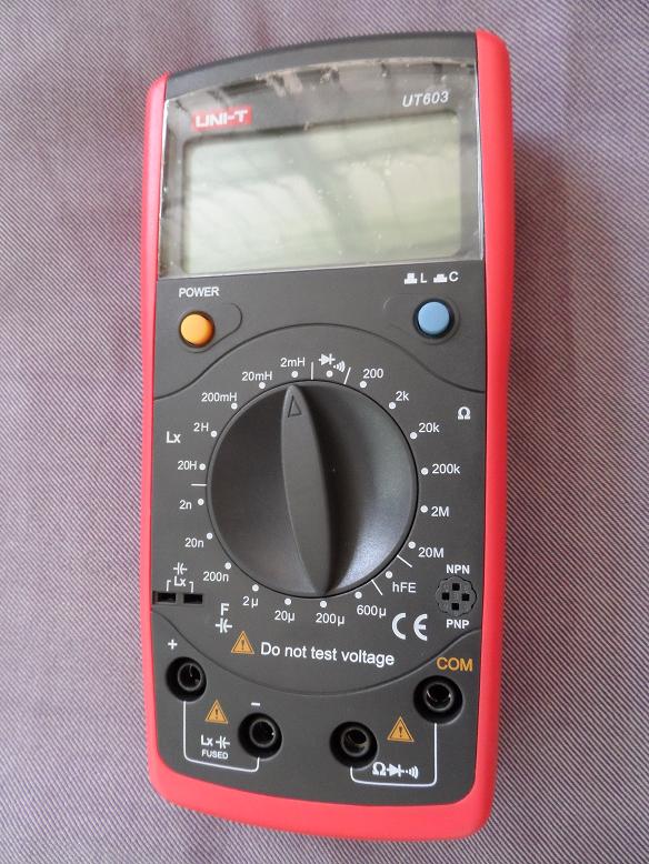

                  Up until yesterday I've been using Qiaozhi's coil calculator (and still will) due to not having an inductance meter. I noticed yesterday that a local electronics shop now stocks some and bought one. When I got it home the first thing I did was verify 3 coils I wound using the coil calculator and they all measured as calculated!
