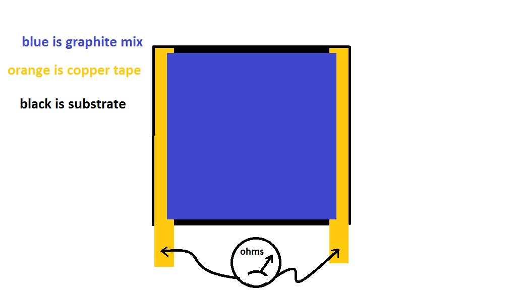

                          It would also mean more if we standardised a test.
                          A square sample with electrodes is the best/ most consistant way to judge results. This way you get an ohms/square value - industry standard
