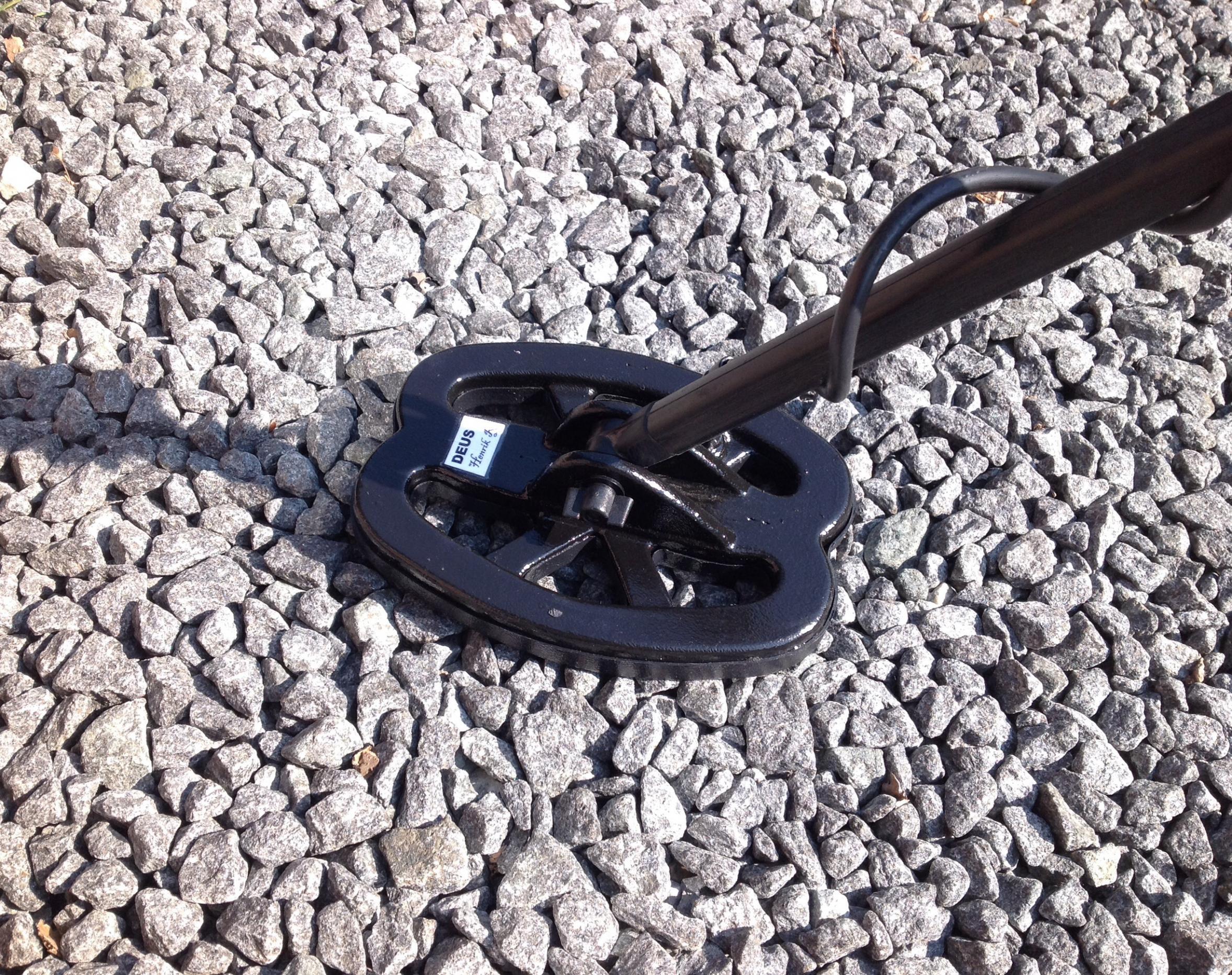

        I got no idea about this, but because the TX got 0.31 mm wire and the RX 0.18 mm wire, and they are made from same form, the TX is a little larger.. I got 1-2 mm air from the TX to the Shell and 3-4 mm air at the RX side.. That little off balance size could Be my lucky punch.. Dont know but why else is this coil working so nice, and I had to stroggle so much with the 7" coil !!!
        Allso look at the distance in the middle... 1 cm between the RX and the TX, thats a awesome sharpness.
        Maybee my Deus electronic unit just love to go smaller, and it all comes how it is programed at the XP factory !! Never mind I'm got a Big smile now and keep that until the shielding problems start. LOL.

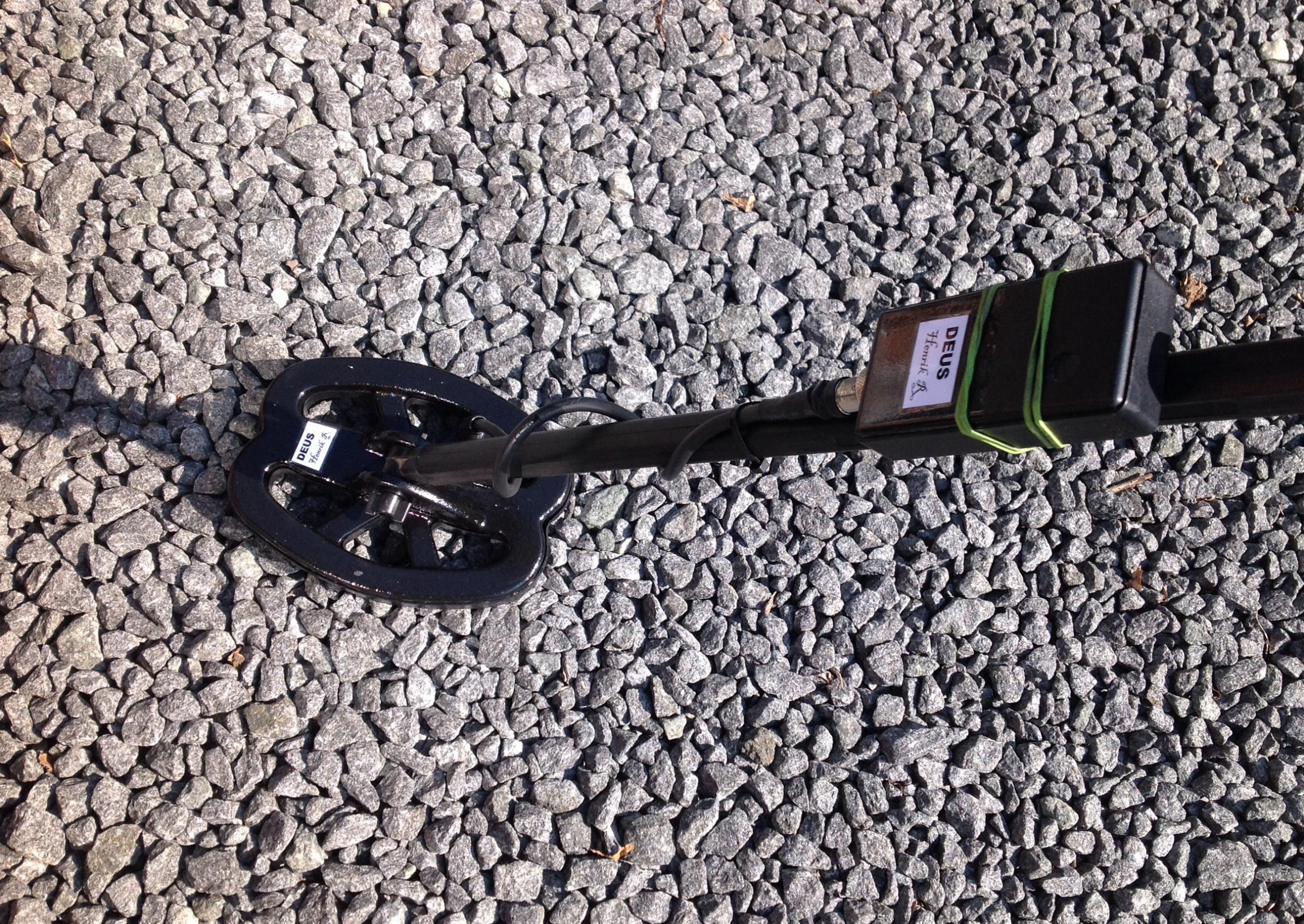

                    Ready to go out to the hot spot.
                    This DB shell eliptical 5.5"x7" Deus coil is made with same shielding like my 7" Deus coil allso made in a DB Shell.
                    I hope it will work.. Some test at Home looks good, but you never know... Reel invoirment is different.
                    See you later.
                    Henrik

                        Here is the days result and my honest opinion.
                        The benefit to use a smaller coil, going down from a 9" coil to a 7" coil and like to day a eliptical 5.5"-7" coil, (using a Deus Detector) ISN'T much. I made a test Very similar to the signals I'm getting at my field, and came to that conclusion.
                        This coil size quenstretion Its a balance; coverage / dept / masking / clear signals / respond - you know what try to say.
                        Yes my new smaller coil will find more, but not much, because the iron is masking more that I thought. Remember allso this theory ! Smaller coil less dept and therefore less iron / masking problems, but allso less good objects.
                        Made a video.. and that will show you what I'm trying to say.. Injoy and any comments are mustly Welcome.
