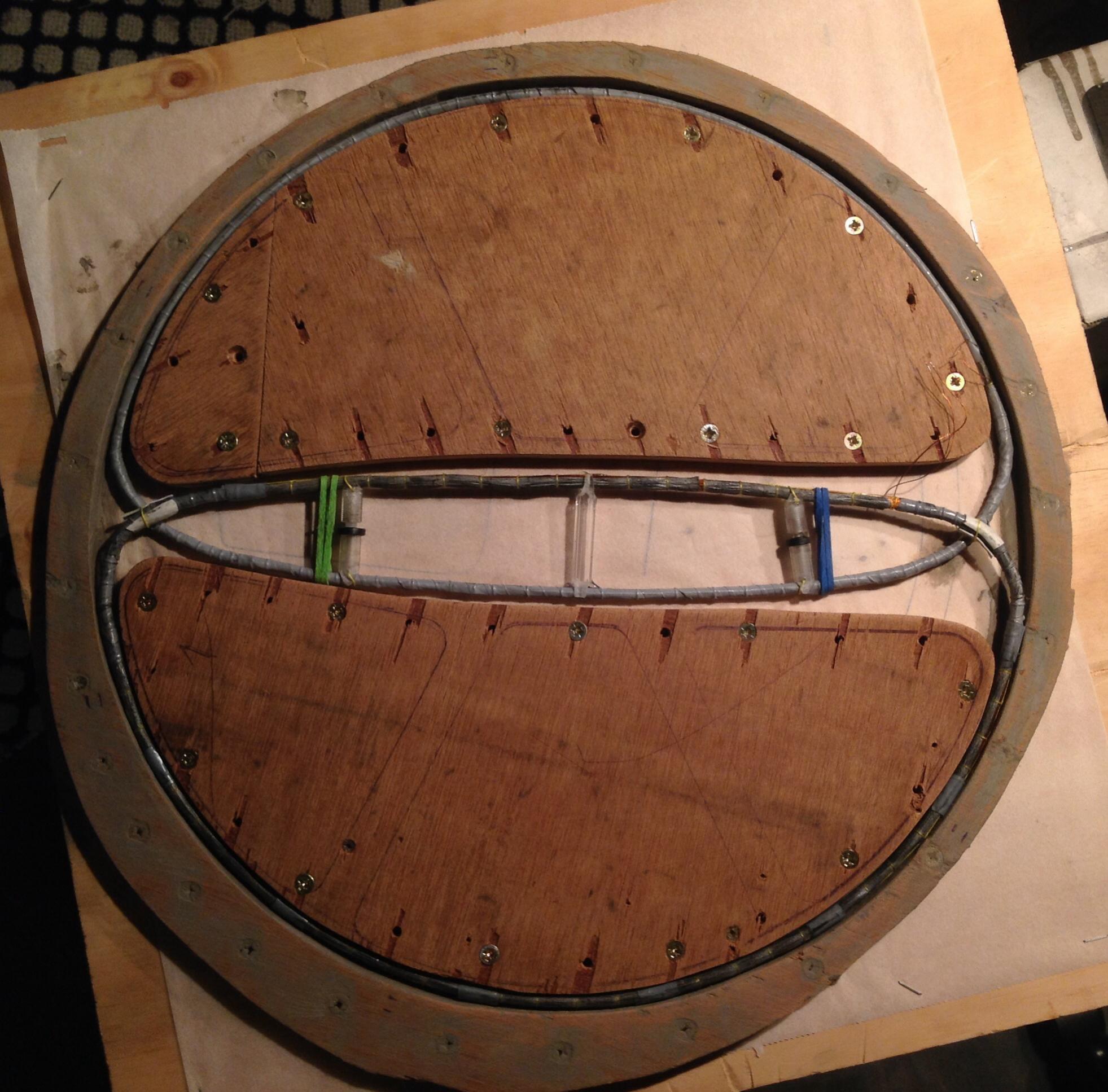

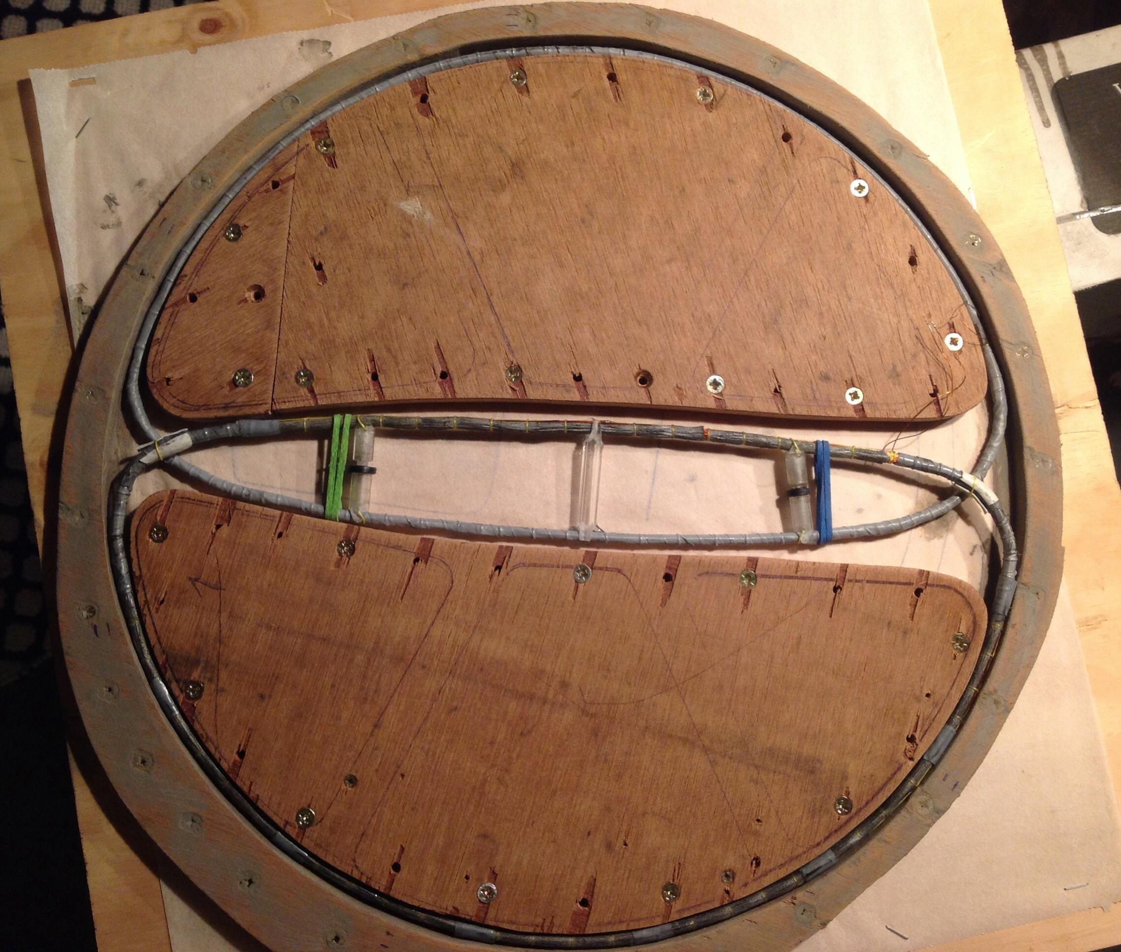

Coil works isn't not Allways easy.

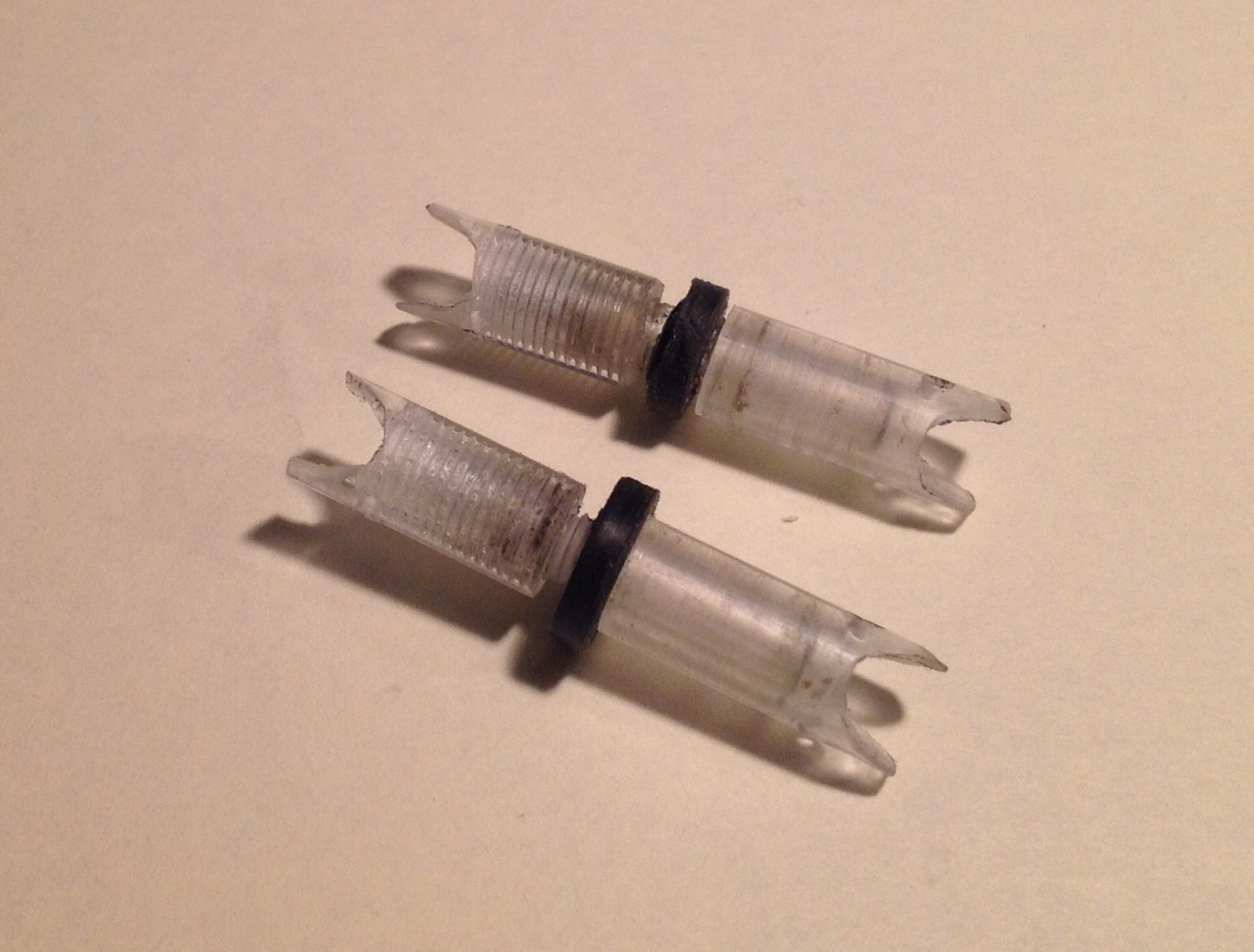

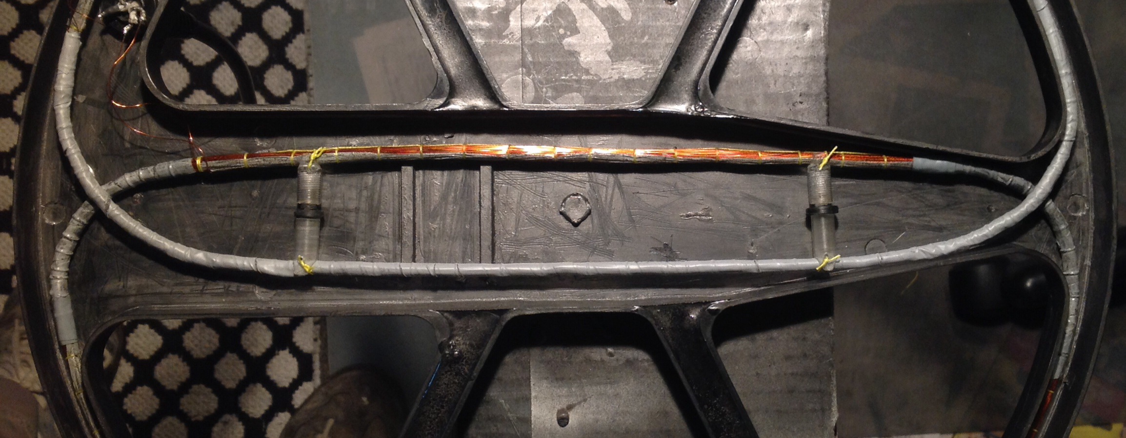

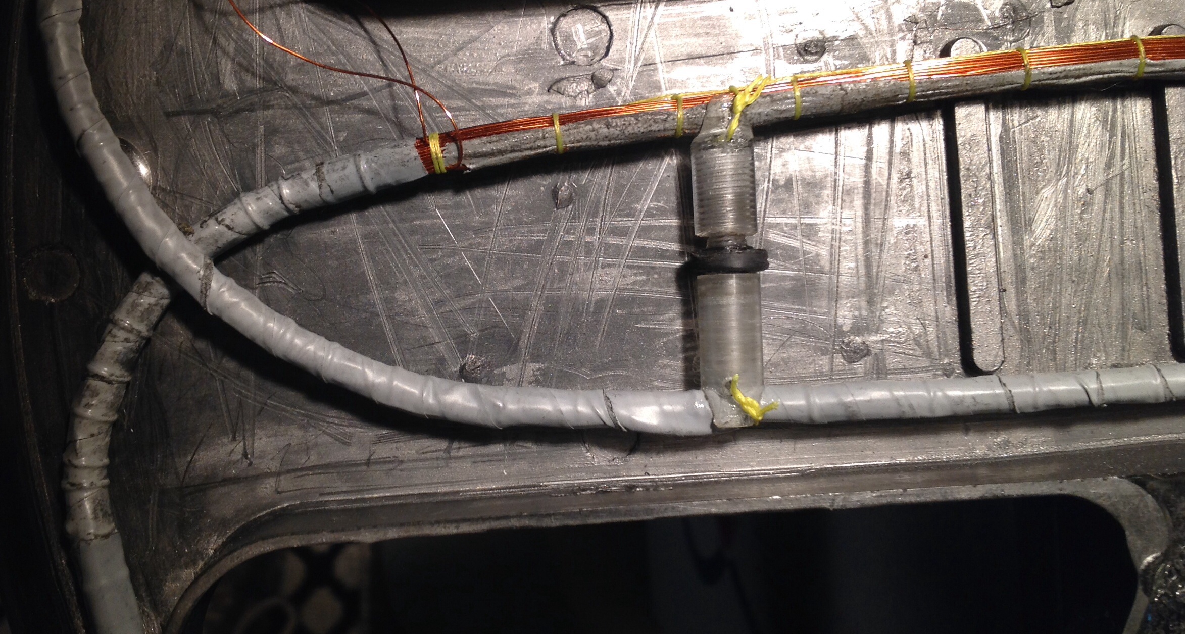

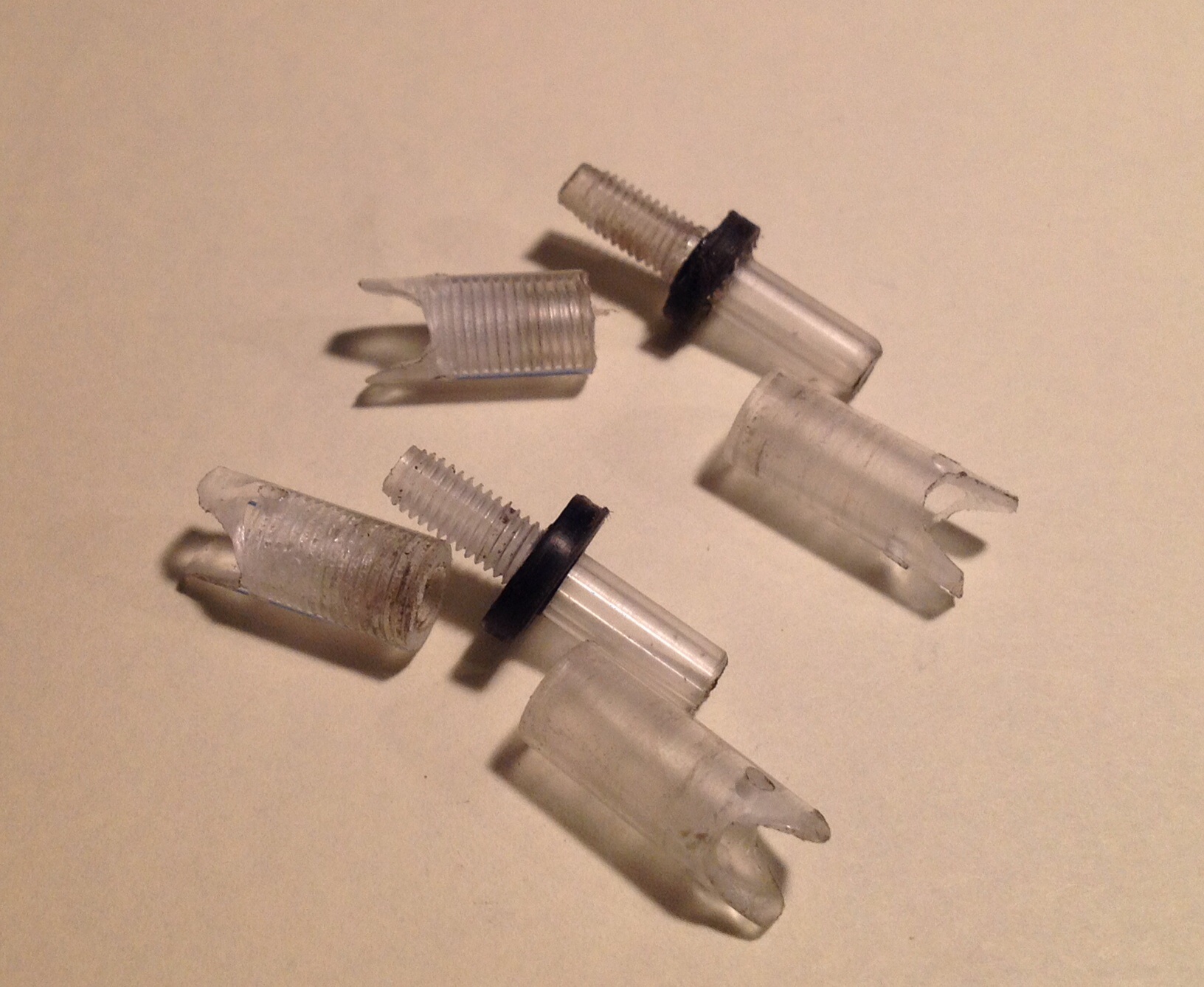

Made some small Tools to help me finetune - now its easy to change a little sharpe, finding the Null and the scope work.
By turning the Black wasser the distance will either Be more or less.
Henrik.
