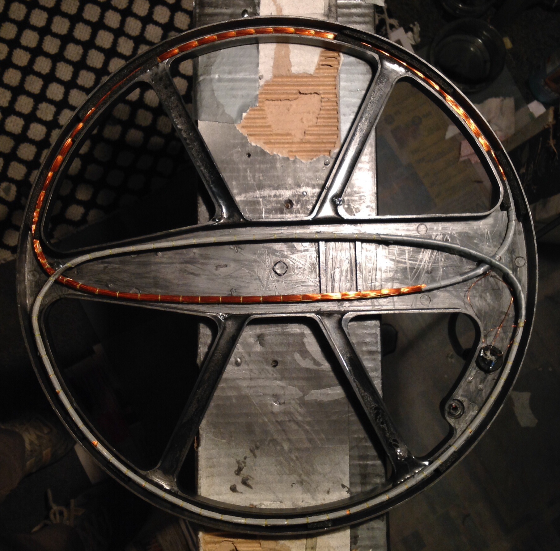

    If some one ever should start a 15" Deus coil project, I've got the it now..
    TX - 10.2 mH / 19 ohm and resonans with a 15nf= 12.7 khz. One turn is 92.5 cm - 115 turns with AWG 0.35 mm wire.
    RX - 15.9 mH / 48 ohm and resonans with a 15nf= 10.2 khz. Ond turn is 92.5 cm - 140 turns with SWG 0.25 mm wire.

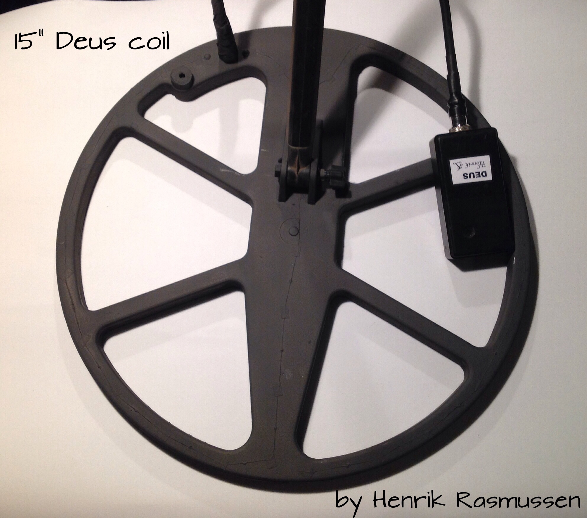

    Coil ready to the first outdoor test...
    Hi all.
    My 15" coil project just got the outside shielding and before any more will Be done, I need to test it at my testbed outside. Same shielding like my DB 7" coil and my DB 5.5x7" eliptical coil; shielding with low resistance of graphite spray. At the lab everything seem to work nicely.. Airtest depth allso good.
    The weight until now 875 gram.. Not bad with this Big coil.
    It will Properly not Be easy to find a field with allmust no iron, were this Big coil could Be usefull (If it will work), but it gave me some more exsperience to make coils and I needed that.
    Henrik.

                      This way here I got the coil to work... First make the TX perfect by getting the resonans - see scope and get high amplitude like the Stock coil at all 11 khz and 17 khz, close to the Inductance the Stock coil got. Using a capacity 15 nf and getting the same resonans like the Stock coil, that was 10.2 khz at this 15" coil. Found out the my meter only was a guidens. After the TX is ready and in the Shell, then work with RX.
                      First step is to Wind the RX a little higher than the 15.9 mH the Stock coil got, ( lower resonans that the Stock coil) with some 2 + 1 turns extra to finetune
                      Then work with the sharpe and the turns in the Shell, finding a good Null at 11 khz and 17 khz, testing the ID's all the way from low to high ID's and its ready. I got a good feeling what to do If some is off.. This 15" coil I got fast to work.
                      All 3 coils I made is Very close to the Stock coil Inductance and resonans...

                      The problem all the time is shielding..... Allso with this 15" coil. I got a Very low resistance now -100-300 ohm, but still some chattering.
                      now I gone a paint it with some lak, to get the graphite isolated to the touch like grass or ground. Hope that will work.
                      I made a air test before the shielding was made, so I can say how much lose I got, when its finish.
                      A Very good idea how to paint the graphite in a thin lay, is the next work I need to find out. This brush painting is a mess, it not easy to make nice, it not easy to get the same lay all over.. I hate this job. Spray is perfect, but to expensive.

                              Yes Qiaozhi - this is an exsperiment. At my 7" coil I first made some Sheilding inside, but had to paint much outside allso. That coil ended perfect (in my newbie World) - same was done with my little eliptical coil... Out and inside. I let the drain wire come out by a small 1mm hole and back inside again.
                              This 15" coil I've only got graphite outside... (And drain wires only outside) It was my plan to learn what different shielding will do, Thats why only outside. Its impossible to work with shielding inside, when the coil is closed and that was nesasary with this Big coil, it was to sensitive without filled up with resin. I got a lot of foam to lower the weight.
                              Did you follow our work with the Deus Stock coil... XP had allso made some kind of a shielding outside!
                              Outside shielding isn't to recommend at all.. Its Very difficult to make it solid and touch will make false signals.. If I got something right in this World.
