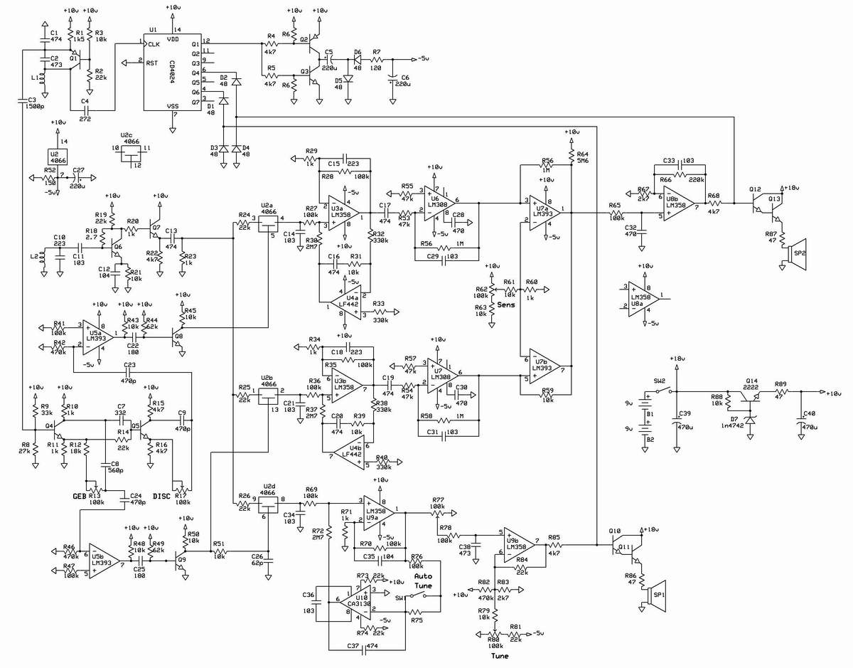

    And I've attached some schematics someone else was kind enough to post (unfortunately I can't remember the link so I'll just post them again)
    Aziz does low noise preamp on transistors while Nautilus had the preamp many years ago. at bottom I copy a message in russian from wert9 alias, sorry if in russian, pics which you give the link.
    so I hope russian collegies will read the message and maybe help by anything.
    На геотече вы просили схемку для наутилуса, там вроде как кто-то выложил, не могли бы вы архивчеком заделится, я с геотеча пароль потерял и терь не могу восстановить, а срочно нужно оживить катушку от Наутилуса, там на схеме вроде был нарисован блок встроенный в катушку. Он там сложный оказался, 2 транзистора 4 емкости и покрайней мере 3 резистора, так вот проблема терь с номиналом емкостей, никак маркеровку понять не могу((((((((
    На схеме не указаны транзисторы, они 2n5088. Схема на наутилус без ручной балансировки катушки, у меня с ручной, так что номиналы резюков и кандеров отличаются.

      The Nautilus is no longer manufactured? I thought I just saw the DMCIIB for sale at Kellyco.
        That looks like the schematic for the DMCII as I the DMCIIB has null adjuctments (R &C) in the box.
        I think Troy Gallow told me once that the preamp is in the coil housing. Also, I do have a schematic of the search head
        but not sure if it's for a IIB. 2N2222's for the preamp??
        Don.
        2N5088. Don look pls the pics at link NM gave above. there are the coil board pics, layout.
          Sorry! Disregard my last reply. I saw the second schematic..

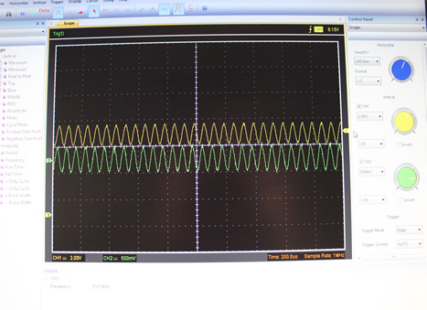

            By the way any idea what signals should look like on a properly nulled concentric coil? Is the RX supposed to be close to zero or is it supposed to look similar to the TX? I have found pictures of nulling D coils but no concentric. Does it look like the screen on the attachment below or the one on this link http://www.geotech1.com/pages/metdet...ti1500_150.pdf (not sure of what type of coil is on this unit though)?
            The picture attachment is from http://www.aspeluut.nl/tgsl.php- great site. I know one is the TGSL and the other is a more standard layout. Not the same thing quite as mine so I'm not sure. Any help would be greatly appreciated on that. I know which wire in the coil I have to move and pretty much everything else so all set once I figure this out.
